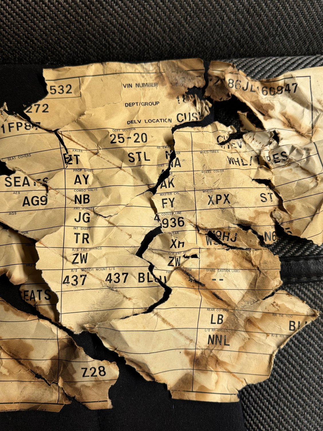

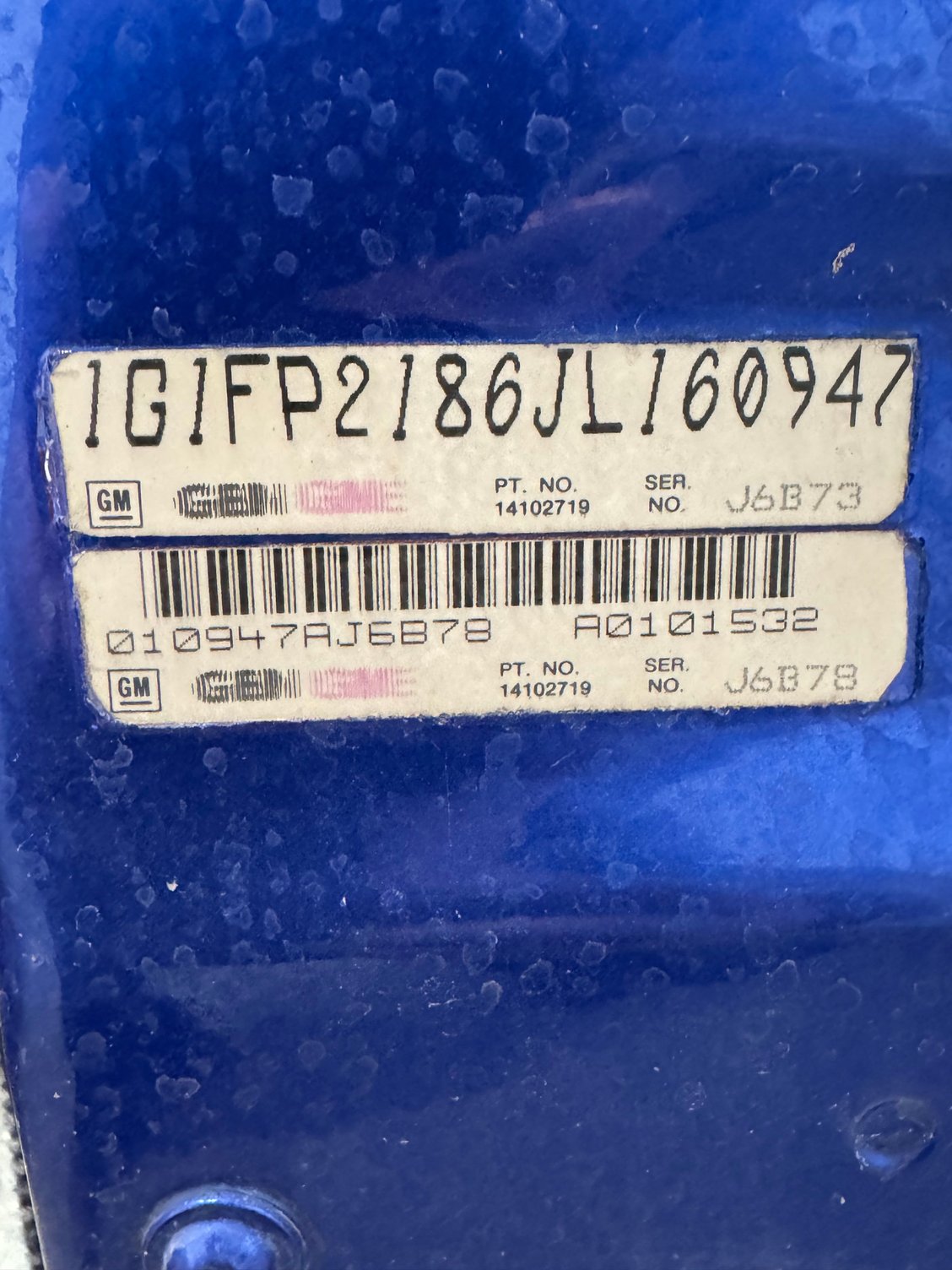

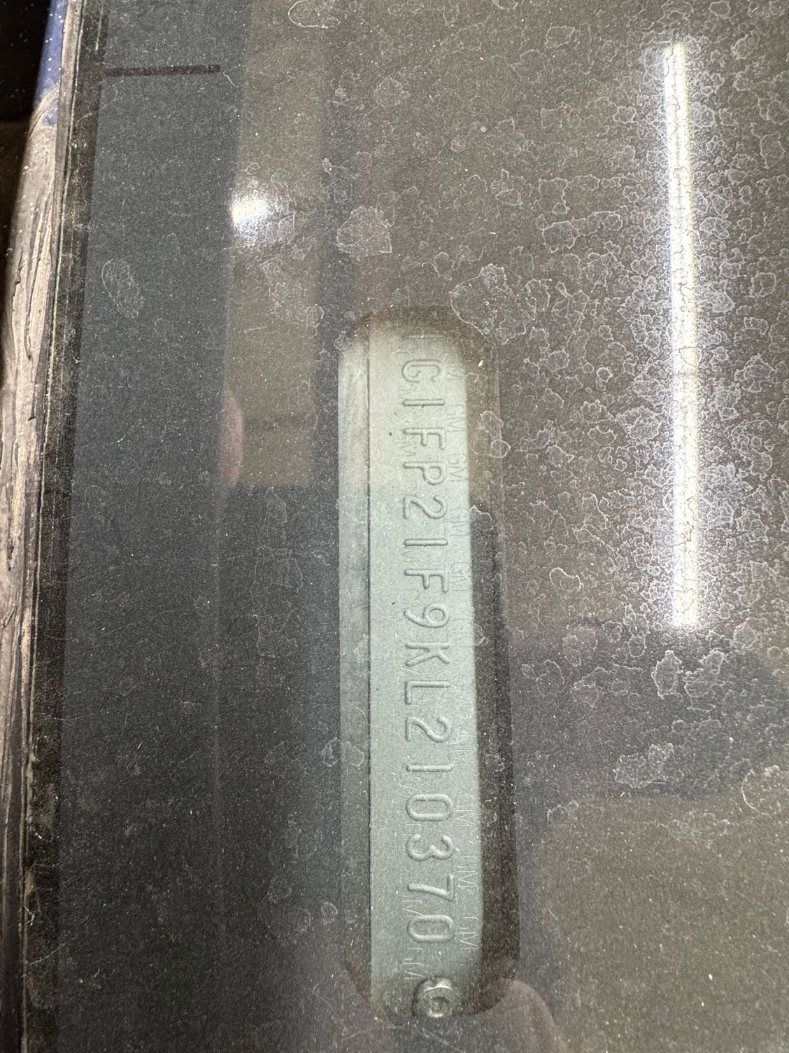

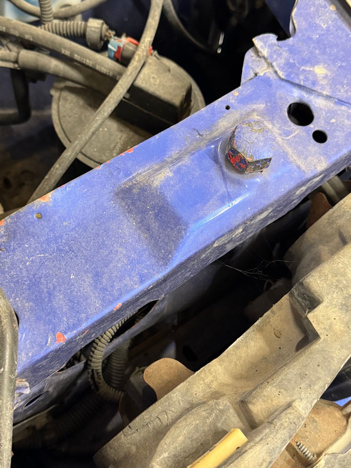

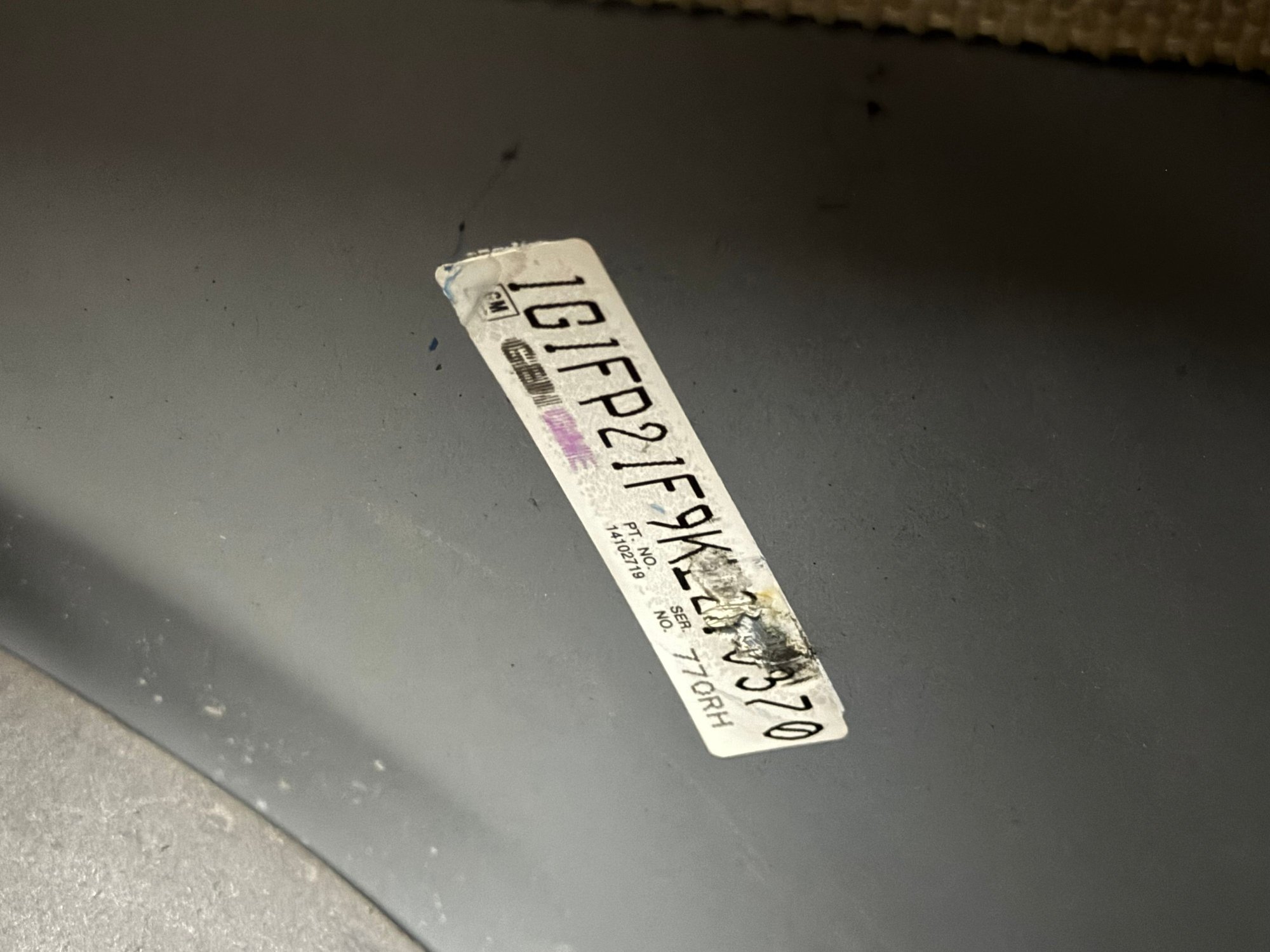

For example, the car was repainted because the previous owner liked the grand sport Corvette admiral, blue metallic color. It also has the 91-92 ground effects. I want to repaint it with the correct color and I will be replacing the ground effects back to the correct 89 year parts. Unfortunately both the man and his wife I bought it from in 1998 are deceased now so I don’t have a good source for what the original color was on this car. The parts ID sticker on the armrest console is gone. I think this car was wrecked along time ago. It wasn’t totaled, but I can tell both front fenders, the hood, front clip and both doors were taken from a different car that was red and the VIN on the doors do not match the VIN on the dash or the VIN in the rear wheel well fender. I also think the front seats were taken out of the donor car also because after doing some digging I found the tattered pieces of paper and the VIN matches the doors.

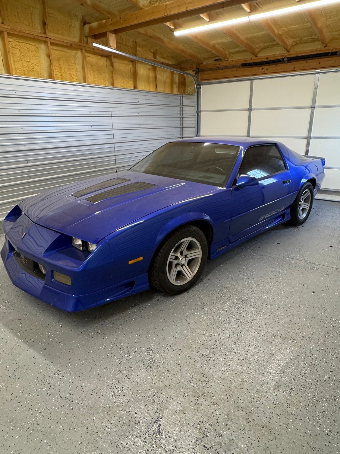

Here are some photos of the car and the different parts that are throwing me for a loop. First is the car itself and the VINs that I feel are correct with the car.

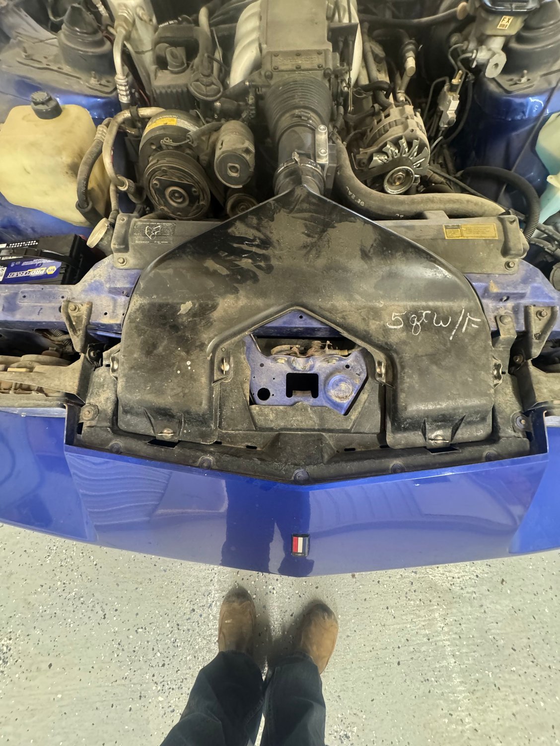

Second are the bits of red on the front clip, front fenders, doors and the “other” vin.

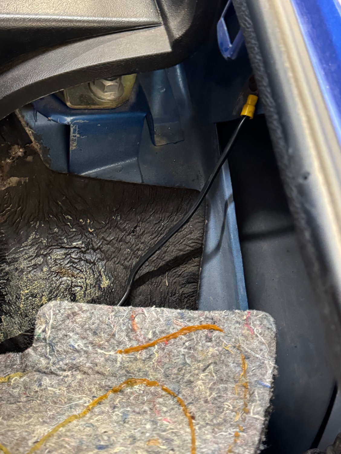

my best guess is the cars original paint color is Bright Blue Metallic due to a slightly lighter blue overspray in the inside of rear fender, under the carpet and also by the rear speakers.
What are your thoughts? Any help is appreciated.

Re: Restoring my old high school car- 89 Iroc z G92 5 speed
I'd agree that the OEM color was 98 / 9591 Bright Blue
The only other blue in 1989 was much lighter and not an Iroc color IMO.
Swap the grill for a "camaro grill", repaint 9591, and find a car for the GFX and it will look 5 times more original if going back to that look.
The 85-90 GFX (Iroc and Z28) should all match up. I didn't realize there were slight differences in the screw holes on the top part (under the door) on certain years until i had to replace one of my 86 Rockers GFX
Thanks for the reply!!
Yes my goal is to repaint the car the correct color from 1989, replace the ground effects and the Camaro front grill, paint the black headlight pockets back on.
the car is in great condition and so is the interior. I won’t have to touch the interior.
Couple other questions. Do all Iroc zs in 89 have the bottom stripes around the car? Do the 5.0L cars have a “tuned port injection” sticker under Iroc Z behind the front wheel? The 350s had 5.7 tuned port injection correct?
The stripes and IROC-Z on the doors could be deleted. RPO DX3.
TUNED PORT INJECTION decals would be below the fender emblems.
If you took your VIN to a dealer, they may be able to provide more info on the original colour, not sure how far back their records go. If the car was purchased in Canada, this would be a piece of cake.

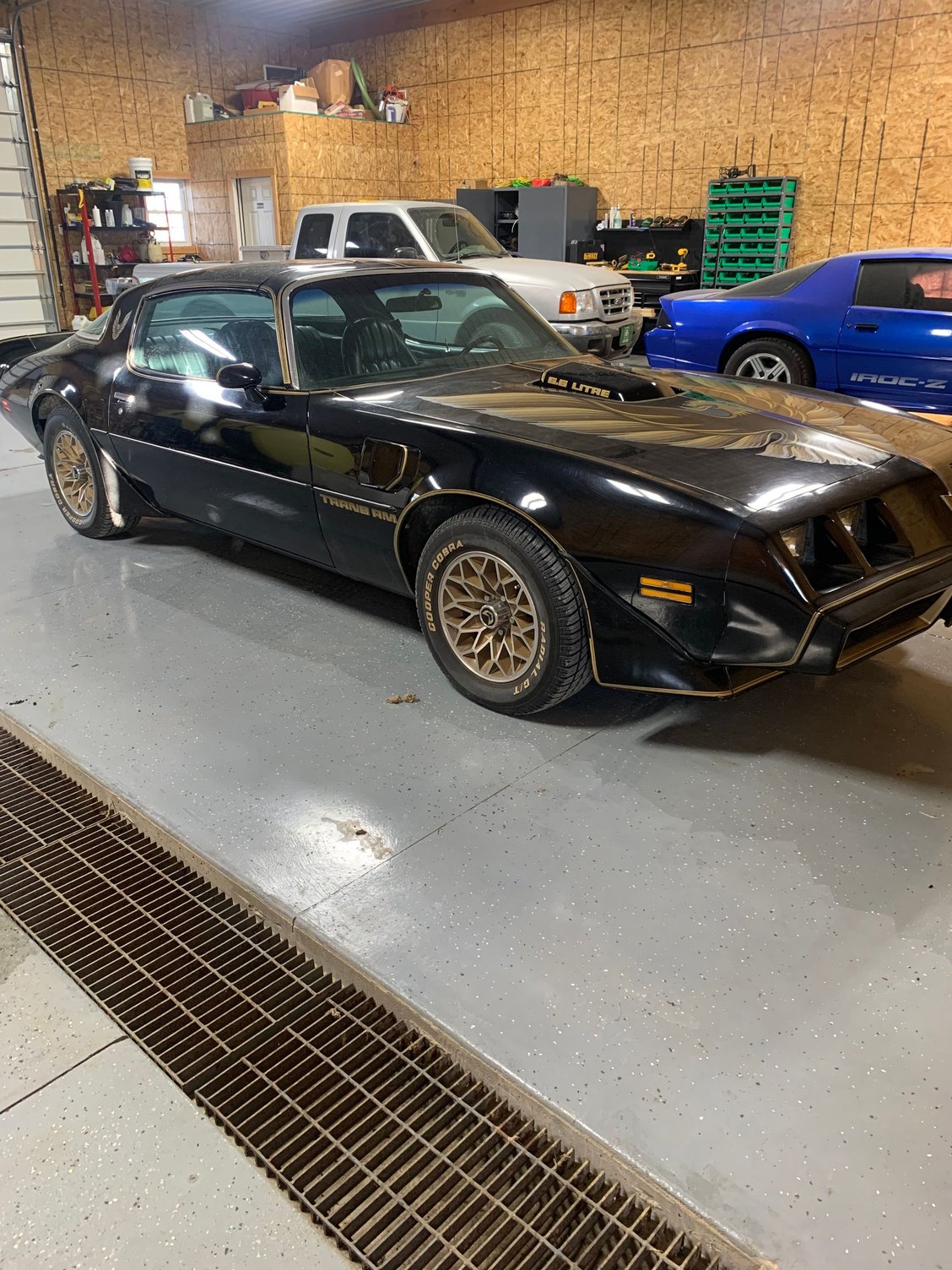

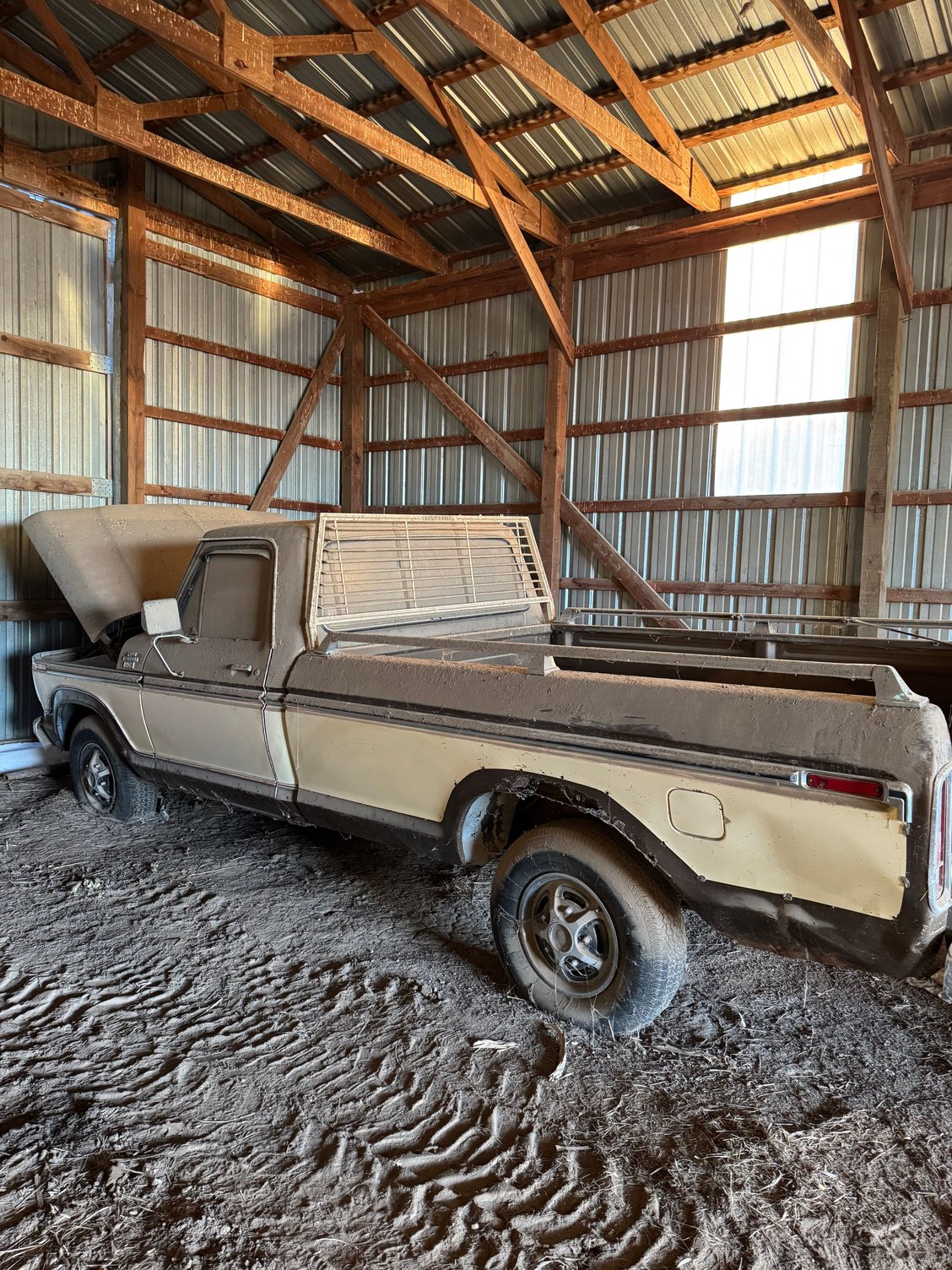

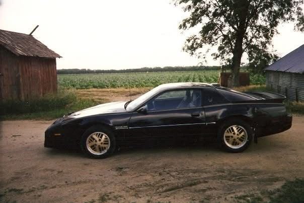

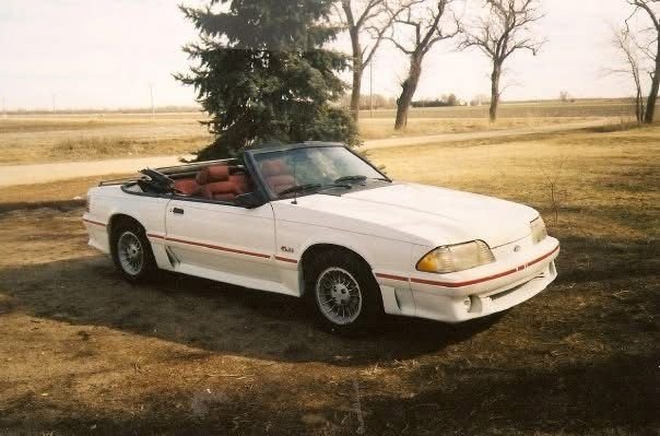

Just thought I’d show you guys the cars I’ve had in my lifetime. Wish I still had them all. The only one I have left is my 89 Iroc Z. It should be an “easier” restoration. I am also working on restoring my late father’s 1979 Ford F150 Ranger Lariat pickup. That one is gonna be harder and a cost a lot more!!!!
1986 Trans Am Recaro Edition. 5.0L carbureted “G” motor??
1987 Ford 5.0
1987 Ford 5.0
1979 Trans Am.  56,000 miles.
1979 Ford F150 Ranger Lariat. 2wd. 400M, auto.

The 1986 TA HO was nice. That was the last year for that motor in 3rdgens, and so few were produced that it was already considered extinct. That's one to find and get back someday.

thata great info on the oil! I’ll try that. Thank you!
im wrong on the G code motor. What is the other non HO 305 motor? That’s what it had. So not so rare besides the recaro seats.

Maybe "H"
