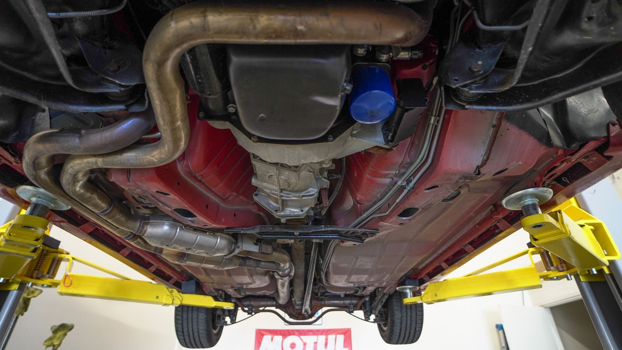

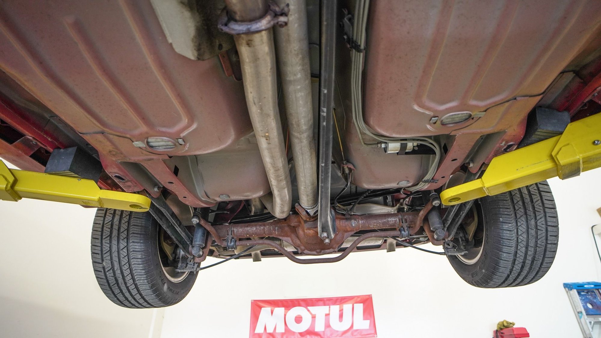

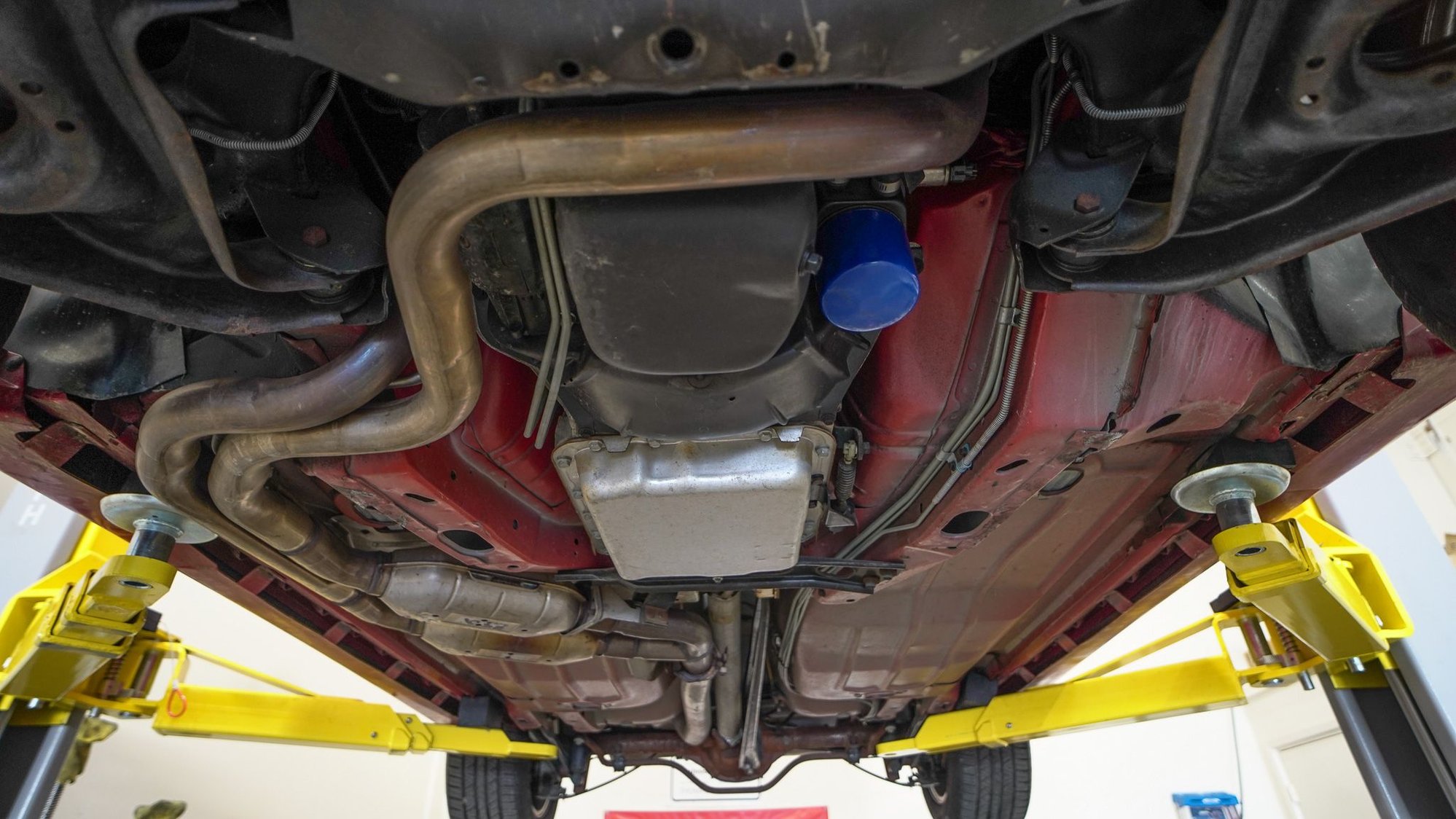

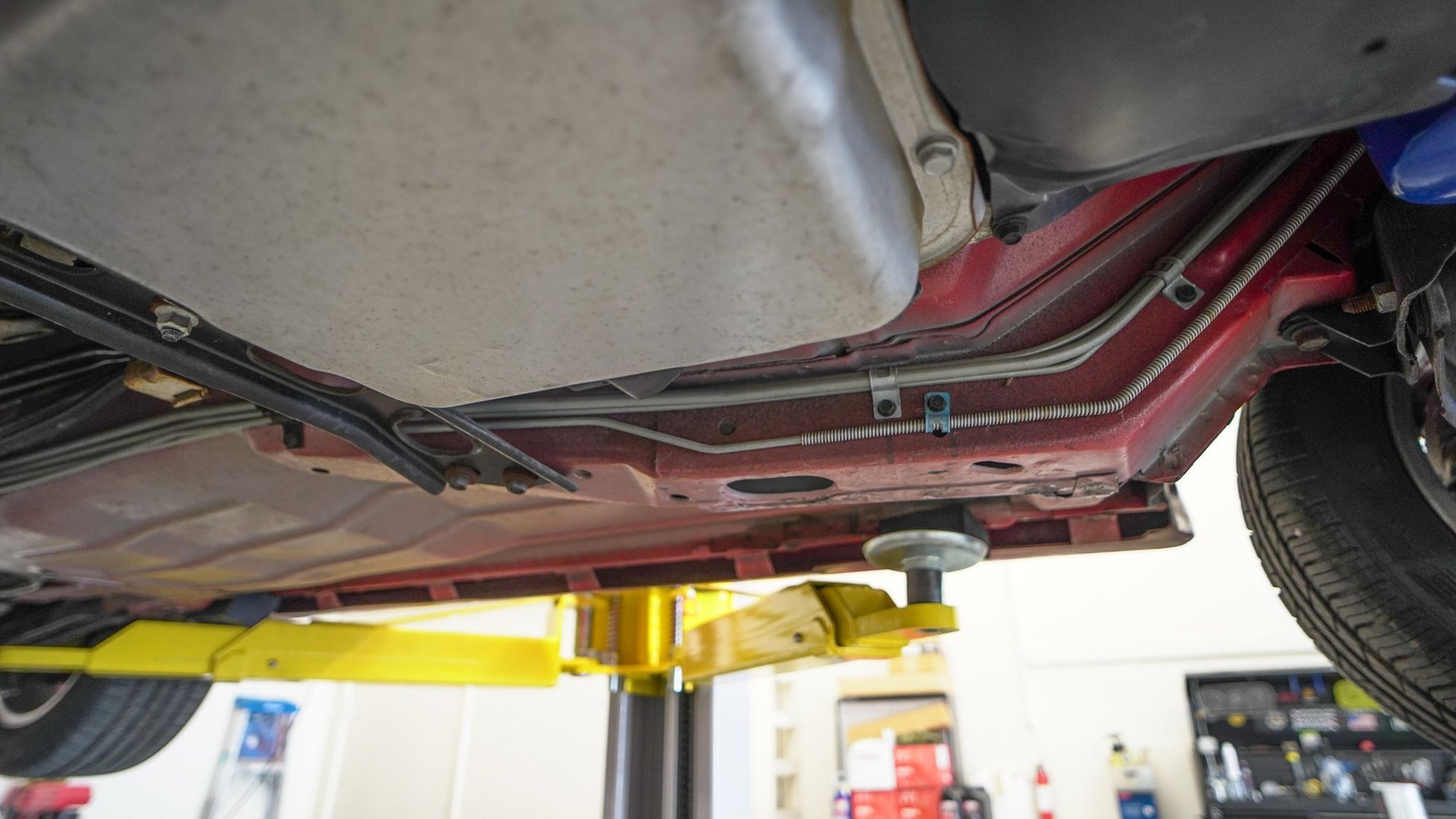

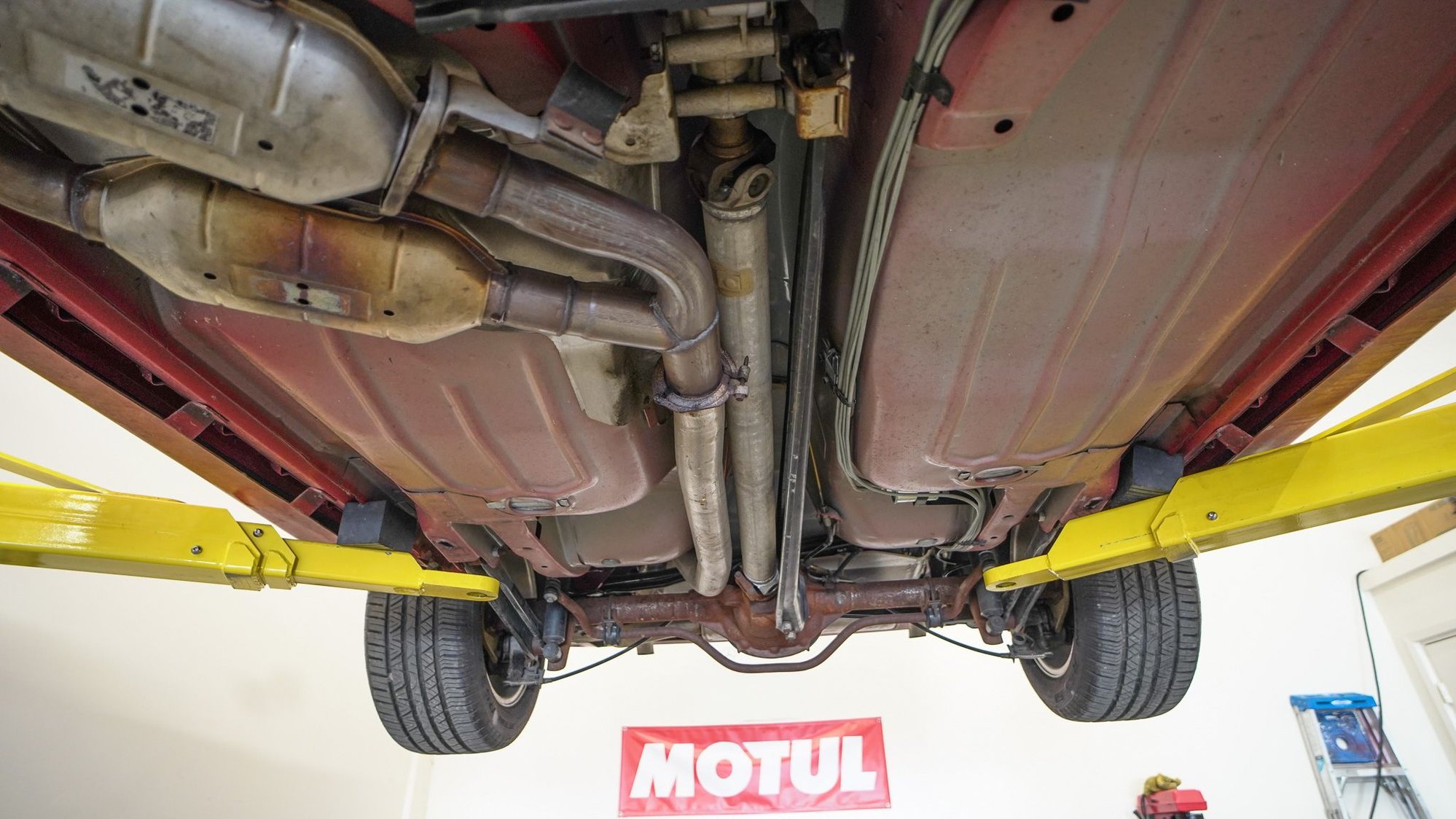

Both of the auctions for these two 1LE Z28s are a textbook example of how not to put a 3rd gen on a two-post lift.
Smashed pinch welds for sure if you lift or jack up a 3rd gen where these guys are doing it at on the body.
Having the rear of the front fenders bowed out not matching the body lines of the front edges of the doors is not a pretty site on any 3rd gen much less extremely low mile examples like these two cars are. I can only hope that they got lucky doing it this way this time.

I didn't view the links to see how poorly they chose the lift points, but from what I remember when the cars were newer, it was extremely common for the passenger fender to be kicked out farther than the door. Even on cars without tweaked pinch welds.

I also remember the front and rear bumper cover paint not matching very well and the gap between the hatch and quarter panel being much larger on the passenger side than the driver side.
There are only 4 correct points to lift these cars from on a 2-post lift, and they managed to not find even 1 of them.
