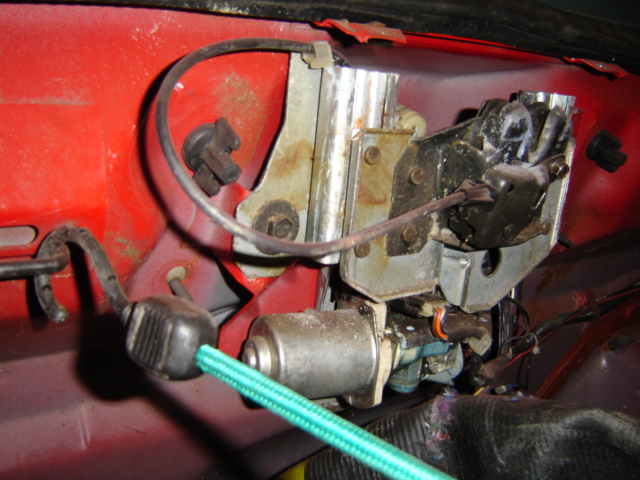

A pic like this with the pull down mount would be helpful. I don't see any mounting holes?

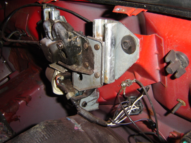

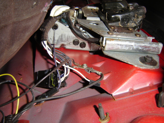

yea you've been robbed of the mounting bracket...your going to need to go to a junk yard with tools and a power drill and drill out the spot welds of a bracket and re-weld it to your car...as far as measurements i can try and help you out but it's not going to be fun...here are the pics you asked for...this is from a bird...but they may be identical bird to maro...but either way you will get the idea.

Thanks for the reply and the pics... =\
Not really what I wanted to see. =)
