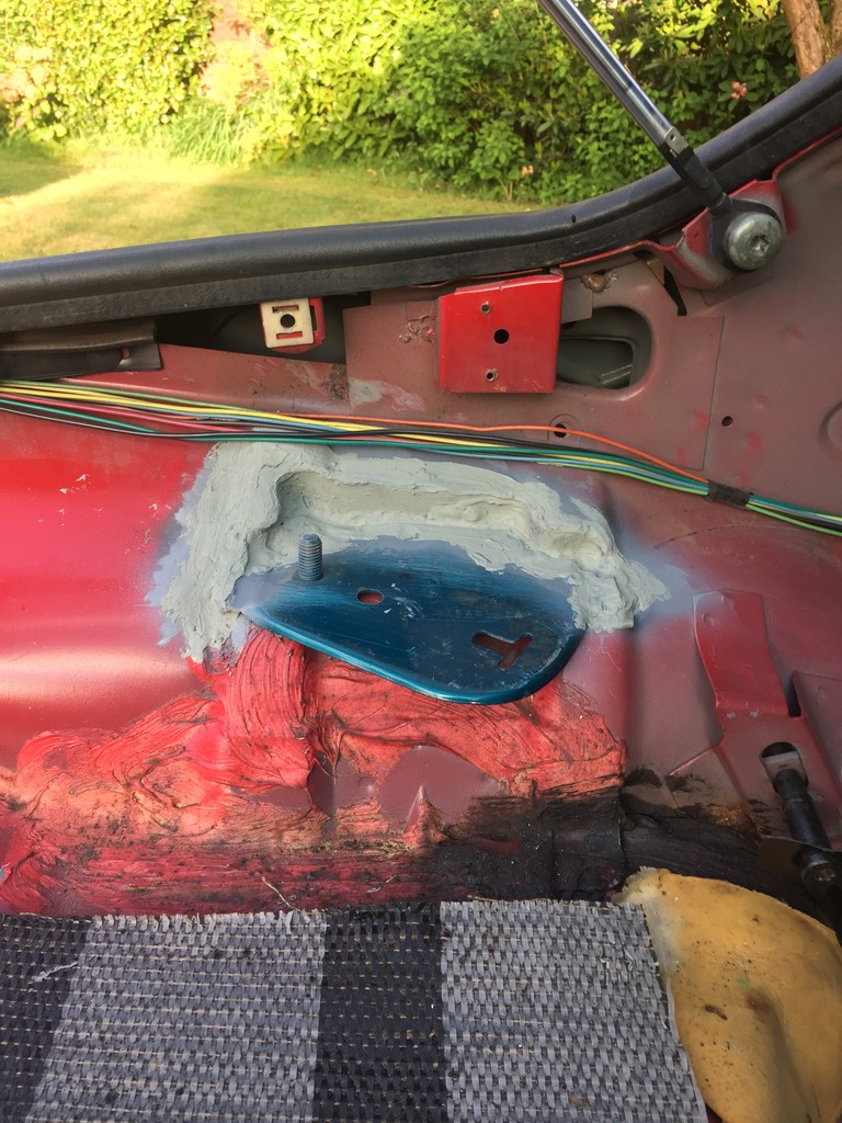

Thanks for this thread, I also managed to acquire all the parts needed so thought it made sense to do this.
My drivers side seemed impossible to fit and it wouldn't fit anything like yours did.
In the end though I have it fitted but had to spend out on 4 hours at a body shop to get them to cut out a section and weld in a drop of an inch or so to get the bracket to fit. Not a big job if you can weld but also not that expensive and looks a lot better.
Pics below of square on so you can see the exact positioning.
