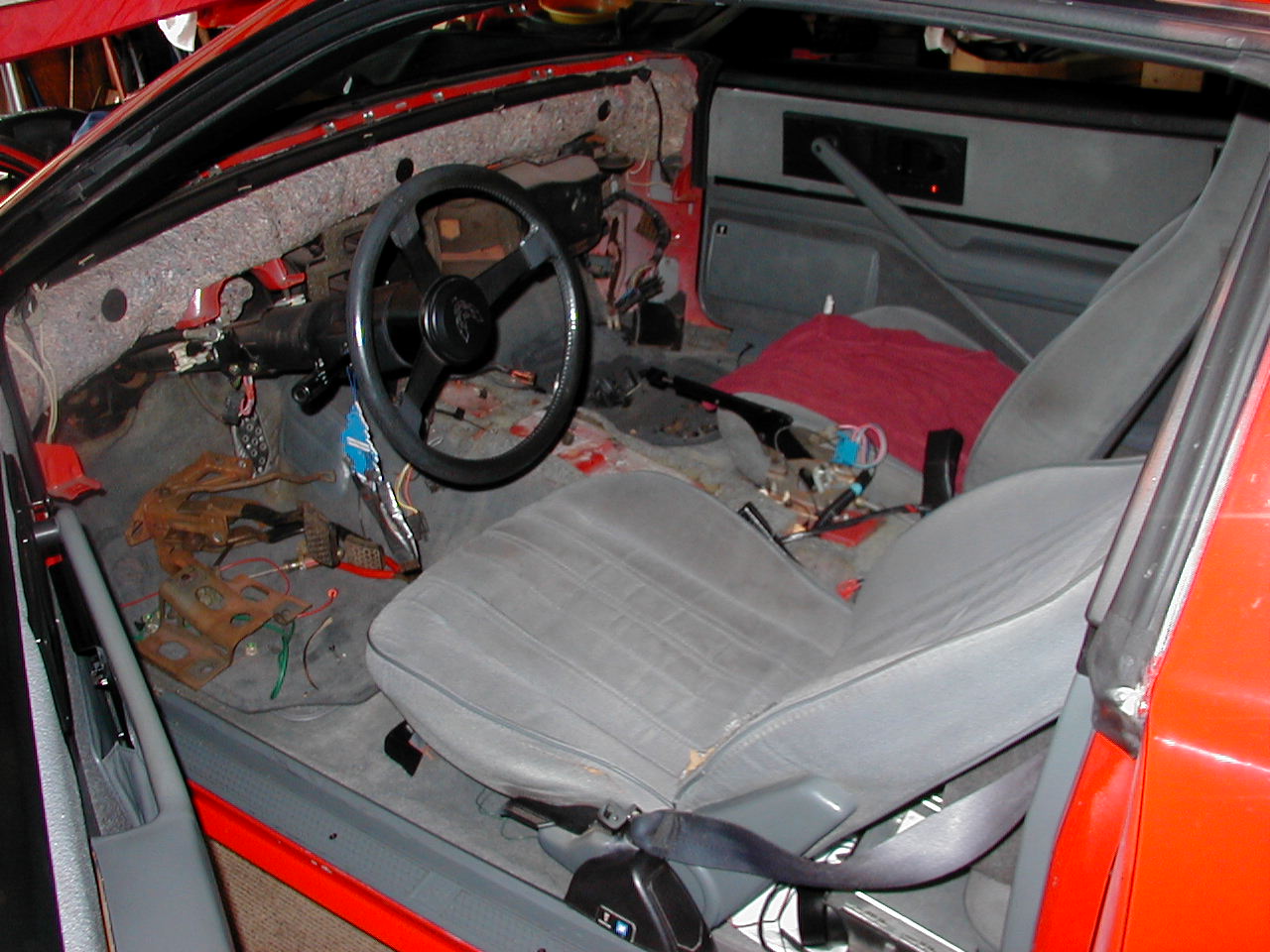

Well thanks a lot guys got it and the entire dash but I don't think I did it right :-( I don't know if it can be fixed! someone help!

I guess that's one way to remove the cluster .

Remove the dash speakers from the firewall & Re-install them back onto the dash housing.
Remove the Air Vent box at the tranny Hump and place it out of the way.
Remove the long metal brace that runs all the way across and re-install it back onto the dash housing.
It looks like you left all the wiring on the car after removing the dash housing - if that's true; remove the dash wiring harness from the car and re-install it back onto the dash housing. Yes - disconnect it from everywhere and re-install it on the housing !!
I'm not sure you will ever get a dash housing to fit back onto that car unless you rebuild it first. When I replace a dash housing it gets serviced as a complete unit - when it gets installed I hold it up, put the 6 7mm screws along the top edge,... then then 1 10mm screw on each bottom edge- DONE. After it's hung you re-install the vent at the tranny hump and start re-connecting the wires.
Yuor firewall should look more like this:
