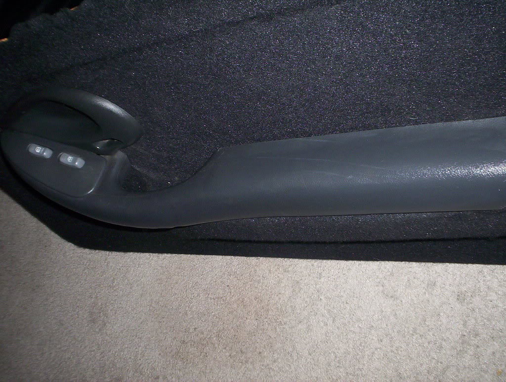

Started with this idea:
There is no good way to make the lower part work it just doesn't flow all that well so I ditched that part.
Basicly you glass in this area so you can make it smooth for the material , I bonded the 4thgen backboard handle area and then glassed over it , then sand sand and sand some more.

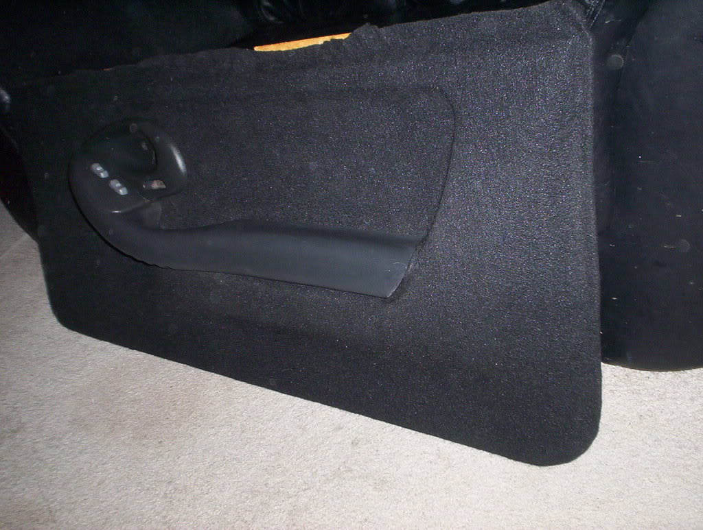

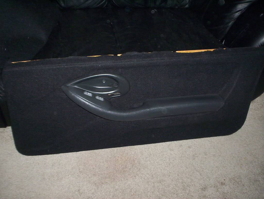

Glassing/test

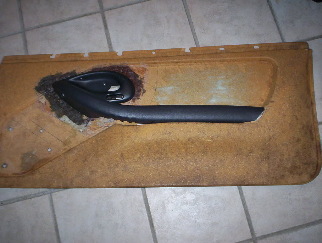

Any "in progress" pics by chance?
Old Jan 11, 2009 | 02:00 PM
The_Wraith's Avatar
Posts: 1,122
Car: 1984 Trans Am 15th anniversary
Engine: L69
Transmission: 700r
Axle/Gears: 3:73
Re: An alternative to the poor fitting 4thgen door panels
Added
and another closeup
