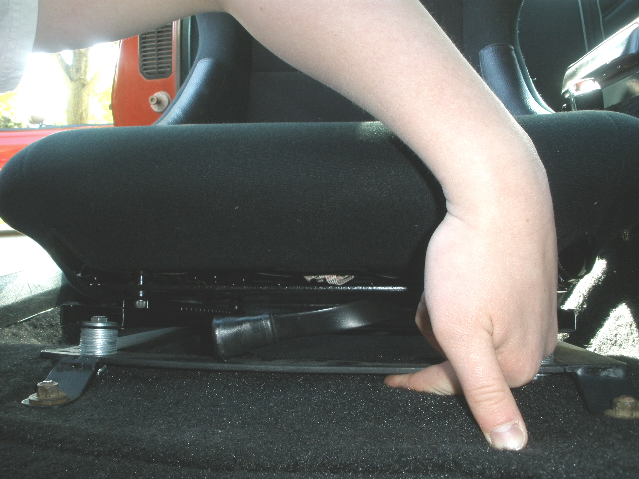

Here are the mounting brackets I had to modify for my Corbeau seats.
Just finished Putting in Racing Seats!-passenger-seat-bottom.jpg Just finished Putting in Racing Seats!-passenger-seat-bottom1.jpg Just finished Putting in Racing Seats!-passenger-seat-bottom2.jpg
Old May 29, 2009 | 07:26 PM
racing geek's Avatar
Joined: Aug 2007
Posts: 1,525
From: Milwaukee, Wisconsin
Car: 1987 IROC-Z
Engine: 383 with Edelbrock ProFlow EFI
Transmission: TH350
Axle/Gears: 12 bolt 3.73 Eaton posi
Re: Just finished Putting in Racing Seats!

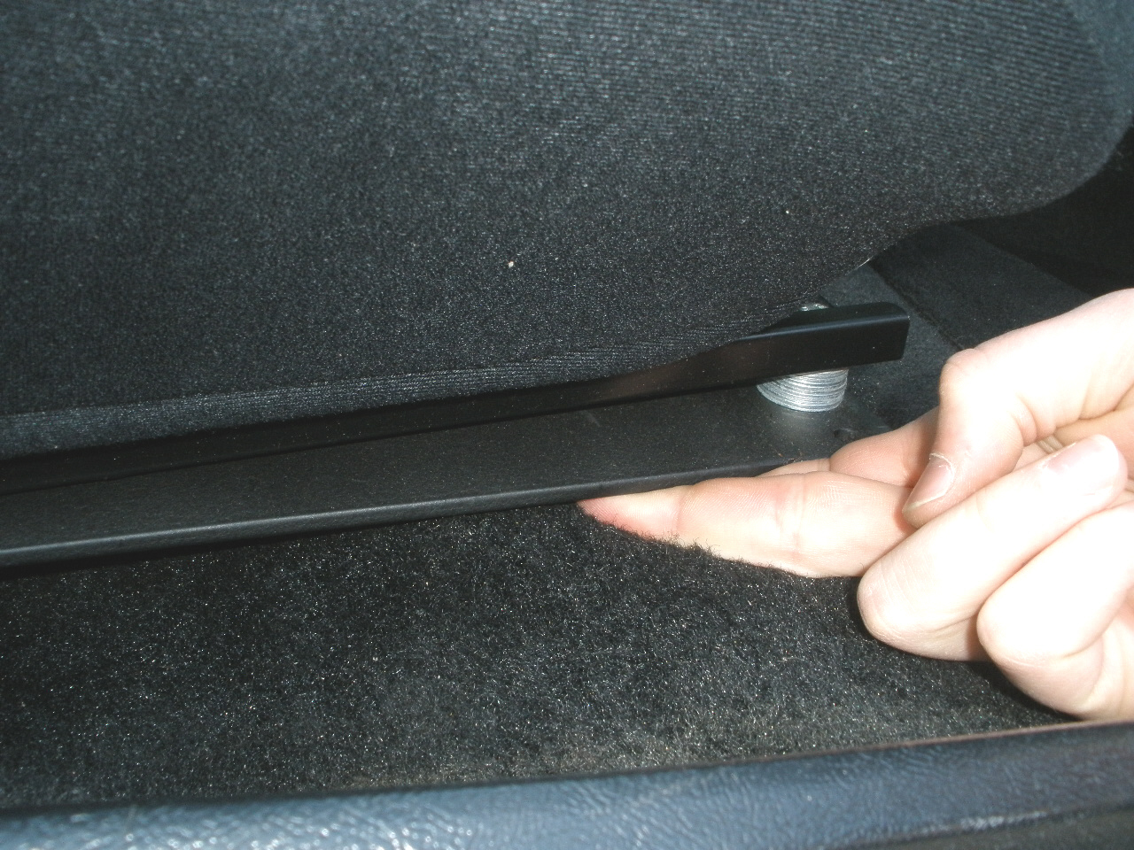

Here are some pictures to give you an idea how low I had to mount them. I can just barely wedge my fingers under the seat mounts in these spots.
Just finished Putting in Racing Seats!-clearance-between-mount-floor Just finished Putting in Racing Seats!-clearance-between-mount-floor Just finished Putting in Racing Seats!-passenger-seat-side.jpg
I would have made it lower, but then it would be really difficult to get the rear nuts on to hold the back of the seat down and it wouldn't clear the taller part that can be seen in the side picture (picture #3).

Here are some pictures showing the height of the seat mounts form the front and back. In front, I added 3/4" of washers to get the needed angle so I fit (barely) with my helmet on. I do plan on getting a solid spacer machined one of these days.
Just finished Putting in Racing Seats!-passenger-seat-front-height.jpg Just finished Putting in Racing Seats!-height-back2.jpg
Attachment 178985 Attachment 178986 Attachment 178987

Originally Posted by omnipotentgoku
Is $300 a good price for these type of seats ? I want to get into some serious racing and the 4th gen seats provide no horizontal support at all.
I saw a black set of these seats in a Civic at work today. They were the all cloth models but the fabric looked really durable. There was also a lot more padding then what is in my Corbeau seats. Then again, the Corbeau Forza seats I have are more designed for actual racing... note the fixed back. On short trips my seats are just as good as any other, but when I drive for a couple hours, I have to keep adjusting my seating position in order to stay comfy.
What exactly do you mean by "serious racing?" For autocross the Spoon seats would be fine, but for road coarse racing and track days, I would think a fixed back would be better for lateral support and safer in the event of a crash just because you don't have to worry about all kinds of levers and gears and what not breaking. The material your seat is made of also makes a big difference in lateral support. Leather for example, is a much slipprier material then cloth which almost seems to grab you. You can test it yourself by siting in a leather seat and wiggling your butt and sliding your torso across the top of the seat. Then try it in a cloth or suede seat and you will move FAR less.
Originally Posted by HottestZ28
its good to see a racing seat with enough room for tall people.
Keep in mind though that my seats don't have all that much padding and that I had to extensively modify the seat mounts. Now that my little brother has seen the trouble I've had to go through to fit in my car with a helmet on, he is really hoping he will stop growing soon. He's already 6' and he's only going to be a freshmen in high school next year. It isn't looking good for him. lol
How hard was it for you to make your coustome seat brackets?
I used the original seat brackets that the original seats came with just choped them out and screw them in place of the new seat sliders.
Tony.
Tony.
I did both in an afternoon. I guess it depends on your to weld. If you aren't good and have to keep grinding off the welds and redoing them it will obviously take longer. Just make sure you follow the old saying of measure twice and cut once. It will save a lot of time.
You used screws?!? I wouldn't trust screws... grade 8 bolts or don't mess with anything. In the pm you sent me, you asked for some about the steps I took to make them... what exactly are you asking about? I pretty much just winged it and that's how they turned out. I do plan on making new mounts so I can completely get rid of the spacers... the more I look at that the more I don't like it.
