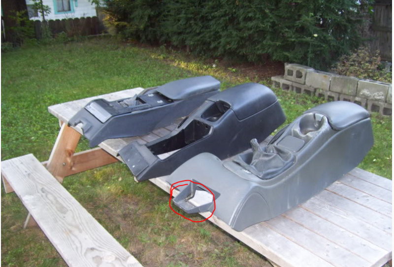

I have no idea what you are referring too, but what I am talking about doesn't involve the shift boot. Let me edit a picture real quick.

Engine: 5.0L-V8
Axle/Gears: 3.23 - Posi -10 Bolt
Re: Third Gen Firebird Console Swap Info
Old Oct 19, 2014 | 05:50 PM
  #61
padak's Avatar
iTrader: (10)
Joined: May 2013
Posts: 378
From: Aliquippa, PA
Car: '87 Trans Am
Engine: 5.0L-V8
Like I said, if you cut the piece off I circled in red, it will allow you to push the console up around 2 more inches.

I don't have that piece. I'm tight up against the radio pod.

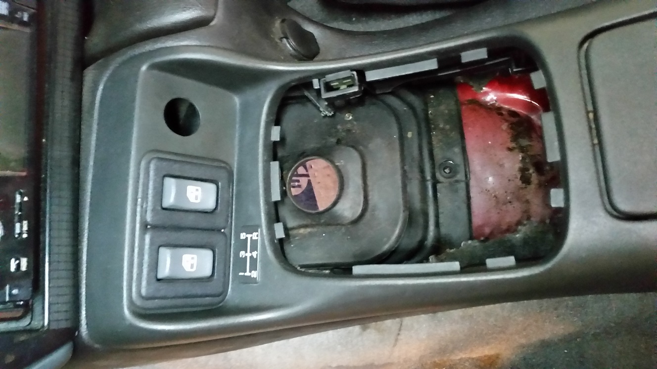

It all works out...
The fourth gen console fit perfect around the cut out in the tunnel.
I have a finger or two in the front to spare! I didn't take the time to look at the donor car with the third gen console but I suspect it's about the same.

MUCH better!!
