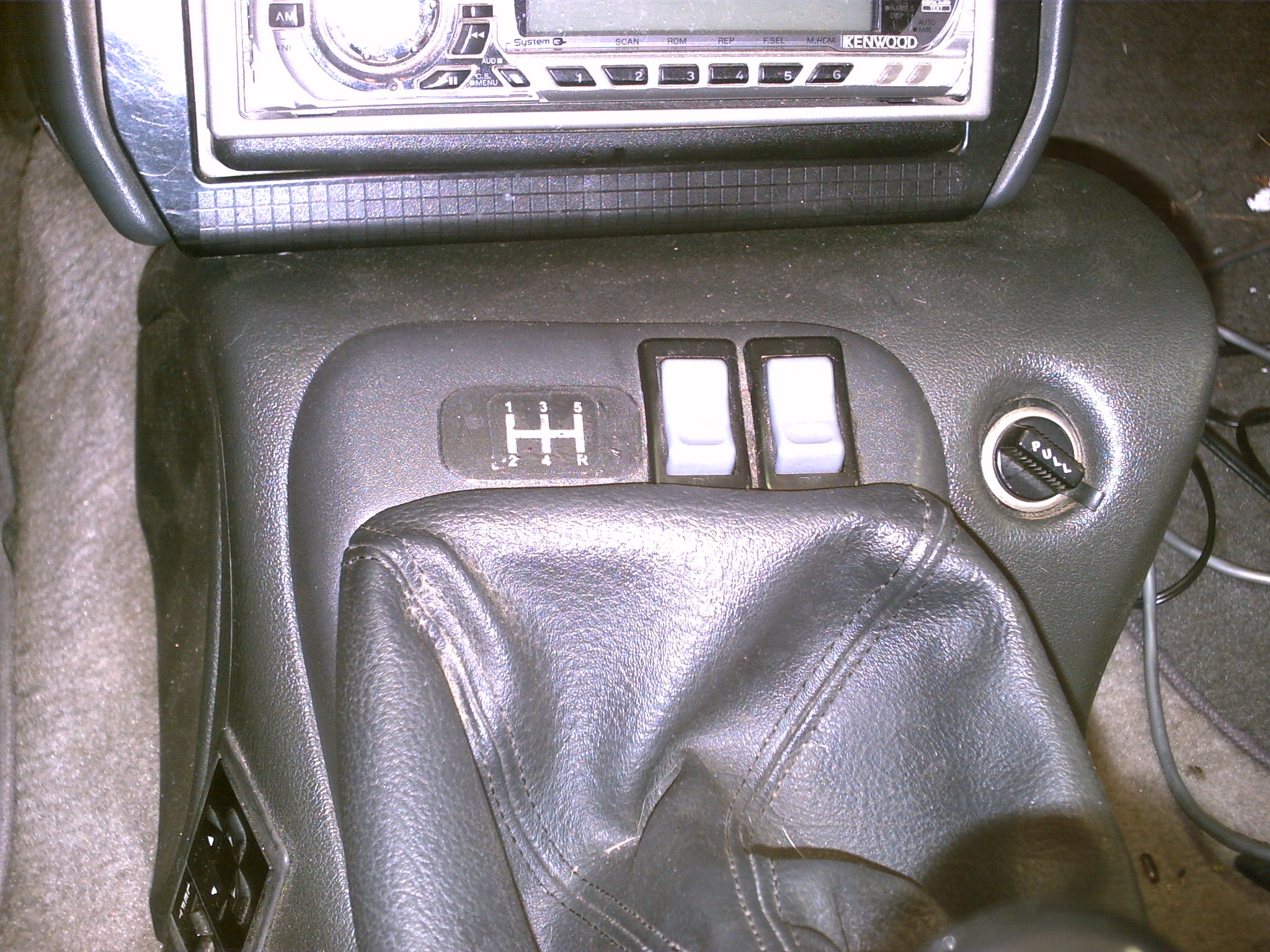

actually the thirdgen camaro console will fit with the slightest trim job to the top. i know this because i have one in my 88 t/a
Attached Thumbnails Third Gen Firebird Console Swap Info-2009_0828newerpics0102.jpg

How do you mount the power window switches into the fourth-gen bird console??
Old Jun 4, 2013 | 01:34 AM
86_irocz-28's Avatar
Joined: Aug 2010
Posts: 680
From: Lincoln, NE
Car: 86 Iroc-Z28
Engine: 5.3
Transmission: 4l60
Re: Third Gen Firebird Console Swap Info
ashtray

The new console CAN be an automatic, but that requires moving the shifter around to get it work right. With a manual only some trimming of the console is necessary.
You cannot reuse the 3rd gen shift plate. The auto has a shift plate, the manual is by feel.
It is a fairly straight forward install. Cut the little thingys in the front that stick out off, and use the 2 bolts in the compartment to bolt it down. done.

In the picture you posted is that a stick or auto and what type of console did you use?

It is a console out of a 2000 Firebird.
The trans in the car is an auto. But I used that shift **** (out of a camaro IIRC) to make people think at first glance it is a manual.

Thanx for the compliment. I am really pleased with how it turned out, and it is 100% reversible should I need to do that.

What kind of shift boot did you use is that an aftermarket one or did you use one from a manual firebird?

Its a new replacement. Not aftermarket.
