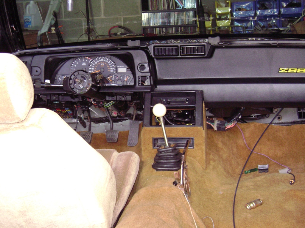

Re: 4th gen Gauges in a 3rd gen camaro?
I have done this it was not difficult.Just cut out a little of the dash behind the gauge cluster,make a filler piece,and trim to fit.
Attached Thumbnails 4th gen Gauges in a 3rd gen camaro?-pooters-pics-065.jpg   4th gen Gauges in a 3rd gen camaro?-pooters-pics-069.jpg   4th gen Gauges in a 3rd gen camaro?-pooters-pics-059.jpg

Old Dec 2, 2009 | 07:30 PM
91ls1t56's Avatar
Joined: Nov 2007
Posts: 402
Likes: 29
From: milwaukee
Car: 91 Z28
Axle/Gears: Moser 9" 3.70 35 spline wavetrack
one more pic
Old Dec 2, 2009 | 09:22 PM
mtflyboy's Avatar
Joined: Aug 2009
Posts: 140
From: Colorado Springs, CO and Billings, MT
Car: 1991 Z28
wow that looks really good... i like where the speedo and tach are compared to ours..

Originally Posted by 3rdGenLs
@Ramair21 can you give more information on how and what you used to fill in the gaps after installing the cluster.
All i did was test fit the cluster and cut till i was able to slide it back enough. Then i traced the 4th plastic gauge cover unto some ABS plastic sheet. Cut and fit. traced some unto plexiglass as well. Very simple.
