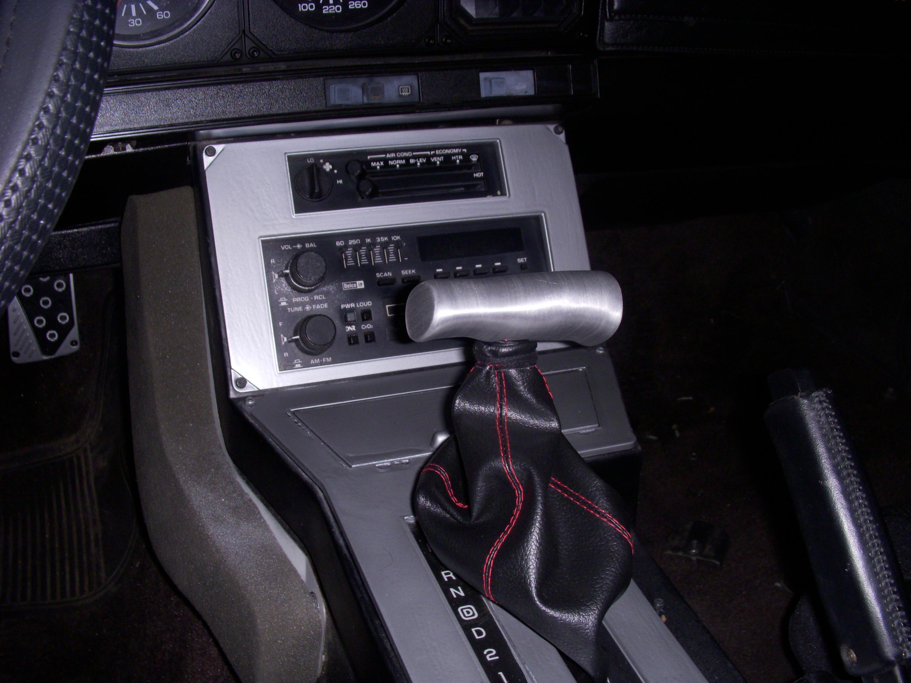

I have a scientific brain! jk.It just depends on who you ask, but here's how i did mine.I started by cutting the slider & surrounding plastic out.The cut out is the same length as the indicator window.The width is as wide as i could go, 1/4 from edges on each side of shifter.I cut 2 pieces of hanger wire long enough the run the edges of the boot opening.Bend both to the same dimensions as the boot opening, solder or weld the ends.Stitch the bottom of the boot around one of the hanger wires.Stitch the 2nd about an inch lower.The 2nd one keeps the boot from snagging on the shifter mechanism.the 2nd wire should be cut a little longer since it requires a bend at the front(see pic).This bend is so the shifter wont push the boot out of place when in "park".
The right side of the boot is held in place by the top of the console.When the
shifter bezel is re-installed.
Heres a back view.The left side required me cutting part of the indicator housing(white).Where it butts up against the boot.This is what holds the boot inplace, along with a little silicone.The pics dont really show this though.
As it looks today

Hey Rick,
Dude thanks for the pictures and the instructions thats the perfect way to explain everything.
Thanks. Tony.

Ok, strange question but how did you get where you cut out to look so straight. What did you use to cut it?

Good question.I used a ruler & an exacto knife to mark my line (from the underside)for the edges.I made the rough cut with a dremel too, to about 1/16 from the marked line.From there i used a course file & worked down to a finer file.I finshed it with some 600 grit sandpaper.
Be careful filing on the corners.Its easy to go too far.

I attached my boot similar to 84 1LE, except I used a staple gun and gorilla glue. Heres a pic of mine with the HURST handle. I push it down to shift.

I like the wy Rick did it. He cut more of the oppening so its a better and bigger cause on your mod you left it the way it came like with the slider and the boot looks like kinda over crowded and on Rick's it looks like the ones that came on the Trans Am. So I know when I start this mod im gonna go with the way that Rick did his.

my t handle is still there. i just wanted to cover it so it gave it that manual shifter look
I understand, have you seen my other thread with the pics?
https://www.thirdgen.org/forums/inte...automatic.html
Tony.
