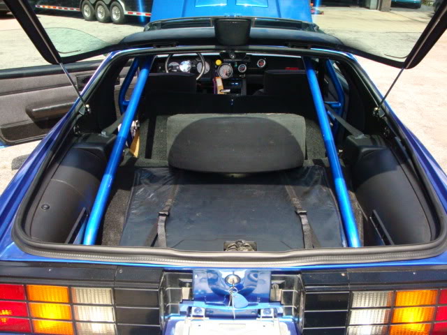

i bought the same kit and mine fit with the rear seats but you really cant use them unless your a kid lol i used 6points i didnt had the 2 cross bars to the floor behind the seats casue i welded my hoop to the frame connectors right thru the floor Name:  DSC00021.jpg
Size:  86.6 KB Name:  DSC00024.jpg
Size:  89.1 KB Name:  DSC00022.jpg

I'm planning on a similar thing. I'll weld the rest in the next two weekends but m hoop is a little outside the connectors. I'm connecting the rear bars to the frame rails for the 4 link. The two bars that run diagonal to the floor off the cross member and hoop I'll probably weld those to the connectors if i put them in. I'm putting a little bin where the rear seats were. I wanted someplace to put my stuff in. Right now the entire rear is gutted.So I might take out the gas tank and run a fuel cell. Not sure
