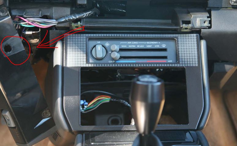

Originally Posted by zero-21xx
Thanks scooter
someone has the missing part?
Attachment 454386
I think they put that in for the light, like the earlier cars had, but it didn't actually come installed in the later cars with that dash. They put a small light in the rear view mirror to illuminate the console area
