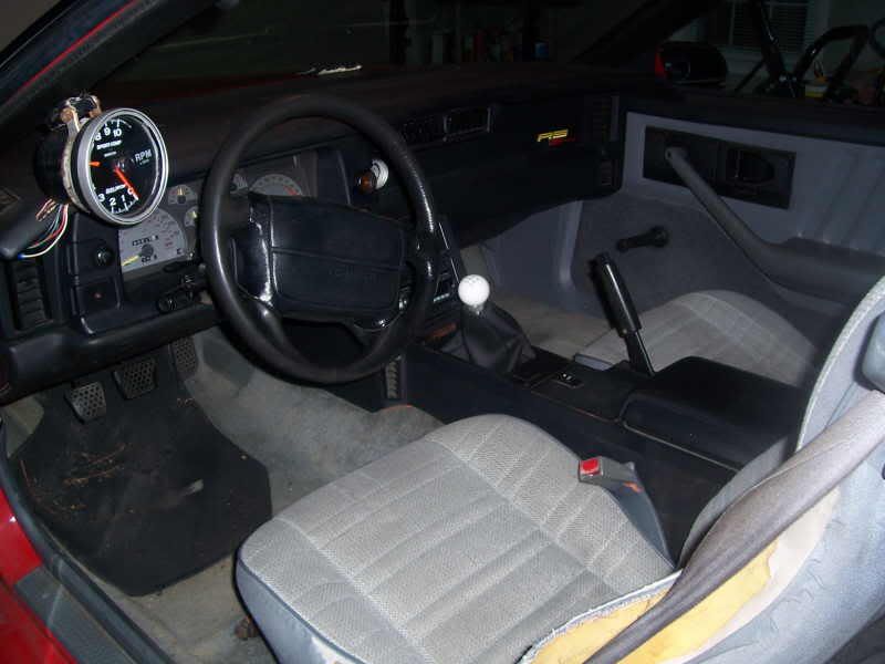

Originally Posted by LostNocturne
Alright, then has anyone had any success with those white face gauge covers masking the appearance of the yellow numbering? I really don't have the cash sitting around to purchase a white faced gauge cluster if I could even find one.
That's what mine look like. And dont worry I've got new seats and floormats and the interior looks much better now.
There's a slight yellow tint to them, but it looks a lot better.
Thanks so much for the picture! So you got the color change gauge faces from that one ebay store "white gauges"? I'm seeing about $50 for the gauges and the color change. I think those look better than the white gauges and definitely better than the yellow ones.
