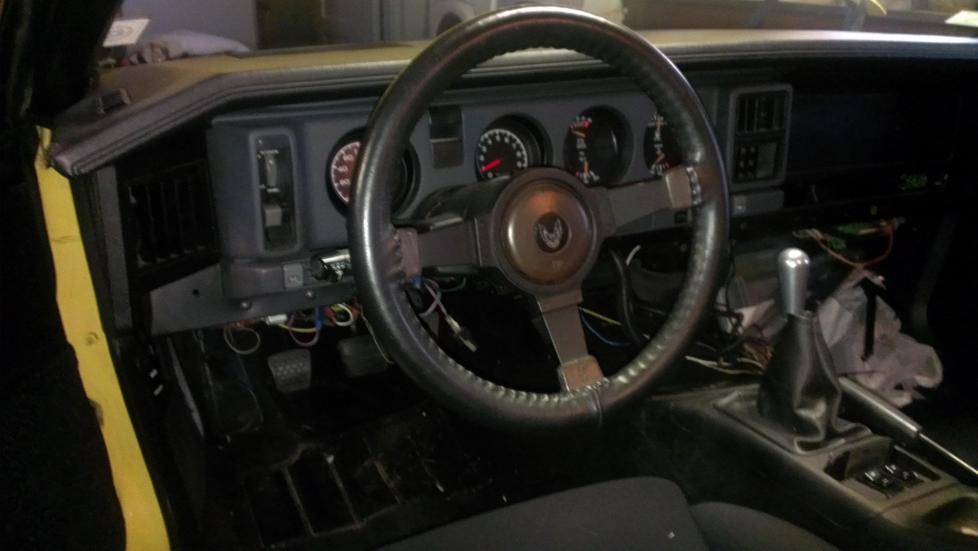

what are those buttons for on that first pic?
I was wondering the same thing. Do they just pop out and have bolts underneath them? I wanted to remove my panel but was afraid to breake them.

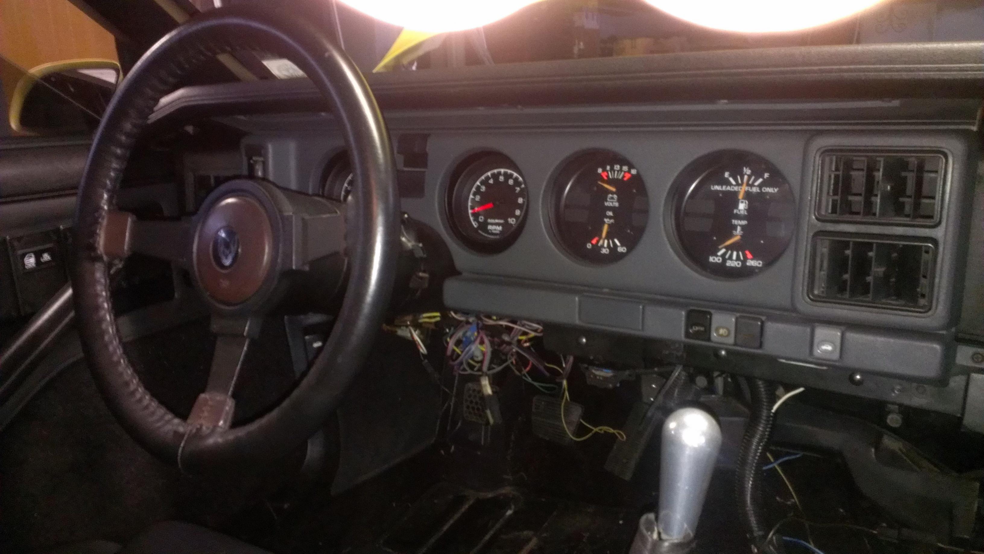

Can the dash structure from an 82-84 be used with all the stuff from 85-89?
I realize visually the components, cluster, trims, bezel are all different but I'm curious if the basic attachment points are the same.

You have to do a bit of cutting, but I think yes.
It is the switches on the bottom, that do not fit.
Also the bottom piece of the HVAC ducting is different. That is what I am missing at the moment. Put a bit more together since the pics, but still a ways to go. Mine is an '83. Was tired of, and bored with the orig stuff. Put in a 94 Z28 center console. Different.
