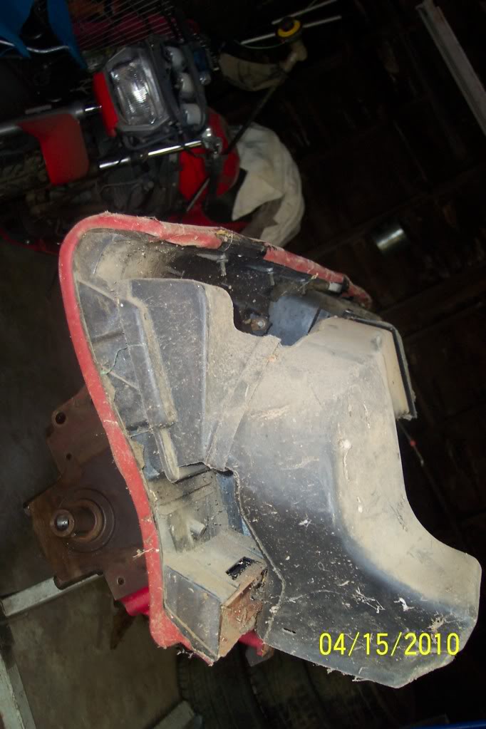

Originally Posted by jj74sd455
it would probably take a lot of fabrication,but definitely possible.the toughest area i see would be fabricating the filler panel between the dash and windshield.on the second gens it is rivited to the firewall and used as an anchor for the dash.unless you are using a new dash, all the old ones i come across are very brittle. if you want measurements just tell me what points, ive got a 77 firebird and plenty of extra dashes to measure.
how wide are they from a pillar to a pillar on the top and where are the mounting tabs how far apart are they thanx. if i do this i will use a new one ive read alot about the old ones being warped and brittle from sun exposure. also the center console would they fit in a third gen and whats the width, length and height on them. thanx
stephen i thought about that. but i thought this idea would look better.

ive got to do some errands this morning,ill get those for you a little after noon

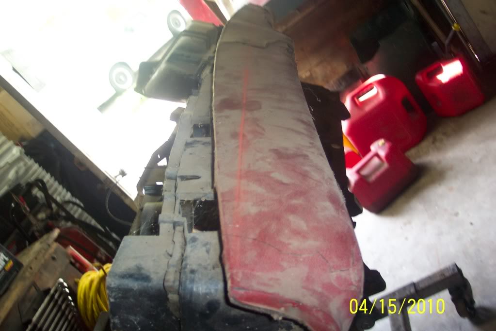

heres another pic of a 2nd gen dash
if the size is close to the 3d gens then it should be a fairly simple swap. mounting brackets shouldn't be to hard to make.the things that will be the most complicated are the E-brake. and modifying the heating vents.
the wiring should be pretty simple the only thing about the electrical that i can see is the headlight switch cuz the second gen didn't flip up

Re: 2nd gen dash
but im tellin ya , wow how close do those kick panels look to a third gen
Old Apr 15, 2010 | 07:18 PM
aremy10's Avatar
Joined: Mar 2010
Posts: 271
From: sturgeon bay wisconsin
Car: 91 firebird
Axle/Gears: stock
Re: 2nd gen dash
as far as the heater vents and tubes behind the dash go i would think you would need a little custom work on em to make them work but i think you got a realy good chance of this workin
Old Apr 15, 2010 | 07:29 PM
87bluebird's Avatar
Joined: Mar 2010
Posts: 567
From: middle of nowhere between farms in New York
Car: 1987 pontiac firebird
Engine: 6.5 turbo diesel
Transmission: t56
Axle/Gears: Ws6 axle
Re: 2nd gen dash
Originally Posted by aremy10
the second gen doesnt look as deep. i agree , but that could be cause the whole dash looks to be deeper in on that side. on the third gen alot of that depth is actually just the dash cover itself stickin out farther, which im sure you know already, just pointing that out, so in reality it may actually be closer to a fit then you are worried about, im thinkin alot of the depth on that side is just a visual effect of the third gen . i could be wrong maybe find the depth from the map pocket to the firewall in the third gen. instead of goin by the dash . it may be closer then it appears
thats the 14 inches and the second gen has the glove box which will cause some interference the heat vents and tubes look like there close to the same area so they shouldn't be to hard to modify
i hadnt even look at the kick panels yet but they do look pretty similar i doubt i would do any swapping of them tho.just dash and possible center console.i was also looking at the second gen door panels as another possible swap.
i'll probably just do the dash for now and go back later and do other swaps i know the 2nd gen door panels are'nt the same shape as third gens and probably wont fit but i could redo the 3d gen door panels to look like that

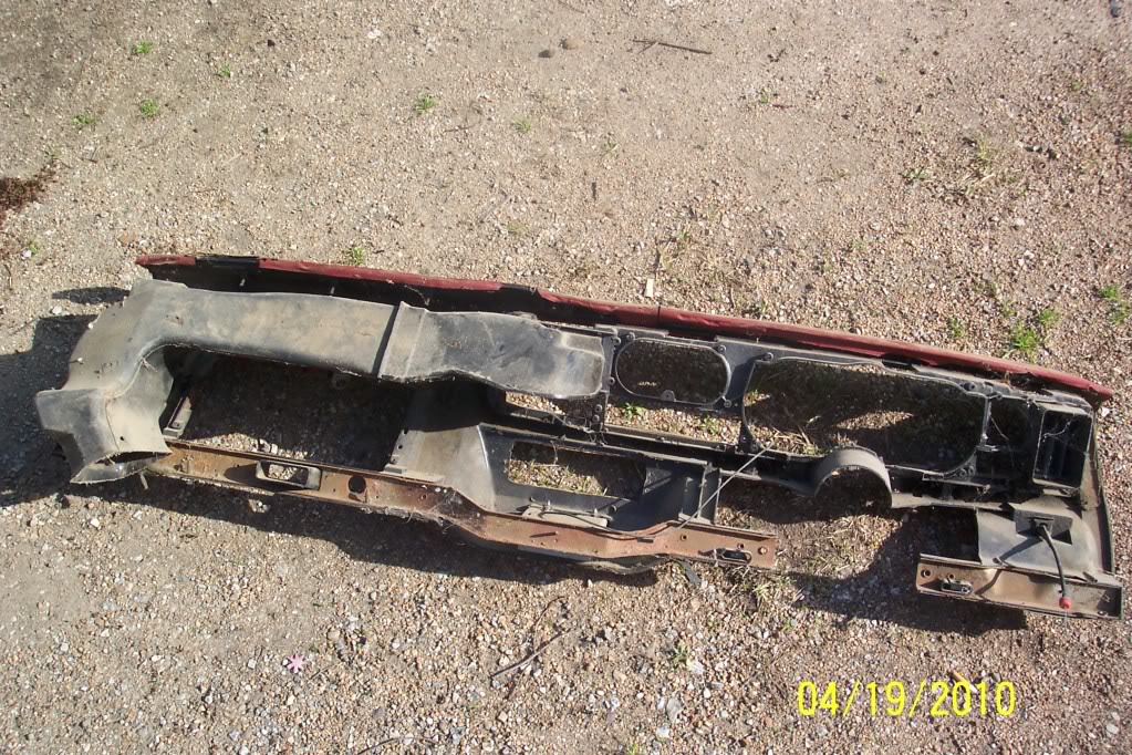

Re: 2nd gen dash
heres the dash extension mounts
heres the back of dash
heres the dash curve to view
heres the mounts on the dash (studs on pass side, bolts on driver side)
heres the side view of dash shape
heres a link for a vacuum formed dash cover for cracked dashes
http://cgi.ebay.com/ebaymotors/ws/eB...d=330419446611
still working on getting shipping figured, you may try a second gen site for sponsors like the thirdgenranch to buy everything in a package deal. it would probably be easier.
