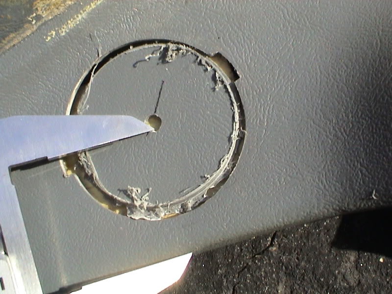

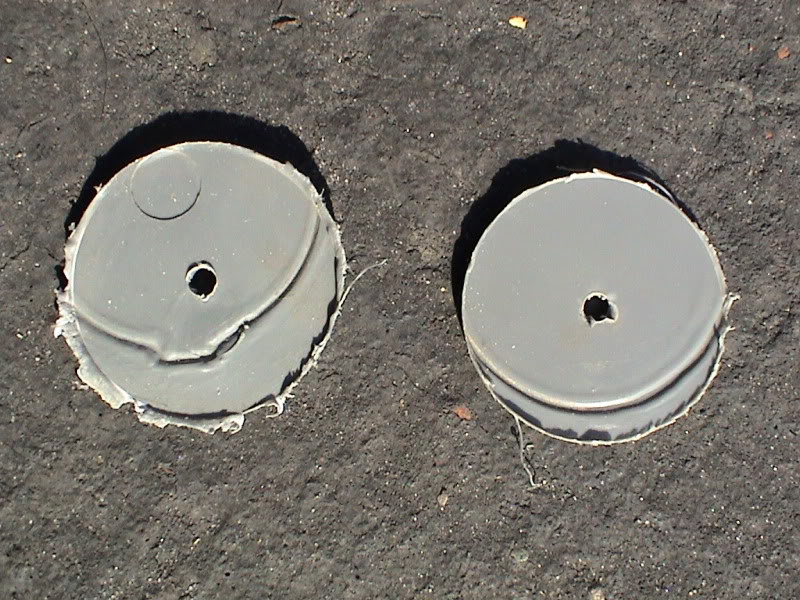

The hole for the rear roller shade apparently was changed. I had installed a later set of plastics in my '86 and the holes were off from where it screwed into the metal part of the body. I installed a different (later) set that did not include holes and transferred the hole locations of the original 1986 plastics to the later version and it was off from the pre-cut markers on the later version.
Probably not explaining it very well. See in the pic below where it's pre-scored and how it doesn't match up with the earlier location.

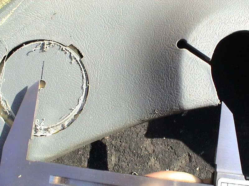

Below is how I transferred the location from a couple of reference points:

Otherwise I didn't notice any issues.
this is actually really good to know. I have to cut the hole in one of my interior pieces and was going to just cut on the marks on theback of the panel. Not now, i have to measure.
thanks for the heads up
