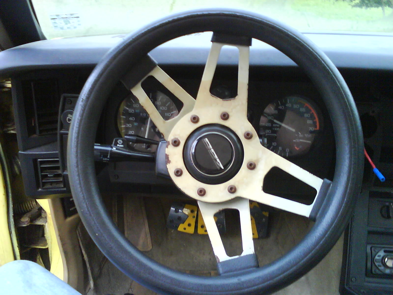

anyone seen this before?
Hey guys!
Has anyone seen this steering wheel before? I think it`s a GM option, but not sure. tried to remove it an other day, but was not able to. could not remove the horn button.
looks like the 8 bolts on the wheel only lousing up the spacer.
I hope someone can help me, Thanks.

looks like a grant challenger wheel i got the black version in my car

ye i know about the grant 13 1/2" wheel, and i used to think this was it to, until my friend run a carfax for me.
As an option in there, is a 13" steering wheel.
anyway i still don`t know how to remove it.

pop the horn button off and theres 3 bolts and a nut under there just like pulling any other steering wheel. i love the challenger wheels. infact i want to get one identical to that one.

That is a Grant Challenger wheel for sure. It simply has a Z28 horn button in it is all. Cool horn button though, I would definitely grab and clean it up if I had a Z with a Grant.

press on horn button , turn ccw about 1/8 of a turn . horn button should come off . might want to pull fuse or disconnect battery . i have that grant wheel in my car . good luck .
