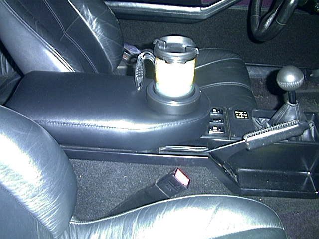

Old Feb 27, 2011 | 04:55 AM
85 ZXX's Avatar
Joined: May 2009
Posts: 403
Car: 85 Z28 T-Top 36mm sway & wonderbar
Engine: TPI L98 350 W/85 Vette Stage II ECM
Transmission: W/C T-5, alum drive shaft
Axle/Gears: 9 bolt posi, 3:27, PBR's, BB LS1's
Re: Cupholder Install
I like mine. This one will hold a large cup.
