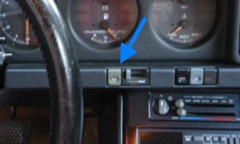

Ok, sorry guys I couldnt get the pics off my old phone to show everyone but I am wondering what the plug in is used for under the fuel gauge? I am guessing for the dash accessories and second, WTH is this vacuum cylinder in the second pic used for?

where does the other end of the vacuum line connect to?? and that plug under the gas gauge is wired to it????

No, these are two componants are not related. I have a slight idea what the plug under the dash is for but the vacuum line off the box goes inside BUT I already have a vacuum line to the AC controls so I dont know what this box is for. The car is an 86', the first year and last year for lots of things. My 87' Firebird was so much easier to identify things on than this thing.

The black mailbox shaped thing is a vacuum reservoir, same function as the round under fender mounted ball on later cars.
The white connector, is for a subwoofer sound system (UQ7)
They have a slider **** there.
