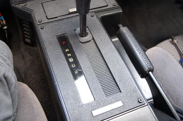

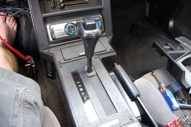

Re: Also need automatic trans shifter boot for 92 RS
If you go to Lowes and look they sell this stuff by the foot, and its only like 3 bucks a foot. Matches the texture of the shift plate almost perfect you just have to use your old shift slider as a template. Also you have to reuse your little ring that your shifter slides through. My little shifter slider was literally falling apart.
i was gonna make a couple sets but didnt seem to be a demand......I probably could have done them for 8-10$ shipped.
