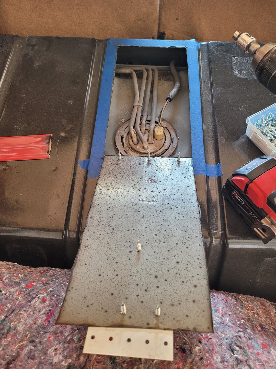

This is a pretty old thread but I figured I would drop this here. The pump was replaced by dropping the tank only to find out it still didn't work. I bought this car not running afterwards. Cut the access panel. Pulled the pump and soldered all the connections inside of the fuel pump assembly. I figured I will get a rubber mat to lay over this and call it good. Their really isn't a reason to try an "seal" it with a gasket because water can't splash up on top of the tank and if you're trying to keep fumes out of this area your tank is leaking and you should fix that.
The access panel makes doing the fuel pump on the side of the road possible and quickly. I work as a mechanic professionally and i always appreciate the cars that have fuel pump access panels.

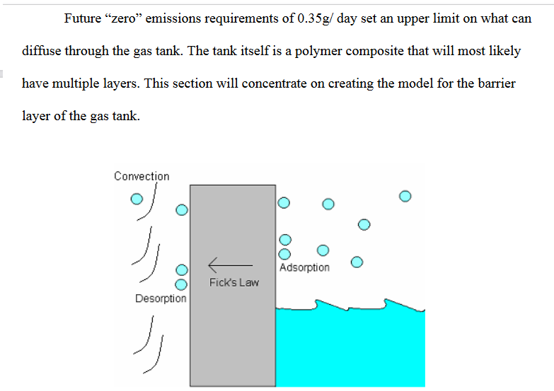

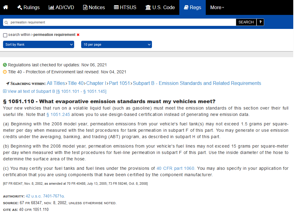

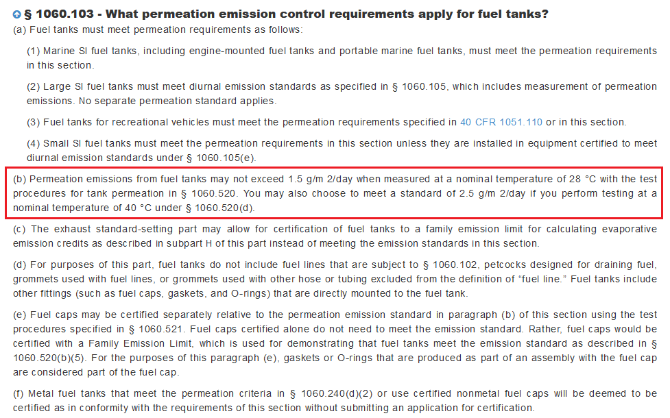

Fuel and water can permeate right through steel, iron, plastic, rubber, etc... the properties of these materials are sufficiently sized pores to allow fuel permeation over time. Water gets into your fuel tank gradually this way... and fuel leaks out at a constant rate. There is always some leaking.
