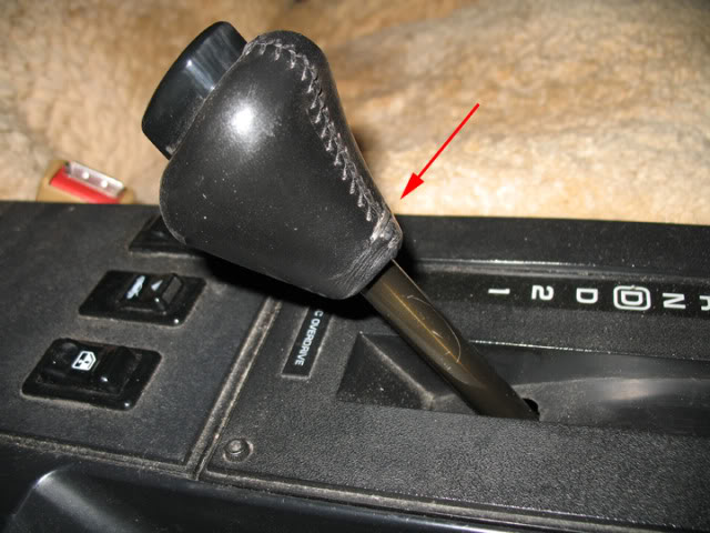

Let me CLARIFY..................
I just checked my 84 shifter!
Your looking for a external snap ring !!!!!!!!!!!!!!!!! NOT a C clip !
Hardware stores will have a box with different shapes and sizes
These guys have them:
http://www.ebay.com/itm/ws/eBayISAPI...p%3Aen&vxp=mtr
Look here for the different styles:
http://www.arconring.com/stamped/

If you have a newer car with the "staple" that holds the shifter in place heres a pic of the "staple" and a link where to buy one.
http://www.moderndaymuscle.com/inc/sdetail/645
