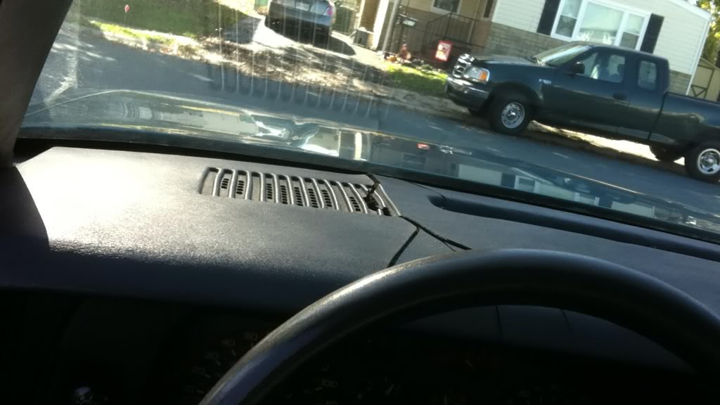

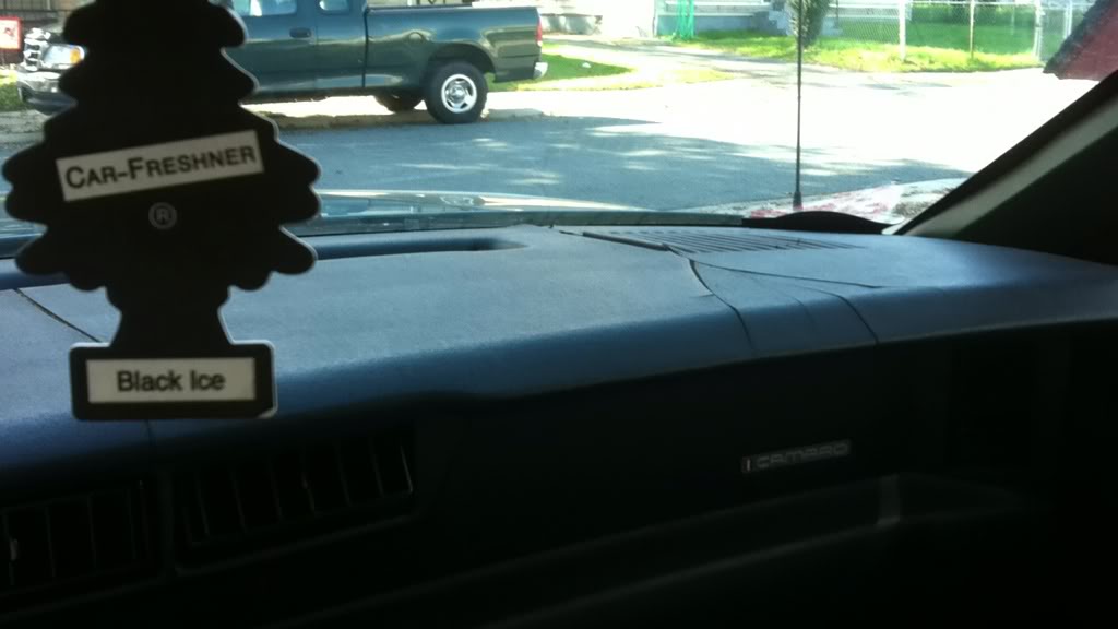

So i decided to try to wrap my dash pad today. n i think it turned out damn good.
This is how it looked before
and how it looks now

how do the corners look?

it looks like a nice first try. If I could make a suggestion, it would be to flatten the cracks in the pad by filling them with something (bondo, expanding foam, whatever) and then using a sander or grinder to flatten out the high spots. Once you do that, tightly wrapping the pad with a good quality vinyl that stretches with heat will give you the ability to get it nice and tight, and to fully wrap it around the corners.

The corners look ok they could have been better. It was my first time wrapping something like this. and Jim yea i was thinking about that after i started, it turned out great minus that part. ill prob redo it again later down the road but i highly suggest using the marine vinyl i got its very flexible but very solid and it supposed to uv ray protected so little to no sun damage! .
