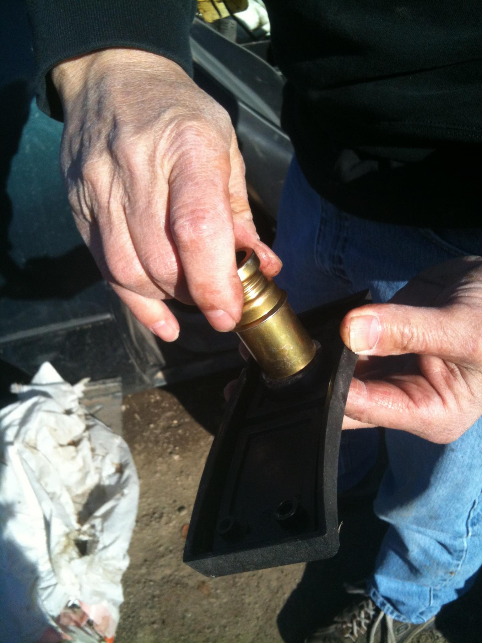

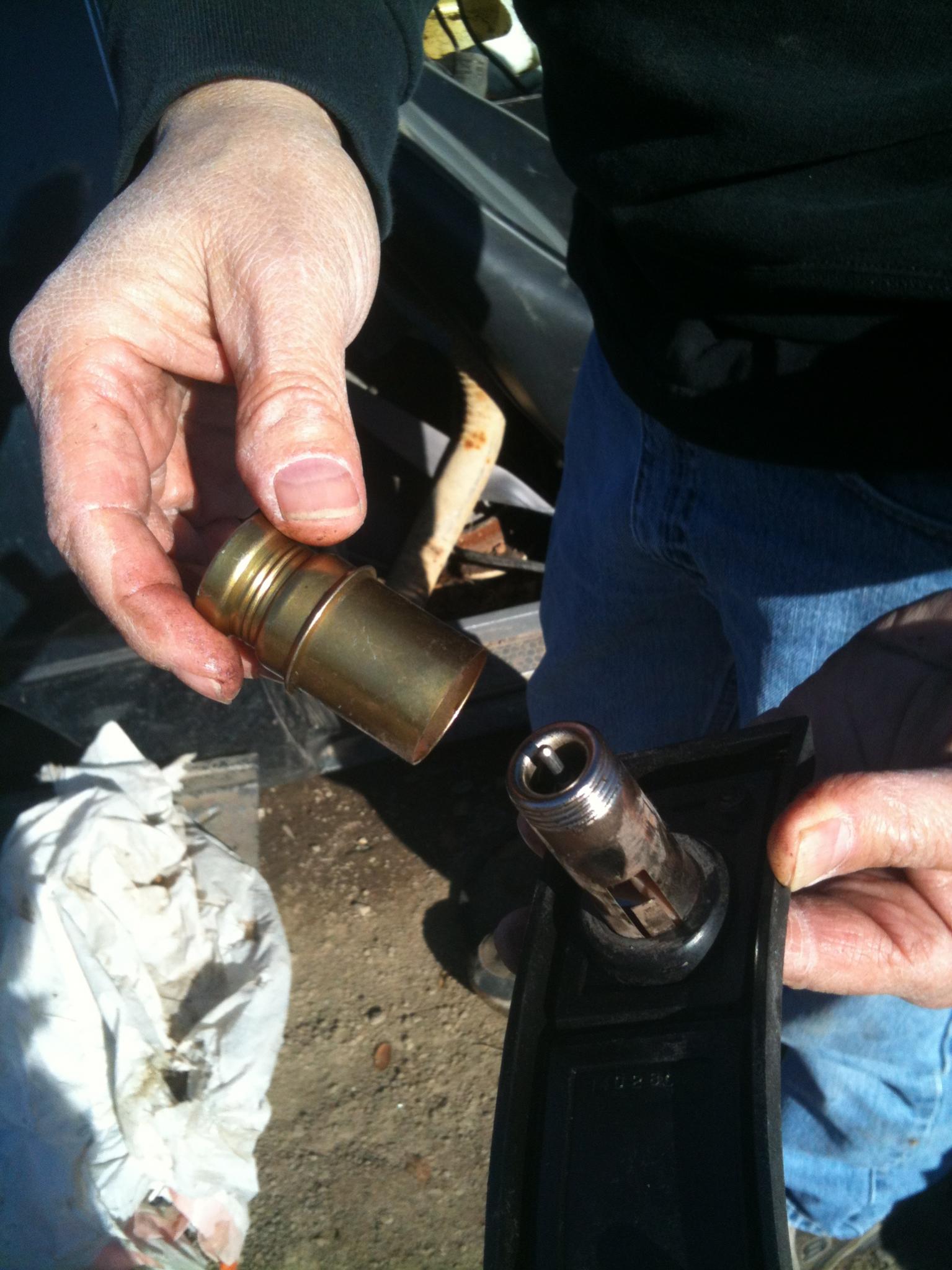

Re: How Do I Remove Cigarette/Defrost Bezel?
To remove the lighter from the bezel itself, you do need to unscrew the parts. The lighter above wouldn't budge until I shot it with a bit of WD-40. After unscrewing, the silver piece simply pushes through the bezel.
JamesC

And james thanks for the pictures! That will help a ton!
