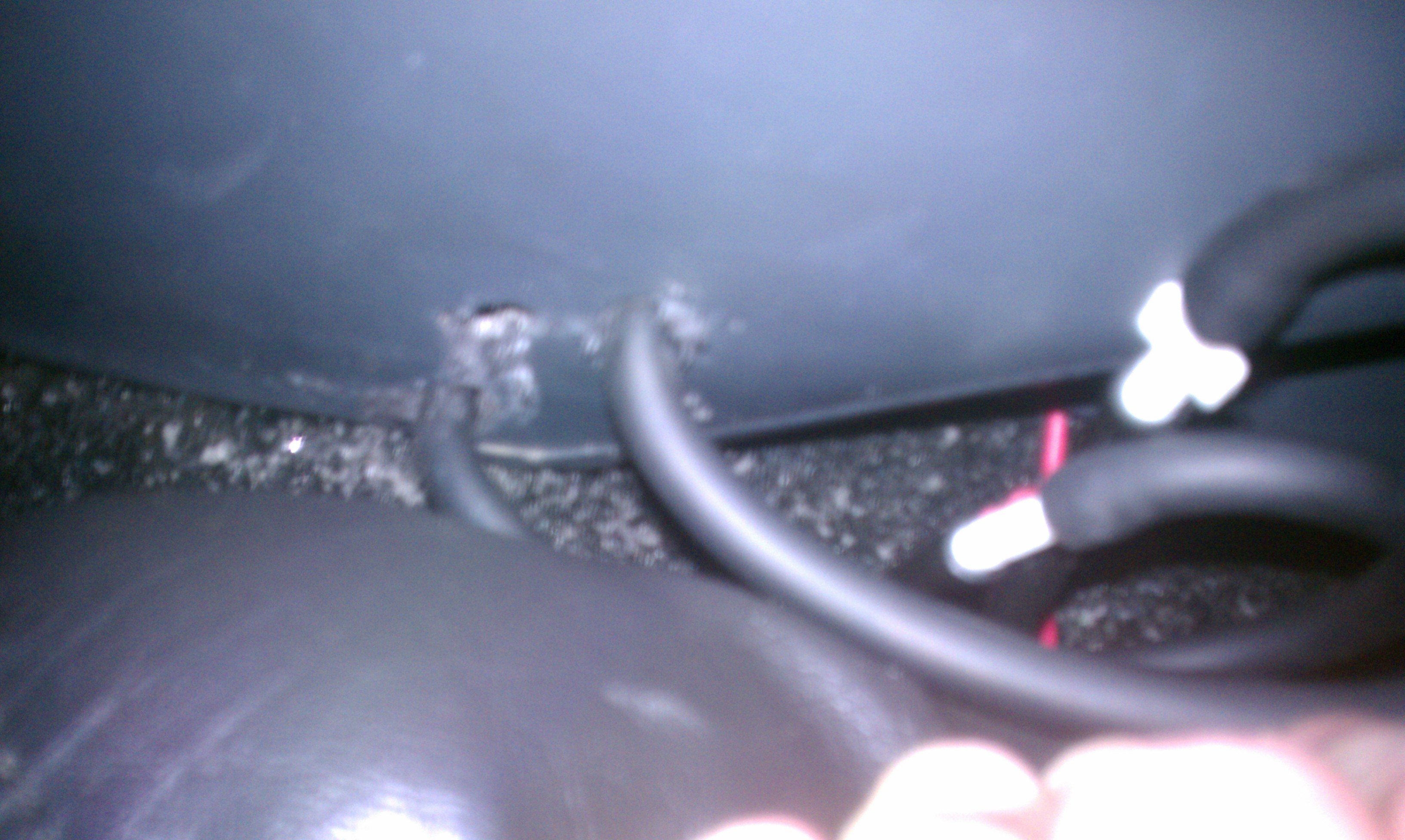

Now its time for the passenger seat. The passenger seat is NOT power besides the inflate lumbar and side supports. I see the same orange wire in the harness. I assume I can run this to the other power window?
The Question is how do I get the lumbar and side supports to inflate in both the driver and passenger seats?
I included a picture of the hoses on the driver seat and the power connector and hoses on the passenger seat.
So the leather 4th gen 2 rear bucket seats slid right in, along with the fold down back. It looks killer. The Driver seat 6 way power functions work perfect.

There is a seperate harness for the power lumbar.Would of been easier to get it from the donor car.The harness integrates the pass/Dr switches thru relays, since there is only one pump for both seats.
Simply providing power to the plug pictured will not operate the lumbar features.There is also a single air line that crosses over from the dr to pass side.So when the pass seat is adjusted only that seat will receive air.Even though the pump is on the driver seat.

84 1LE - I got the seats as they were for an unbeatable price - No harness. No worries, I made the harness with some colored 14-gauge wire, hose and connectors. Not sure what the harness looks like but I wanted to hide it from plan view (didn't want to wrap it around the back of the center console) so I drilled 2 holes on the driver side and 2 holes on the passenger side of the console (low and hidden by the seat) for the 2 hoses to pass from seat to seat. I then threaded the hose through with caps on each end so I can connect and disconnect the seats easily if I need to. I included pictures.

Factory routing is under the carpet/over the trans tunnel to other side.You should do this so the seat track doesnt catch on it.

I'm going under the seat track, there's no movement there, and the cushion of the seat does not rub (plenty of room). I slid both seats forward and back and its not rubbing. Not that I move my seats much anyway. It seems to work fine.

4th Gen Power Leather Seat Install
aqualordx93 - I am very far from anything remotely close to a mechanic or electrician so when I tell you anyone can do it, I mean it. It took me the weekend, but I took my time. There are a few ways to do this. This is how I did it:
The Lumbar and side inflation device is under the passenger seat so you need to connect both seats via hose and wire inorder to get air to the driver seat. Each wire needs to be connected to the same colored wire on the other seat, except the Orange hot wire and Black ground wire. The hoses between each seat need to connect right hose to right hose and left hose to left hose.

Tools:
Wire cutter
Ratchet (remove seats and to secure ground)
Drill
1. Cut the factory connectors off the wiring on each seat and install male connectors on each wire (easier to do with seats not installed).
2. Label the right and left hose then cut the factory connector off the hoses and install 4 connectors (easier to do with seats not installed).
3. BEFORE installing seats (it can be done with seats installed just a pain-in-the-butt). Drill two holes low, and hidden by the seat, on the driver and passenger side of the center console. Thread 2 2ft sections of hose into the center console through the holes. Remove the top of the console so you can thread it through easier and ensure none of the 2 hoses are hitting any moving parts (shifter or E-brake). Once threaded put 4 connectors on the 4 hose ends.
4. Thread the pink, red, gray and purple wire up under the center console on the passenger side and out the bottom of the driver side, again ensuring its not getting hung up on any moving parts (Shifter or E-brake).
5. Thread one strand of orange wire under the driver seat to the driver's side power window hot wire (its pink) and 1 strand under the passenger seat to the passenger seat power window hot wire (also pink).
6. Put the seats in. And ensure the wires/hoses are going under the track where there is minimal movement when the seat moves. Also ensure the wires are all long enough for the seats to move forward and back without ripping them out. Put female connectors on both ends of each wire . Ground the black wire from each seat to a seat bolt.
6. Connect the hoses on the seat to the hose you threaded through the center console with the connectors and connect the respective colored wires to each other on both seats.
That should do it. Test it out. If it works then tuck all the wires/hoses under the seat nice and neat.
Like I said, there are a few different ways of doing this, and a few other treads. This way worked pretty well.
You need:
Material:
Red Wire
Black Wire
Gray Wire
Pink Wire
Purple Wire
Orange Wire
(I used 14-gauge primary wire to prevent shorts)
Wire Connectors
4ft Hose
Hose Connectors
Tools:
Wire cutter
Drill

My seats dont have Lumbars, maybe that is a plus, haha. When you did it to the power widow wire, did you have trouble cutting the wire? there old and brittle, i would be worried about snapping them or something.

That makes things way easier. If you don't have the lumbar support just send the hot under the center console to the power window switch and ground to a seat bolt on the floor. I didn't even cut the power window wire. I just kinda plugged it in where the hot power window wire meets the power window switch. It should be a real easy fix.
My car was pretty trashed when I got it, but the wires are good for the most part. I just replace the ones that are falling apart when I come across them.
