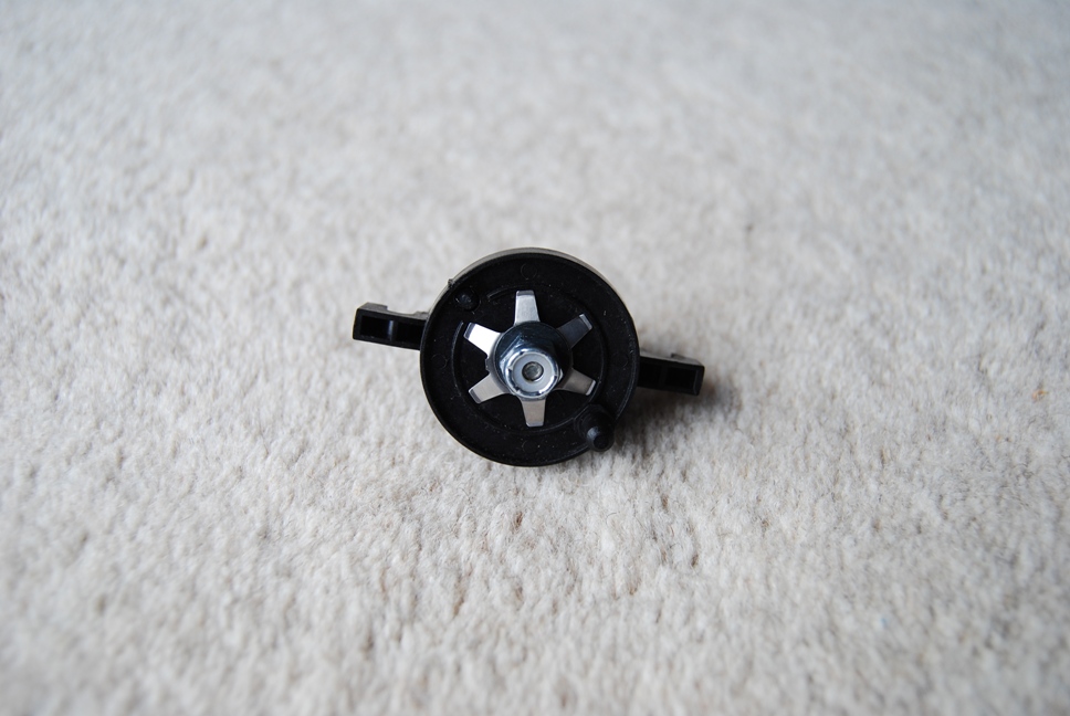

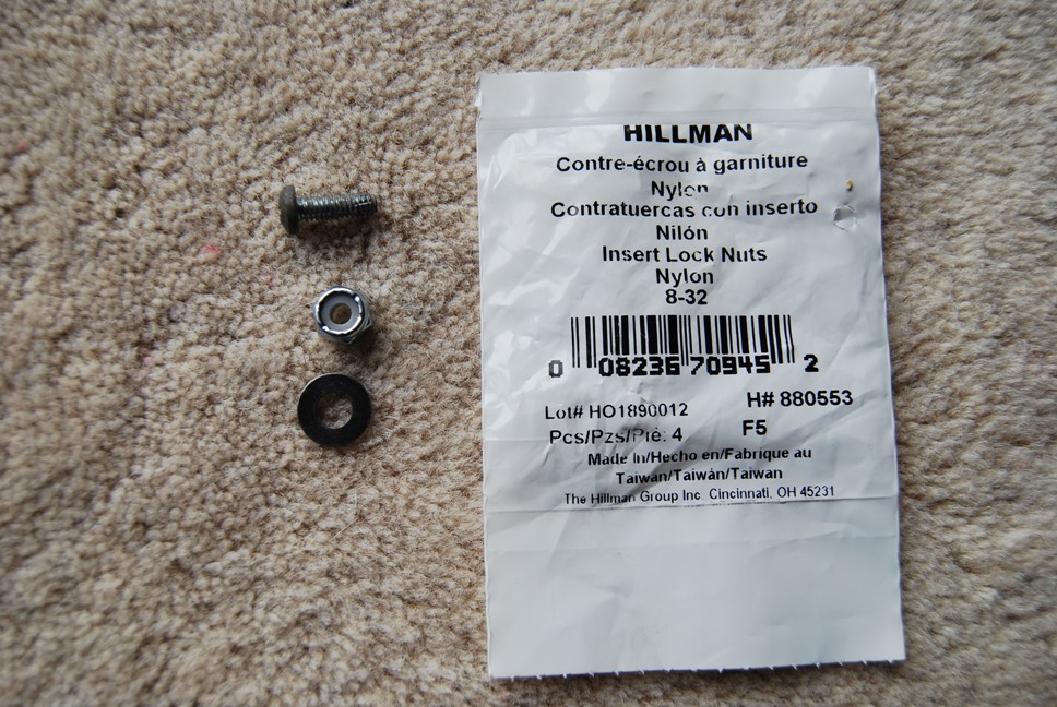

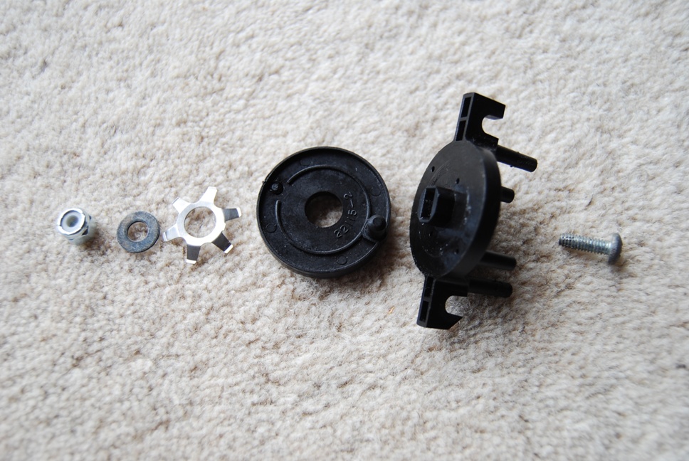

If the cause of your hissing HVAC is the selector switch, I have a permanent fix. You need a 8-32x 1/2 screw a washer and a nylon lock nut.
I have replace this switch 3 times in 3 years. I took the switch apart and found the cause. The spring or the plastic fastener fails.
If you remove the fastener and use the screw and nylon nut to hold everything together, you will be in business. I posted a youtube vid if you want to see how it goes together.
http://www.youtube.com/watch?v=Mv782CIJDks
Attached Thumbnails HVAC switch permanent fix.  No more hissing!-things-needed.jpg   HVAC switch permanent fix.  No more hissing!-hvac-switch.jpg   HVAC switch permanent fix.  No more hissing!-switch.jpg
Last edited by jster1963; May 3, 2012 at 12:26 PM. Reason: I want to upload pictures

Well, I took mine apart, BREAKING THE SWITCH IN THE PROCESS- DAMN!- before I check it, LIKE AN IDIOT.
Anyway mine was not the problem. Mine hisses when I slide the TEMPERATURE lever- the bottom one. I too keeps old parts, like all of us I would venture to guess, and had the other switch.
I swapped it in and the damn thing still hisses if I slide the lever away from cold, so my problem must lie somewhere in that.vacuum line.
Anyone got any ideas?
Great idea for a fix, though, if that is the source of your problem...

I'm sorry! Mine has always been the top selector switch. I would try plugging the vac line with my thumb or something and see if it still hisses. If it does, it must be in the line. If it stops, it must be the switch. I sure hope you get it fixed!

Decided to give this a shot. It would have worked from what I could tell! Unfortunately, as I took it apart, I dropped the spring and lost it. I scrounged around for an hour trying to find where it had fallen to.

I did this today, and it worked! I still hear just a slight hiss, but everything now works like its supposed to. It changes from one function to another very quickly now. Now i just need to fix my compressor.
Thought I'd mention too that my plastic piece was not broken like the one in the video, in fact it still seemed pretty tight to me, but it apparently was just loose enough to cause problems. I do think maybe that rubber piece gets worn down after awhile, which means it needs to pressed tighter for a seal.

My first one didn't have a broken tab either. It just got loose like yours. I guess it gets too loose to work. And yes, a vac leak could have caused an idle prob! It's so nice to select heat or a/c and get it;-)

So the nut clears the switch housing on the TA's?
I ran a large sheet metal screw down the center of mine(down the nut side on your picture). I had to grind the head pretty flat for the vacuum switch to mount back up.

Yes. It fits perfect. I'm not sure if you looked at the youtube vid (there is a link), I put it back in just like in the vid. I'm not sure about the Camaro. Good luck.......

Just did this repair on my 88 SC.
Solved the "stumbling" problem I was having in third gear during light throttle.
Also noticed a BIG difference in low-end response in other gears.
The toolz:
Notice how the "hub" that is supposed to hold the parts of the valve together is just flopping loose.
Both locking-tabs were broken.
Once I removed the valve from the heater control unit, the various parts of it just fell apart from one another.
The little black piece (a.ka. "center-hub")on the right is the part with the broken (absent) locking tabs.
The star-spring is what keeps tension on the two halves of the adjustement mechanism, and is what keeps you from having vacuum leaks until the center-hub fails.
Pic of the two "halves" of the valve.
The part on the left is the part that plugs into the vacuum harness.
Here is the part that plugs into the vacuum harness.
Its not possible to plug it into the vacuum harness upside down, but you do need to pay attention when you re-attach it to the control-lever assembly.
You have to orient the assembled valve so that the "nub" that engages the adjustment-lever on the panel is "on top."
There are two metal spring-clips that engage the outer arms on the part.
Be especially careful when removing this part from the vacuum harness.
You don't want to break the arms. I put grease on them to make the spring-clips slide more easily during disassembly.
