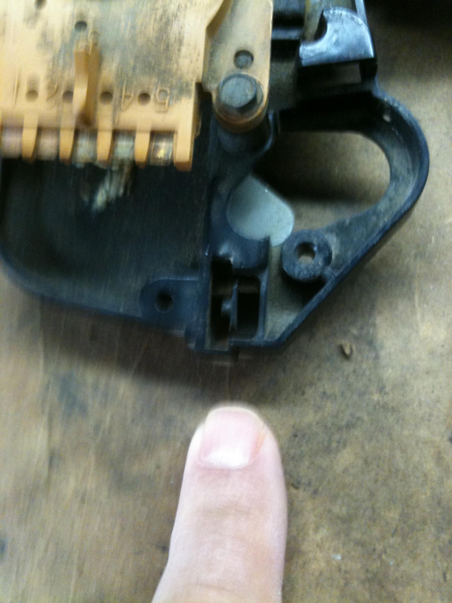

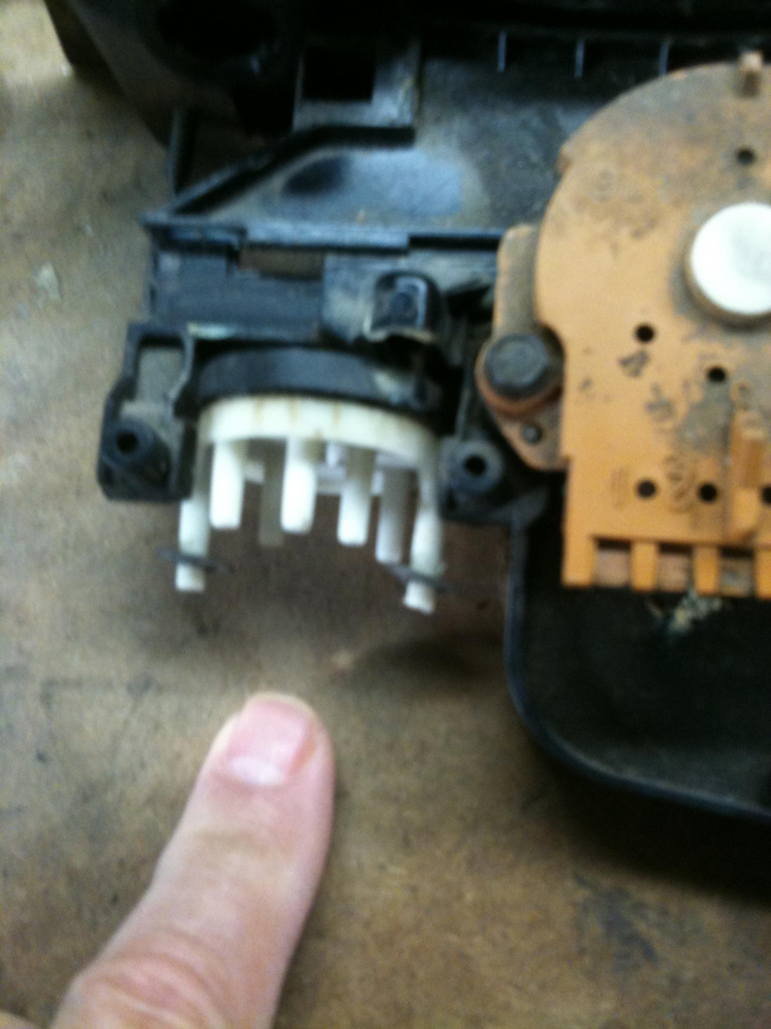

Three connections on the backside viewed from the top of the unit. The problem is probably in the second pic. The slider cable has a tab that pushes into a slot. IIRC, I used a short, flat-bladded screwdriver to disconnect it.

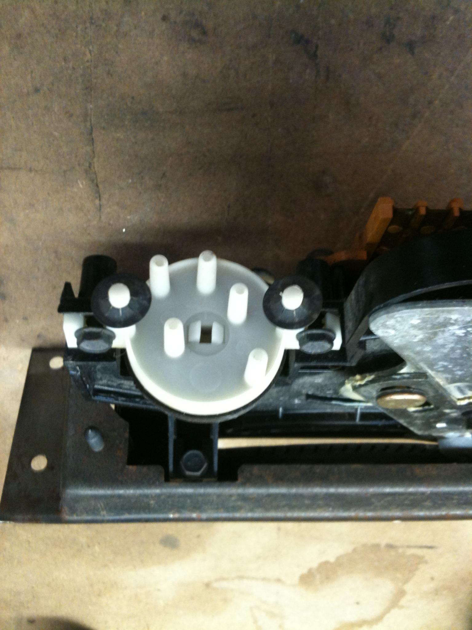

Couple more from the bottom of the unit. The little 'circle' in the first pic fits into the cable tab. The two 1/4" screws and the retaining washers can be seen in the second pic.

The white thing is selector your switch. The 2 black washers are what you want to remove. That is what I had to use needle nose pliers and a screwdriver on. Also, you can see two 7m screws that have to come off. I thought mine had 1. Just remove both of those screws after you get the "one way" washers off. You are halfway home.
