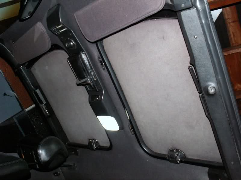

Re: Help! 3rd gen C&C T top headliner U piece ?_?
the black ring going around the top in this pic is what your talking about right? its only on c&c tops the gm ttops dont have that ring around it

Car: 89 IROC
Engine: LSX 6.0 370, TU2 Cam, Fast intake
Transmission: T56 w/ lots of goodies
Axle/Gears: 8.8, Posi, 4.10, 31 Spline
I might have a pair of them. I will look at my parents place tomorrow when Im there as I think they are stil hangin on the wall
Old Mar 5, 2013 | 12:34 PM
85camarochick's Avatar
Joined: Feb 2013
Posts: 4
I just found this picture and it shows it perfectly, as does the others some of yal posted.
Originally Posted by 85camarochick
No, I was talking about the piece that runs alongside the t top weatherstrip. When you have your t tops out and look at the area they are supposed to be at you will see a black thin trim piece that runs alongside the weatherstripping, around the whole t top area on both sides.
Attached Thumbnails Help! 3rd gen C&C T top headliner U piece ?_?-headlinerretainerstrip.jpg
Old Mar 5, 2013 | 12:37 PM
Joined: Feb 2013
Posts: 4
You just described mine to a 'T', mine also is shorter on one end than the other, I thought it was due to the warping and shrinking though? Mine has the piece and it is C&C for sure, I just can not find a replacement piece anywhere
I'm not sure if the non-vent C&C T-tops got that black trim piece, or it might be substantially smaller. I know mine has a small trim peice that basically slides over the Fabric and the T-top rail to hold the fabric in place. It doesn't fit very well and is actually about 1" short on one end. I don't have any pics of my car from the inside up.
You can see it in this pic. http://www.flickr.com/photos/8554026...7631545740311/
Its not the weather stripping. Its actually more like you'd find on one of those Report binders, a thin, strip that you slide papers into and it squeezes them together.
You should call The Sunroof Doctor. They bought out C&C's entire line-up and have tons of parts.
http://sunroofdoctor.com
Old Mar 15, 2013 | 11:47 AM
84 1LE's Avatar
Joined: Nov 2002
Posts: 6,673
Likes: 414
From: Oyth
Car: 89RS vert
Engine: Erod
Transmission: 4L65e
Axle/Gears: BW, 3.27
You dont need it.Start with a hardtop headliner & trim it extra long.Then tuck the extra material inbetween the seal/ body.Thats my pic in imiddens post.I got rid of mine cause I hated how the ends were too short as well.Anyway, havent had any issues in ten plus years & it looks wayyyy cleaner this way.
That blk ring in the pic though is the t-top frame, not the rubber piece.It was long gone by then.
