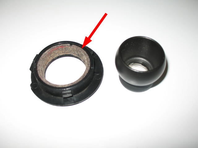

Does anyone have a picture of these pieces of felt? My car came with nothing and the swivel part and ring I bought didn't come with the felts.
Edit: Forgot this one:

Interesting. Thank you. I thought there were two pieces of felt. What keeps it from moving up and down? There seems to be quite a bit of distance between the top and bottom "seats." Almost 1/4". I can see how the felt would stop it from flopping around, but I don't see how it would stop it from being forced up and down.
EDIT: Argh! I didn't see that you edited and added a second picture. That explains my previous paragraph! Wow.
