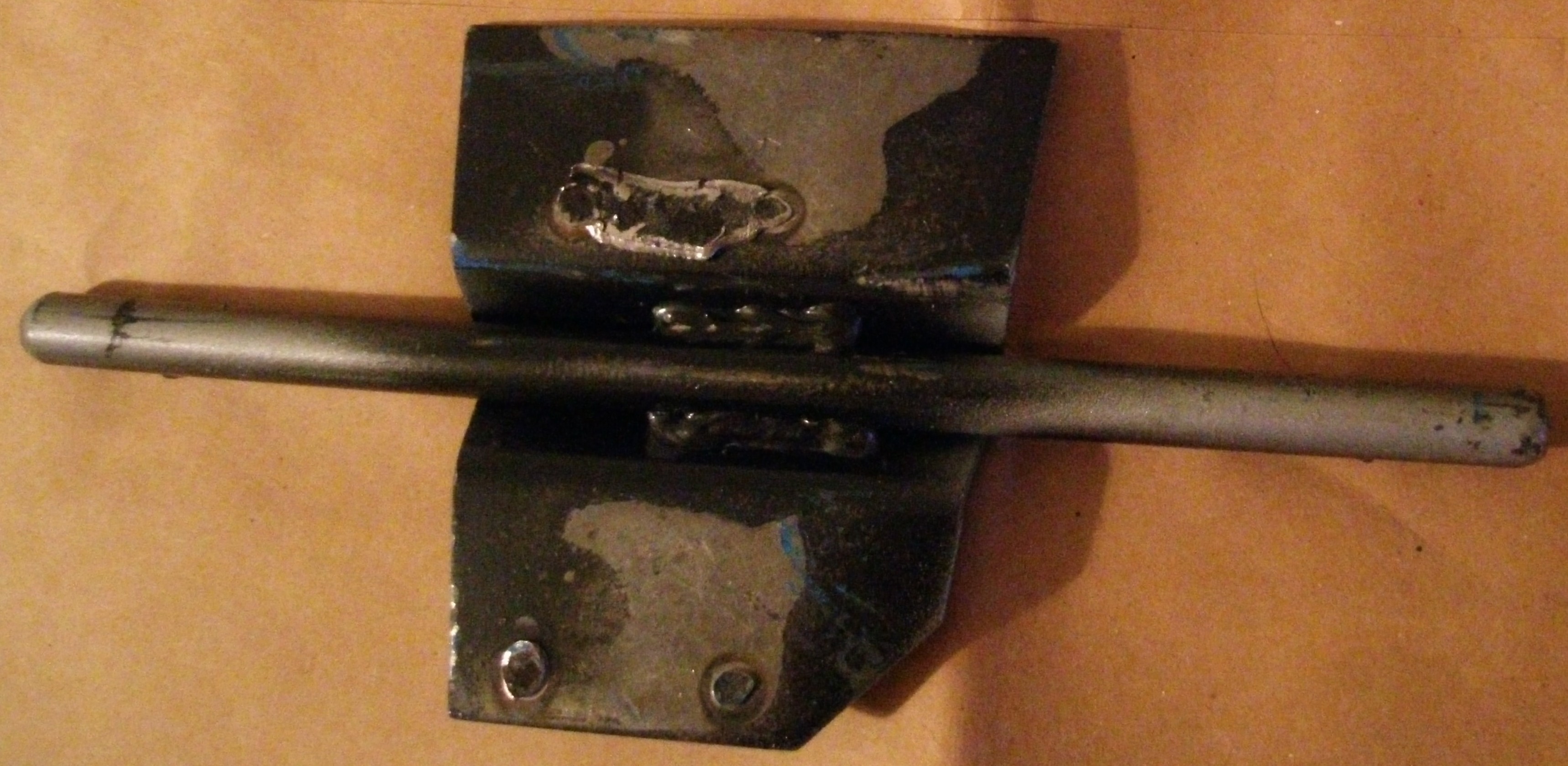

The. Only difference is there is a "T" welded to the DS tunnel, mine was the same way and I didn't notice till I installed the seats smh. But its only noticeable when u fold a seat down, past that its completely functional. I've been throwing around the idea of just spot welding a 6 inch rod there

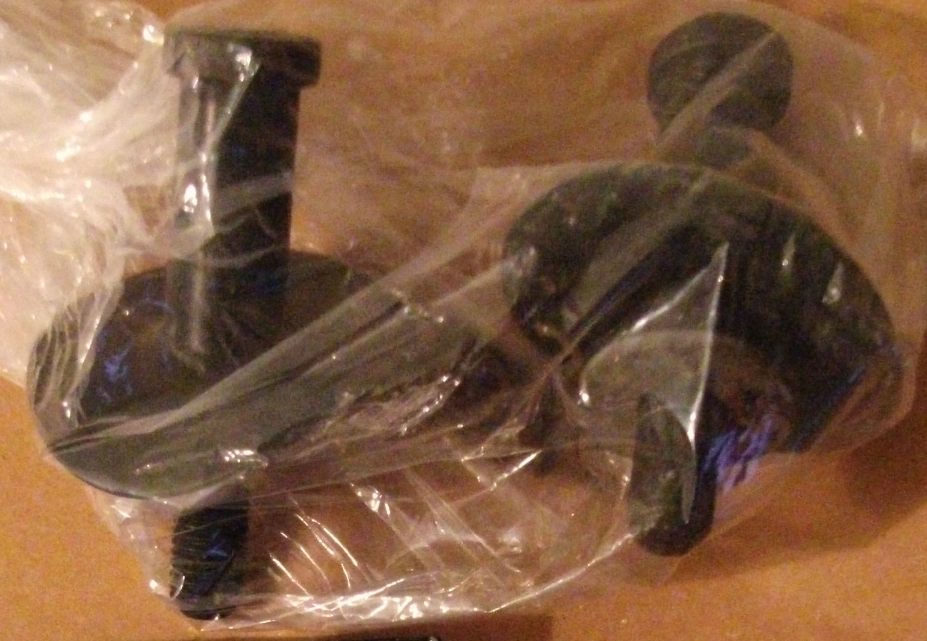

You'll need an extra latch post and a piece in the center that was spot welded in place. If you find one in a junkyard that doesn't allow cutting tools it is possible to use a chisel to free it from the body.
Attached Thumbnails single seat back to split seat back-seat-mount2.jpg   single seat back to split seat back-seat-mount-1.jpg   single seat back to split seat back-posts.jpg

Thank you all for the help, found the latch post and the T rod on eBay already. One last question , do you need any parts for the additional hardware to screw the additional latch post in ?
