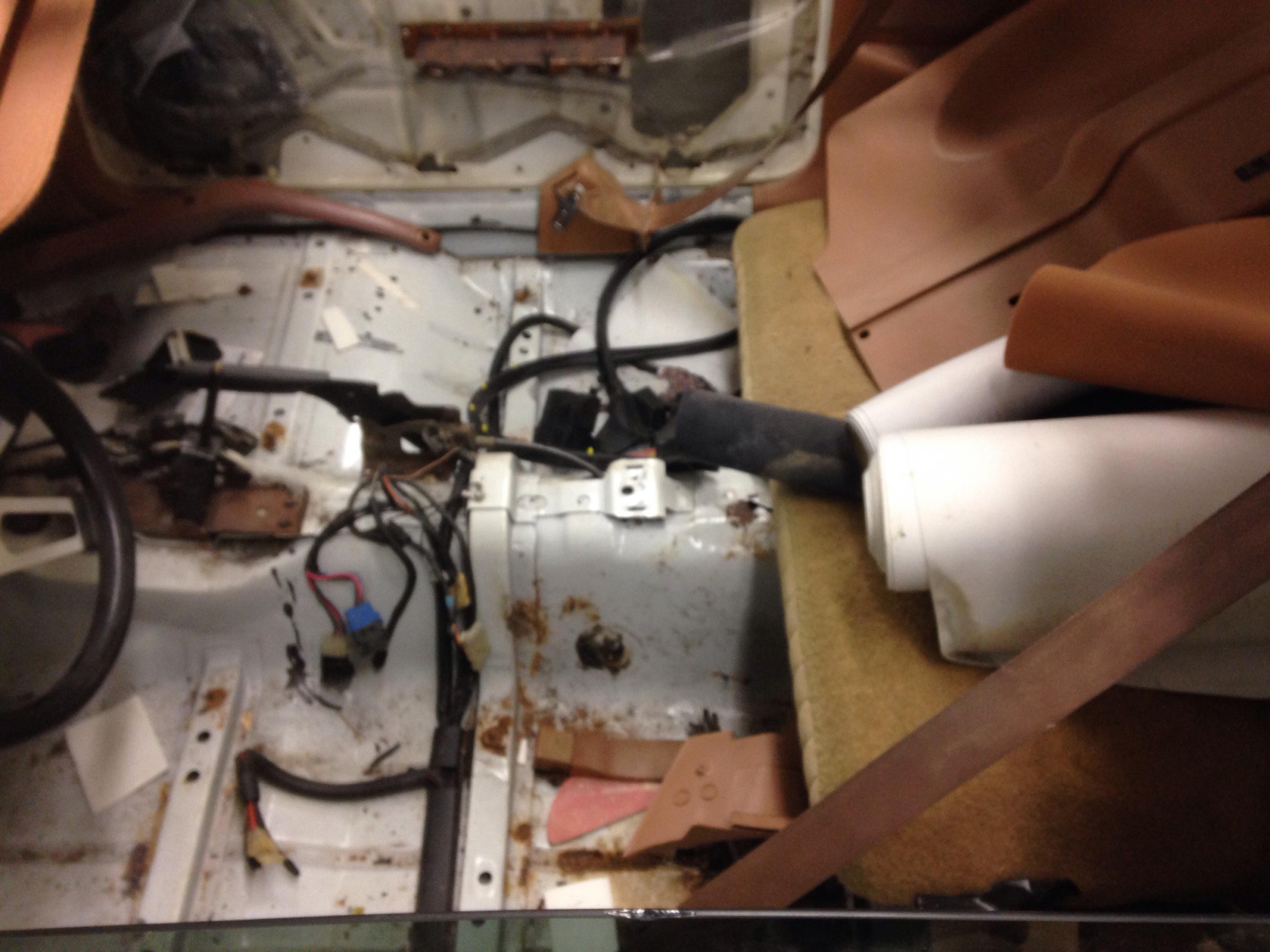

I'm starting an interior build for my white GTA. I've had this car for about two years and have had plans for building the interior.
The carpet was toast the seats were faded and the console was warped so I'm starting from scratch with a clean canvas
I wanted to upgrade from the dated 80s feel, yet be different than the typical 4th gen interior upgrade.
So... With that said I'll be building most of my own parts from scratch and using non-factory colors.

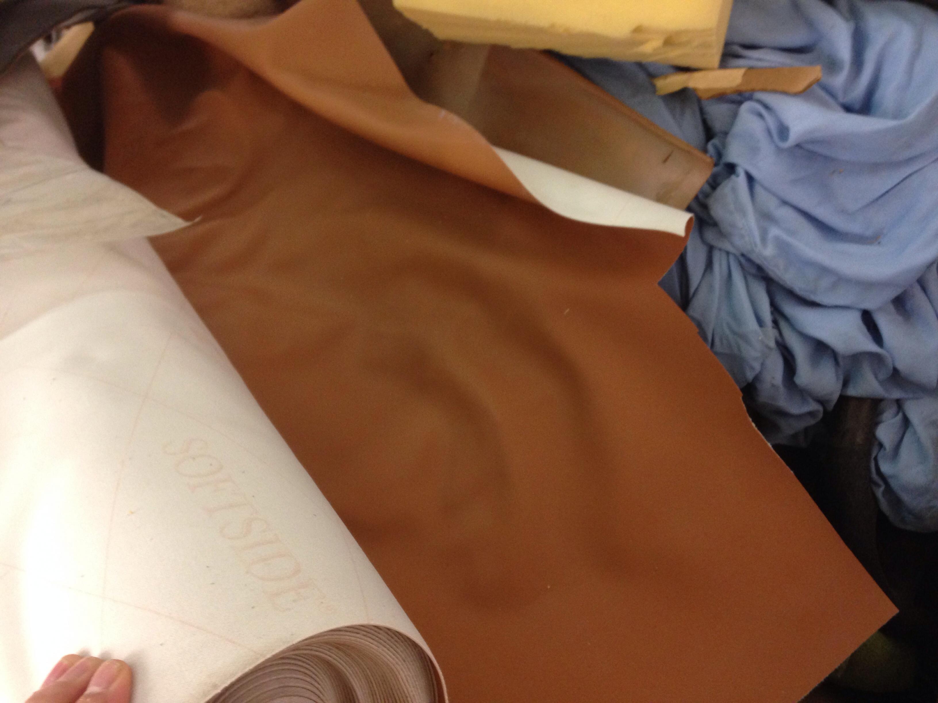

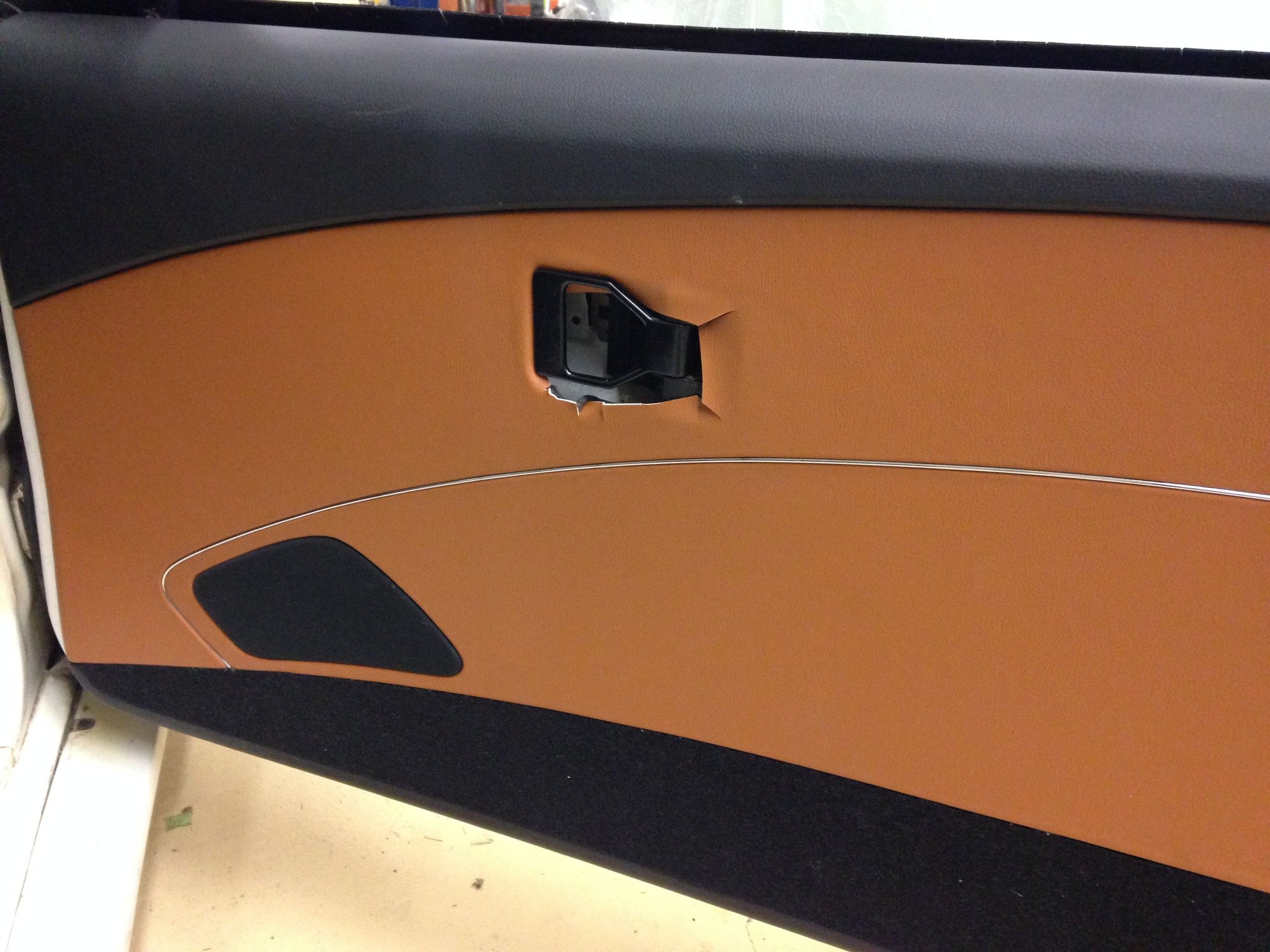

Here is the cinnamon color, this will be the majority of the interior.

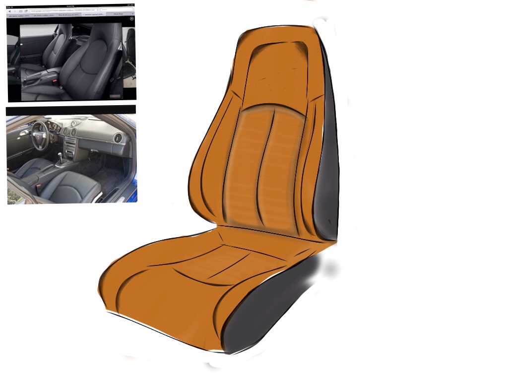

Here is what I'm thinking in terms of the seat, kind of a Porsche cayman style.
I've got the carpet in box and have done the headliner already.

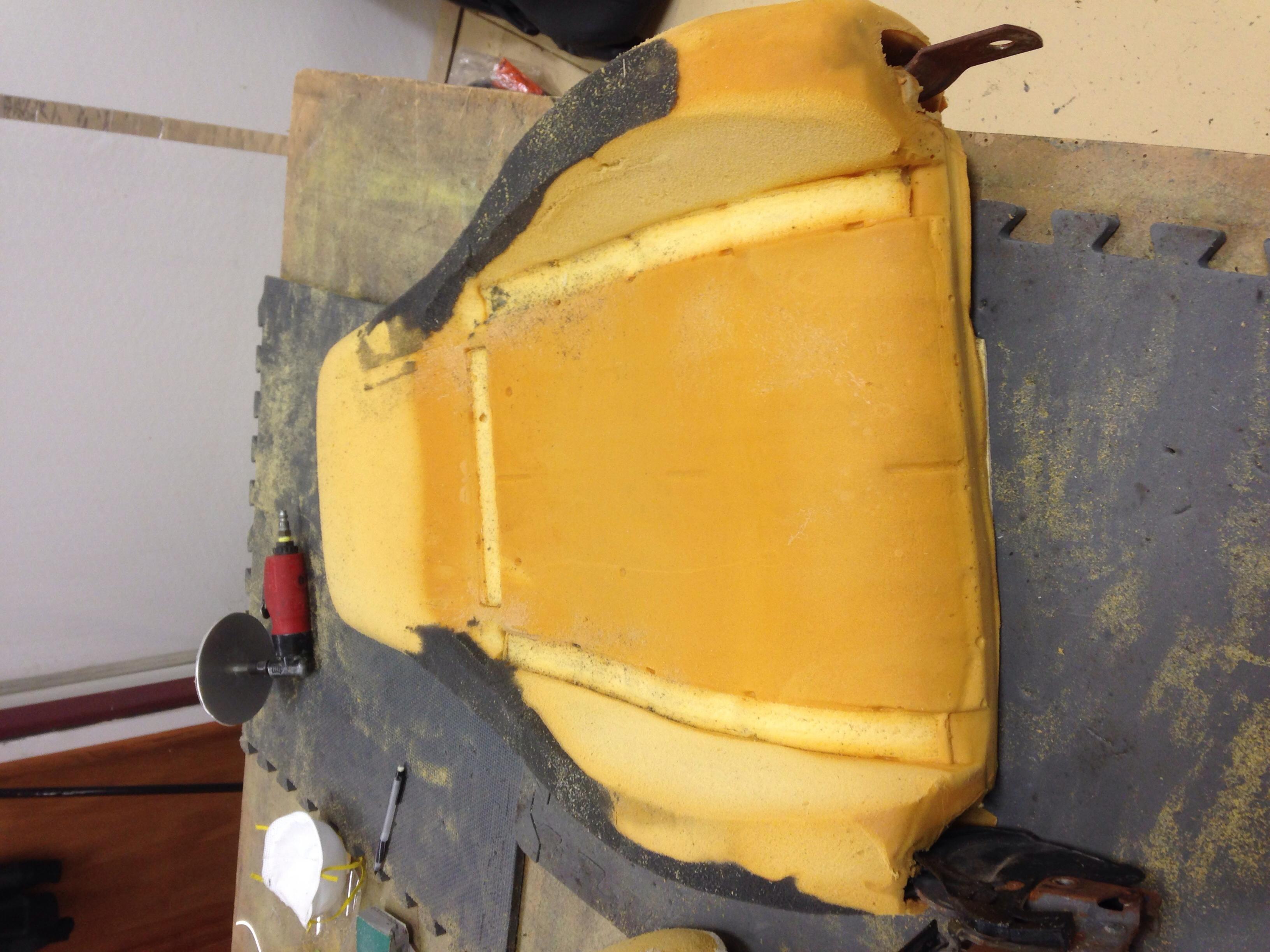

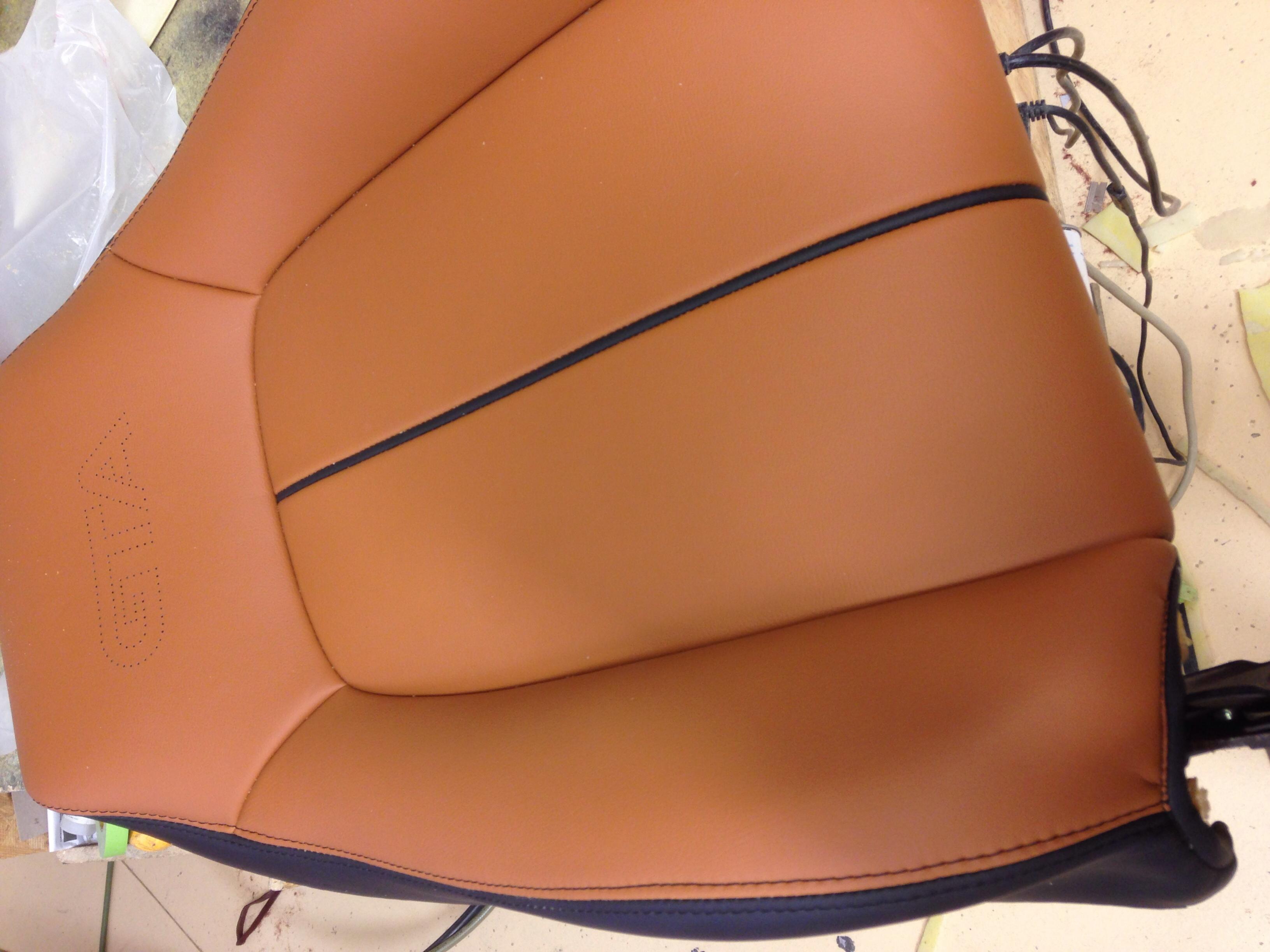

Finished shaping the backrests and started on patterning and cutting out material.

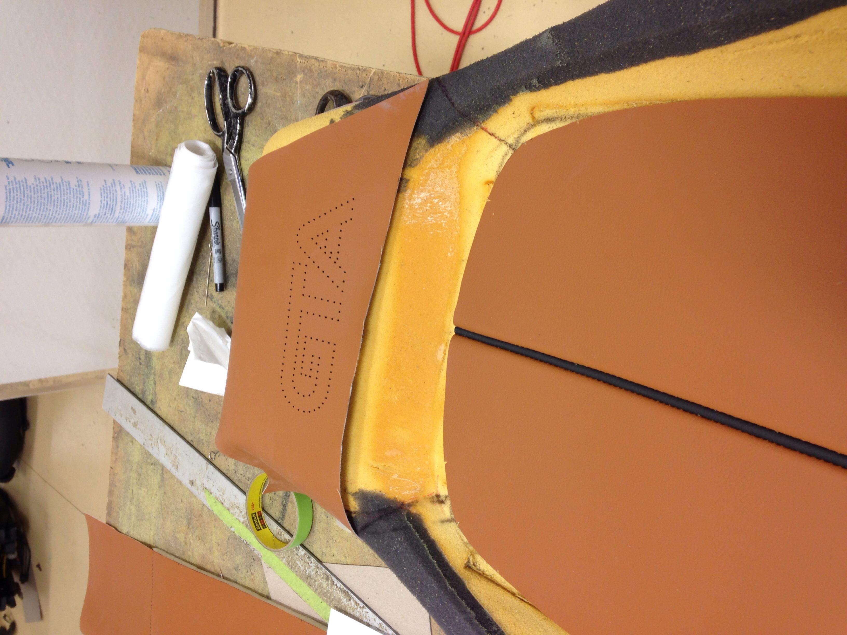

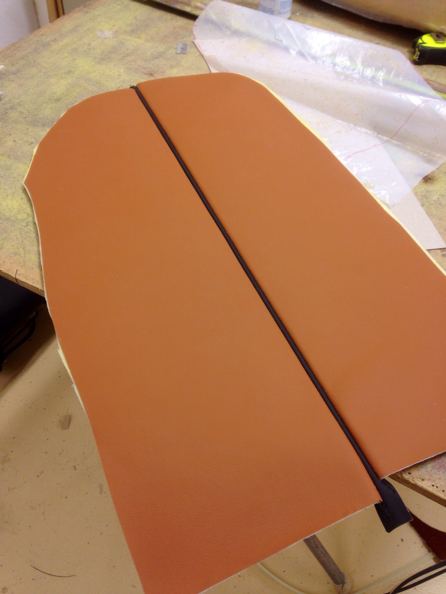

Here is one of the backrest inserts in progress.

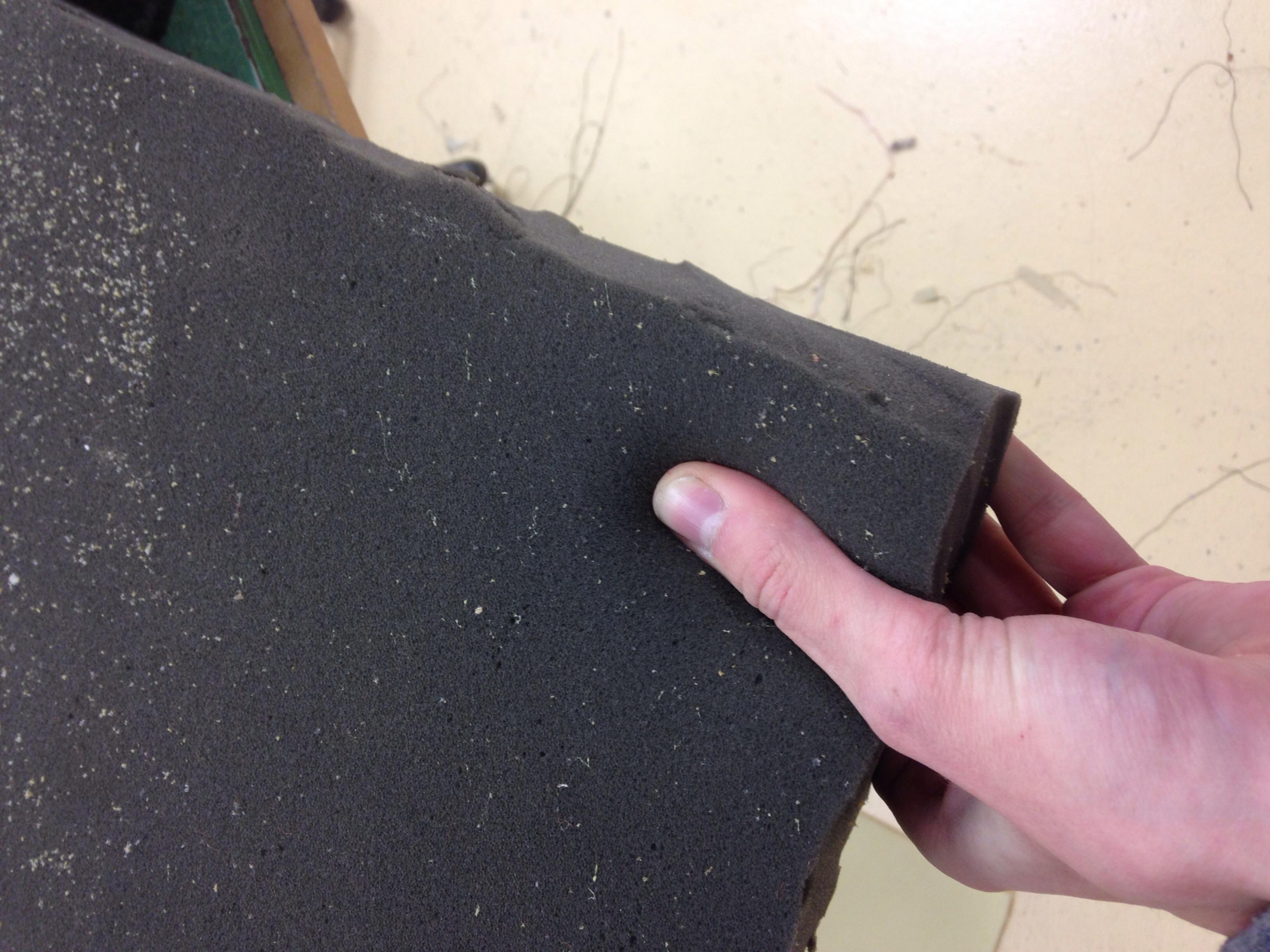

I used a roll of 4 mil? plastic and some spray can quick adhesive to get the patterns, then drew the lines with a fine sharpie.
The foam I use is special, but the key is to have a high density foam so that the shape isn't crushed when the cover goes on.
Upholstery glue, a grinder, and time.
I'm starting to get sick of only being able to have only one picture per post, is that just the way it is with iPhones?

It's called 90-180, it's the density rating.

No, it's actually perforated on a cnc machine. I kryloned the back black to make the holes stand out more.

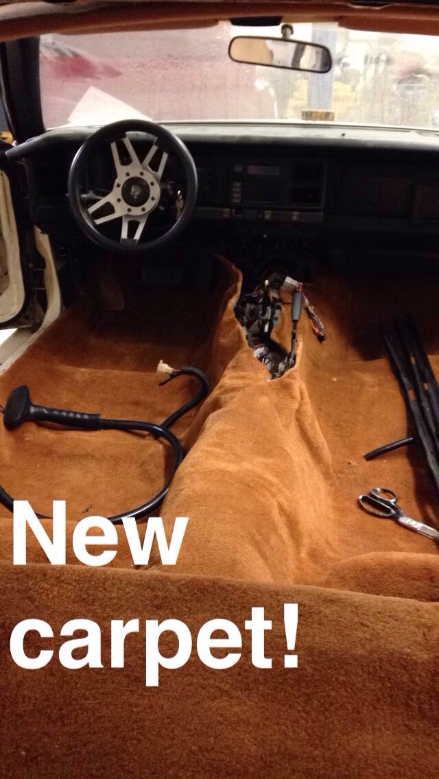

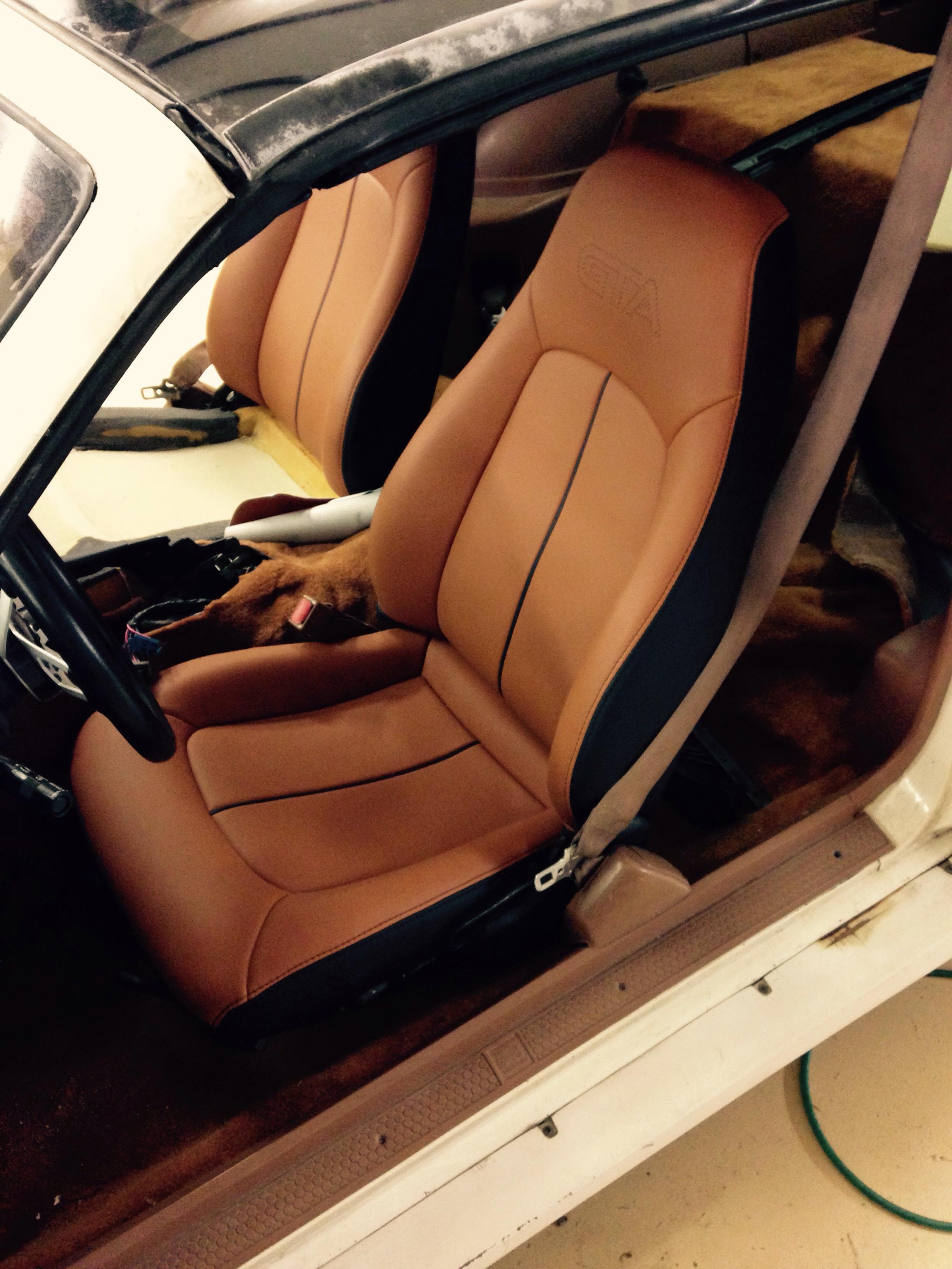

Finally got some progress on the interior off and on and now I have a complete carpet and one full seat done
I am just ecstatic about how this seat turned out.

Here's the seat

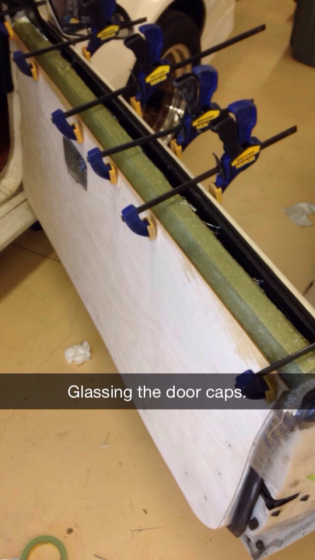

Here's progress on the door panels, still working on an armrest and door pulls.
Someday I'll get rid of those hideous handles.

Thanks! It's stainless rod with tabs soldered to the backside to grip the panel.
I'll get a better shot tomorrow.

those seats and door panels are unbelievable man, I wouldn't even want to sit on them they're so nice.
Old Jan 2, 2017 | 03:35 PM
  #50
tubesncubes's Avatar
Joined: May 2013
Posts: 89
From: OK
Car: 88 GTA
Engine: 2001 ls1
Axle/Gears: TNT 8.8
Re: Interior project
I'm even planning to cut them apart again. I didn't like the bolsters and felt they weren't pronounced enough to hold you in while driving and they looked too much like a stock camaro seat.
The car is on the lift so I'll try to take off a panel for you guys.
