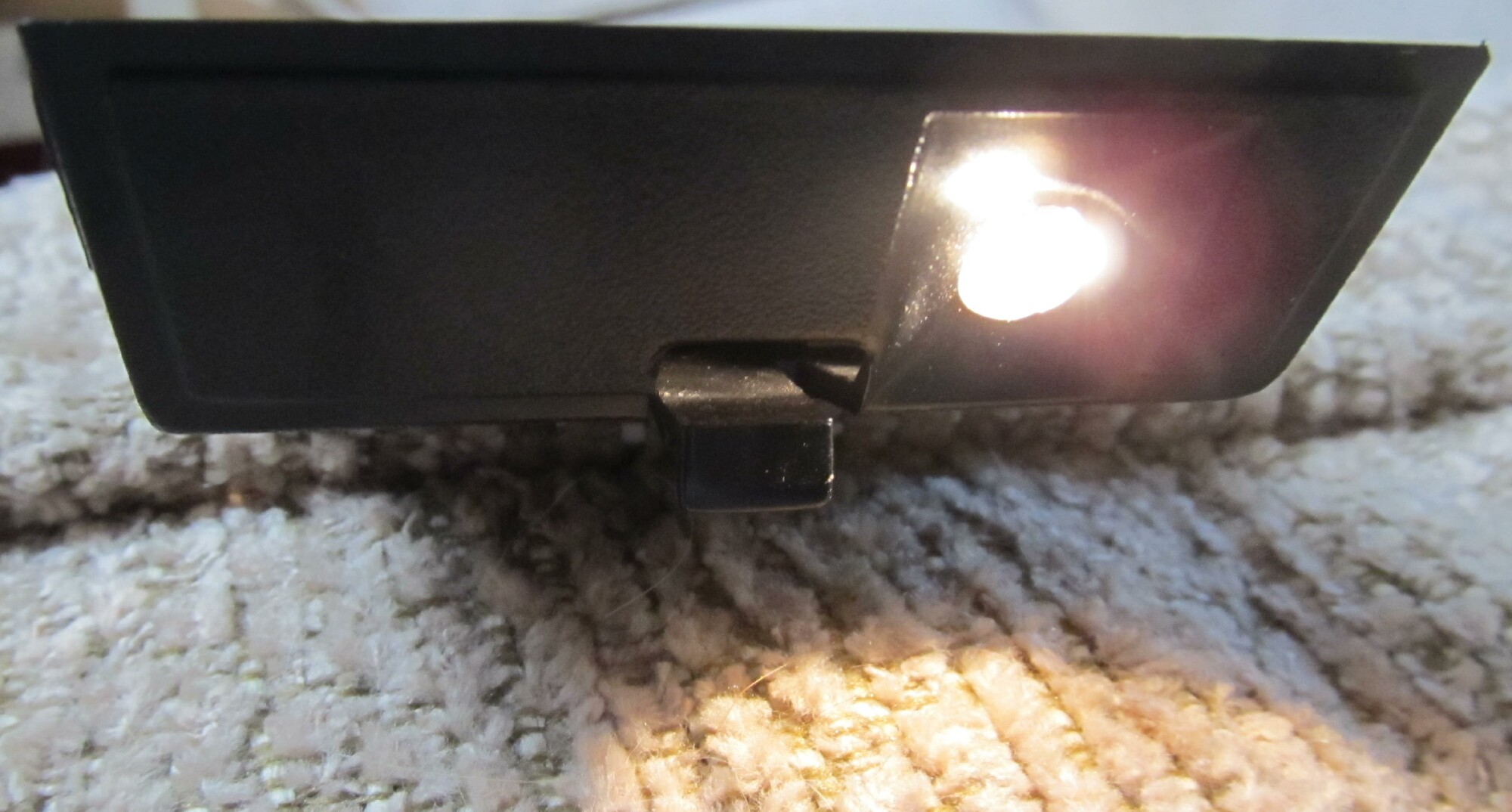

I got my overhead console Firebird flashlight working today.
I took it to Batteries + Bulbs to see if they had a bulb. They did.
Luckily I ran into a fantastic store manager that knew his stuff and was willing to examine it to get it working again for no charge. He took a dremel grinding tool and removed 30 years of gunk from the copper terminals where the batteries connect and in about 10 minutes voila the thing worked like it was 1985 again. . I had no idea they had tools to work on minor electrical stuff in there.
If you need a bulb for your overhead console flashlight (those of you lucky enough to have one in your possession) the part number is MIN10786 from Batteries + Bulbs (formerly Batteries Plus).
http://www.batteriesplus.com/product...-MIN10786.aspx
The 1W bulb is $3.99 + tax. I have to give this store #878 in Orlando, FL and Manager Will props.
So for $4.25 total and 10 minutes I have an authentic working Firebird console light. A stock F body collectors item brought back to life.
