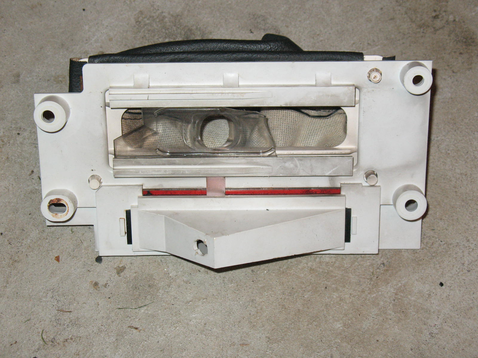

I was fixing my console yesterday, and accidentally broke the shift indicator off. When I was putting the shift cover plate back on, I stupidly didn't get the indicator seated right and it broke off when I put the car in gear. The funny thing is, there's more missing than what I broke off, so I think the reason it broke so easily is that the PO did the same thing, I just finished it off. I googled it and ebay'd it, and all I can find is the entire shift plate for sale, and they aren't cheap. All I need is the little clear plastic thing with the orange tab on it that shows what gear you're in. Junkyards are an option, but finding third gens there is not easy. Anyone know where I could pick one up? Just a shot in the dark, but I thought it couldn't hurt to ask.

Lol....sounds like maybe a PO on your side had issues too. But yeah, under the shift plate cover for an auto trans there are four screws that hold the shifter boot cover to the plate. If you take those off, the bottom of the boot and the shift indicator will be revealed. It's just a little clear plastic piece that has a hole in it that the shift lever goes through when you slide the boot over it, and it slides back and forth in a groove in the plastic base that the boot cover is attached to. The little orange tab that sticks out so you can see what gear you are in is what broke off. It happens if you don't get the indicator seated right when you put the shift plate back on. The worst part about getting the shift plate cover off is that I had to take the radio cradle out too, which entails also loosening the heater/ac controller, as well as the hatch release and defroster buttons and their bezel. It's a pain, but pretty quick work once you've done it a time or two.

I have the underside piece with indicator for your shift plate.Its the whole piece that attaches with 4 bolts
Quote:
Ok. Send me a PM, we can talk...... I have pay pal, can you use that?Originally Posted by my82roc
I have the underside piece with indicator for your shift plate.Its the whole piece that attaches with 4 bolts pics
Quote:
Sent you a PM.....Originally Posted by my82roc
pics Quote:
Thx. Sent another PM with an offer.Originally Posted by my82roc
pics
