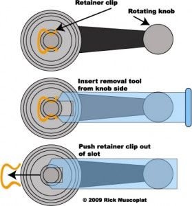

The video did help but that IROC had power windows and mine didn't so I spend an additional 2 hours trying to take off the window crank. Even worse I watched a similar video on how to remove the crank using some spatula type device which didn't work at all.

One of these makes all the difference in the world when removing the window cranks:
Amazon.com: Wilmar W80646 Door/Window Handle Clip Tool: Automotive Amazon.com: Wilmar W80646 Door/Window Handle Clip Tool: Automotive
Most auto parts stores stock a tool like this

Re: Door panel removal with Manual windows
That's what I used. It didn't work.

Originally Posted by AmorgetRS
I am curious, how did it not work?
It wouldn't push the pin holding the crank out. All it did was get stuck and then it bent in half

You have to look in there and see which way the clip is so you can use the tool properly.
And The Retaining Spring Doesn't Have To Be Completely Removed,Just Pushed Back Enough To Disengage It From The Spindle,The Spring Will Remain On The Door Handle.
