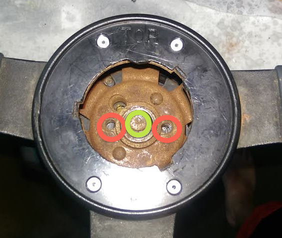

I think they are trying to point you in the right direction. The nut, if it was there, has already been removed. Time for the puller:
Thread a bolt into the threaded holes at 3 and 9 o'clock (red). The wheel puller threaded rod will push against the end of the column, at center (green). Wheel should come off. Depends on rust, or how much effort the PO spent to cram it on. Try a longer lever on the wheel puller.

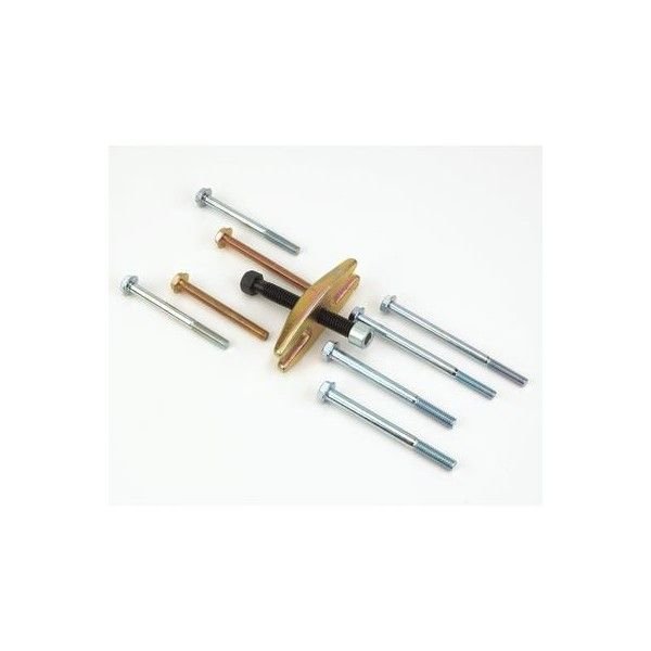

thanks for the replies guys i do appreciate it. I dont have the steering wheel puller that was pictured above. ill attach a pic of the one i have. in the pic ull see the two pieces that replace what would be the outer bolts on the puller. those are what i had to bend to fit into the cavity to thread on to the wheel. i guess ill just try some penetrating oil and try a bit more muscle. i was just scared i would break something

You could use this nice inexpensive wheel puller,it's a nice addition to the tool box
http://www.harborfreight.com/automot...set-69889.html
The pic in your post above is a depressor tool for the wheel plate.

The tool in #9 is for AFTER the wheel has been removed. That pushes the lock ring down, to remove the snap ring, then the locking ring (locks the wheel in place when key is removed) comes off, providing access to the turn signal and key cylinder.
The tool in #9 PULLS against the center column shaft to compress the spring behind the lock ring.
To get the wheel off you are PULLING the wheel through the two bolts of the tool screwed into in it. The center threaded rod of the tool then PUSHES against the center column shaft to PULL the wheel off of it.

The tool in your pic is to remove the snap ring and other fiddly bits holding the clockspring (on airbag equipped vehicles) and the turn signal cam and springs for tilt if equipped for tilt. If that's the tool you are using it is doing the exact opposite of a wheel puller and pushing the wheel on tighter.
