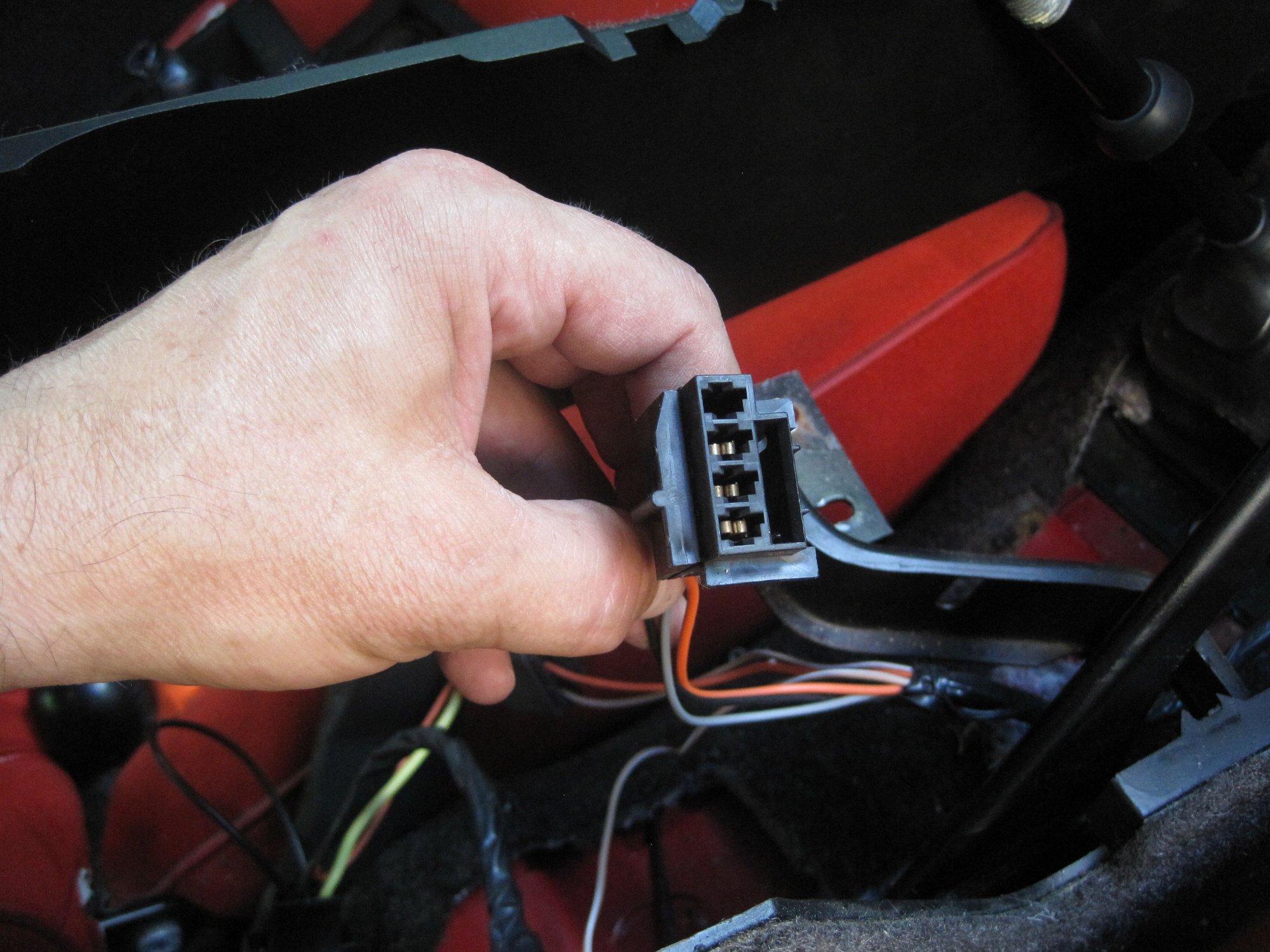

Took the shifter plate off to replace my rear hatch switch and hopefully fix my reverse lights but stumbled upon this unplugged wire. Ideas?

https://i.imgur.com/iTHLo2H.jpg
I tried using the built in thing, does this work?

82 Z28 Anyone recognize this unplugged wire? (Under shifter plate)-ithlo2h.jpg
There you go.
Not 100% sure off hand, but I bet someone knows it easily.

Don't know specific wire colors or anything, but I know on auto trans cars the reverse light wire goes to a switch that is on the shifter and there is also some sort of wiring to cut out the hatch from opening when not in park or neutral

I have the same unused plug and wires in my '84 manual transmission, no power seat, no power windows, no console clock, but does have rear hatch release.
I posted a year ago asking the same, but do not recall the answer.

I saw an image am the other day of my car's hatch/window switches and it had a compass/gauge looking thing between them and the center console is it possible that's for that?
My car's a manual turned automatic

I believe thats for the center console clock.Most early harnesses have it, regardless.

That is the connector for a console clock.All 82-85 camaros have the connector weather you had the clock or not

My 83 Firebird T5 has that plug too. You sure it's for a clock? Thought it was something for automatics.

Yep, clock harness.
Black wire= ground
Orange wire= constant 12v
Gray wire= 12v for backlighting (when park/headlights are on)
