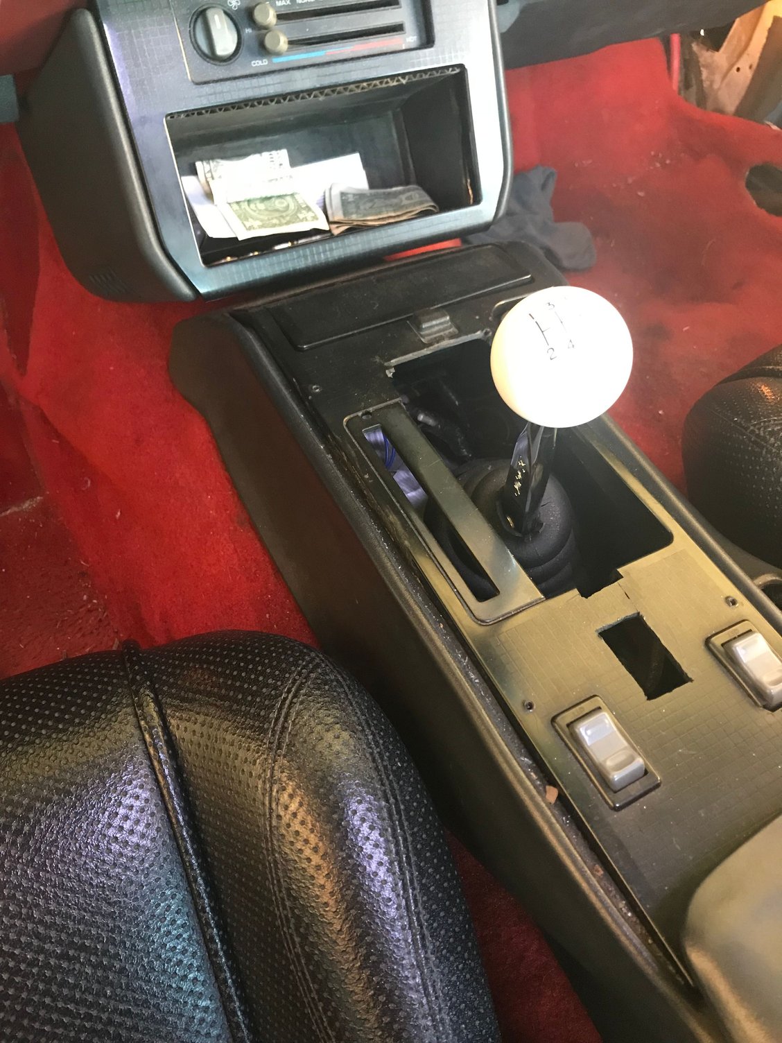

The one I have to cut out for the power window switches. Thought about moving the switches and putting a cup holder in it.
This is mine now. I hate the hole someone cut for fog lights or something. It was from a u pull 15 Year’s ago.

For future reference, what you are referring to is the shifter plate not a console lid.

I bought the manual shift plate from Hawkes. Nice piece. You have to cut your own window switch and mirror switch holes but there are location guides on the back. Don't use a dremel tool to cut them completely because it will melt the plastic and you will get a sloppy oversized hole. Drill around the cut outs first than connect the drill holes with the dremel.

Thanks for the advice on cutting the holes. I’ll be doing it with this blank auto plate since it’s not really worth anything. I’ll come up with a shift boot to cover the middle, need spend in other places badly.
