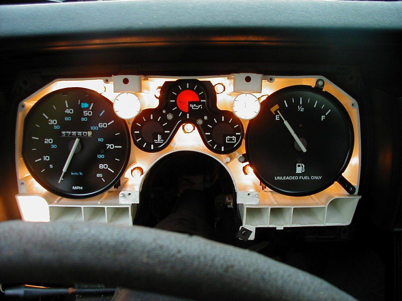

So I just bought this 1985 base model camaro and I noticed it has the 85mph cluster. I’ve yet to swap my motor into the vehicle and I was wondering how do these gauges compare to the iroc gauges that I have In my donor car.
not my image, just the same cluster.

The IROC should have actual guages vs the idiot lights of the shown cluster.

If your donor care is an 86 or "newer" than it's cluster is not a DIRECT plug and play installation for the 85. The gauge clusters' printed circuit - and dash wiring - changed a little in 86. The 86 cluster WILL plug in and most of it will work fine..... but there will be a wiring conflict to the cluster back-lighting and to the BRAKE warning indicator.
