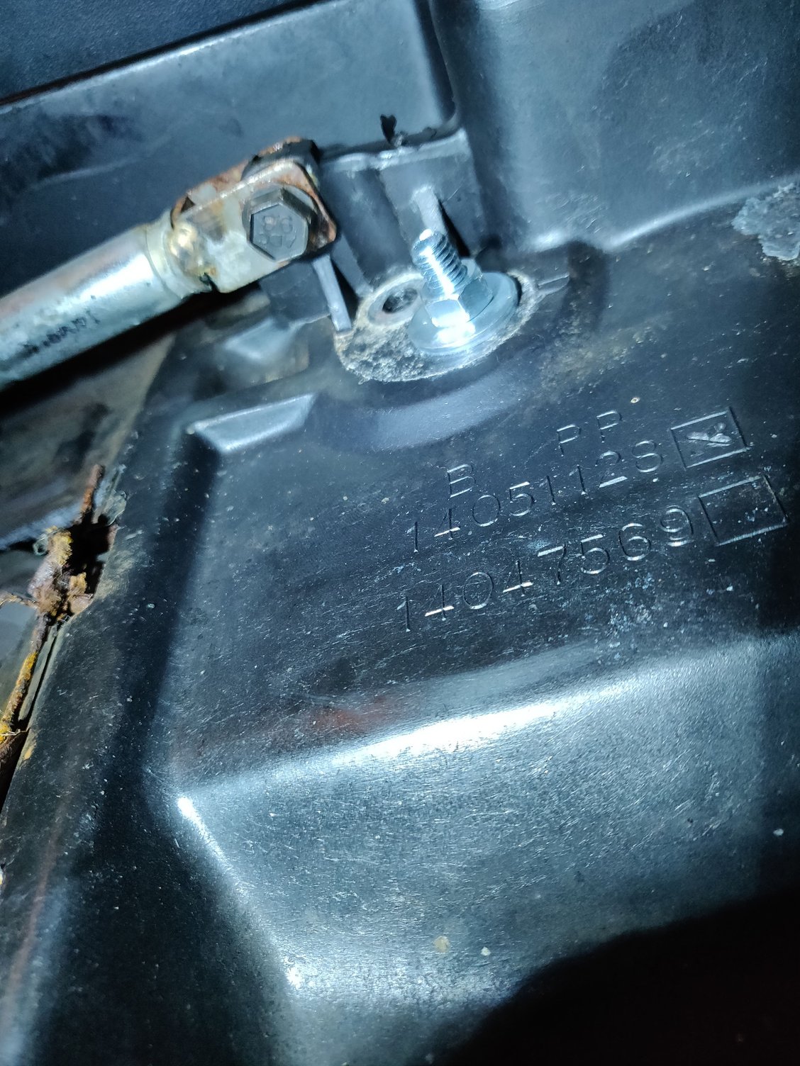

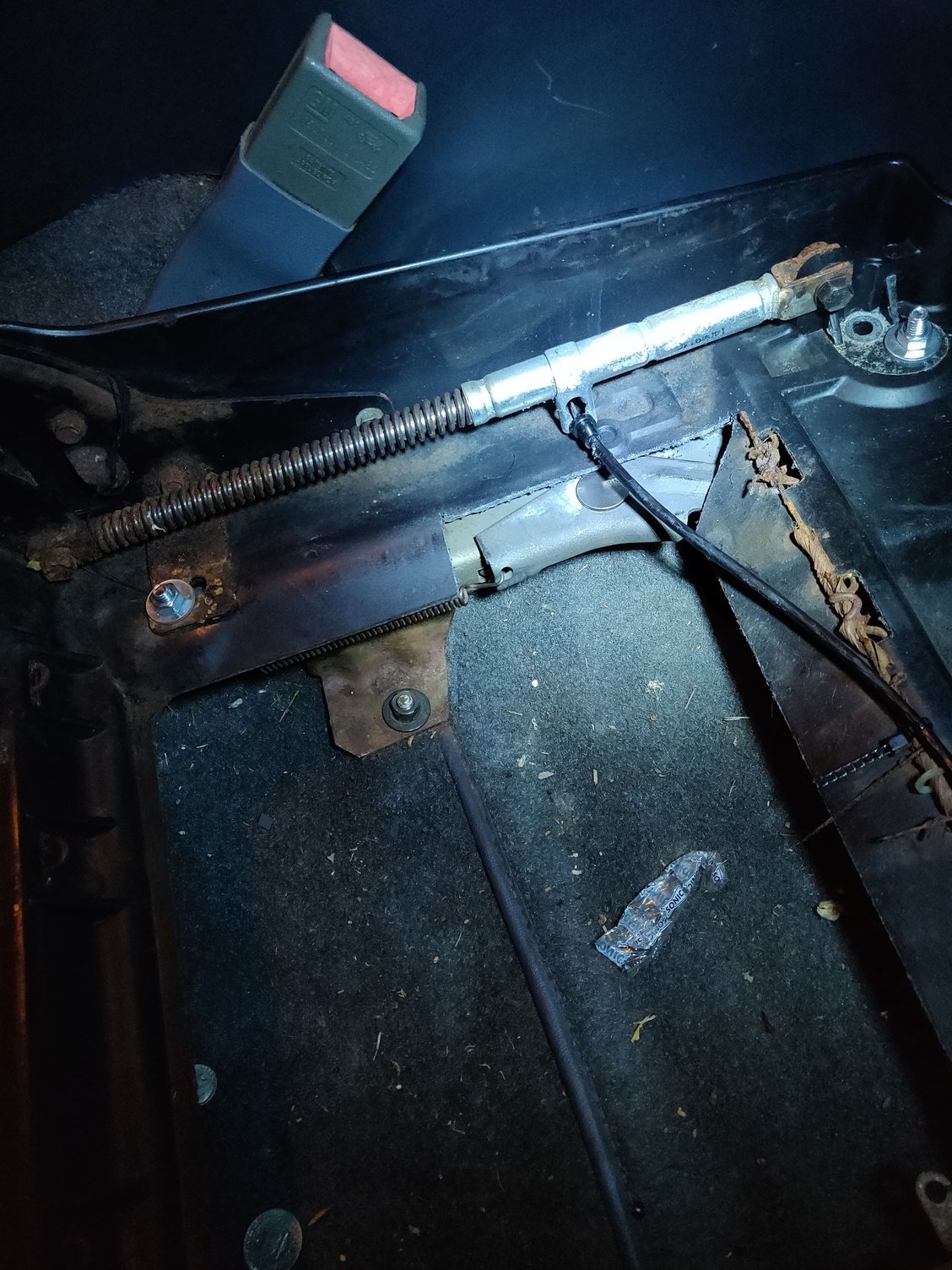

I've seen a few threads that say they take a little fab work to make fit but I hate how vague that is so I decided to try myself when I found a pair on Facebook for $40. So far I have only got the passenger side partially done but in the car. Still need a lot of finalizing and cleaning up but I hope this will clear up what needs to be done for future people searching. Pictures show where the seat bottoms need to be trimmed to clear the arms for the sliders as well as the amount of spacer needed to sit in the car at a reasonable angle. Hopefully I can get the driver side knocked out in the morning and take some better pictures
