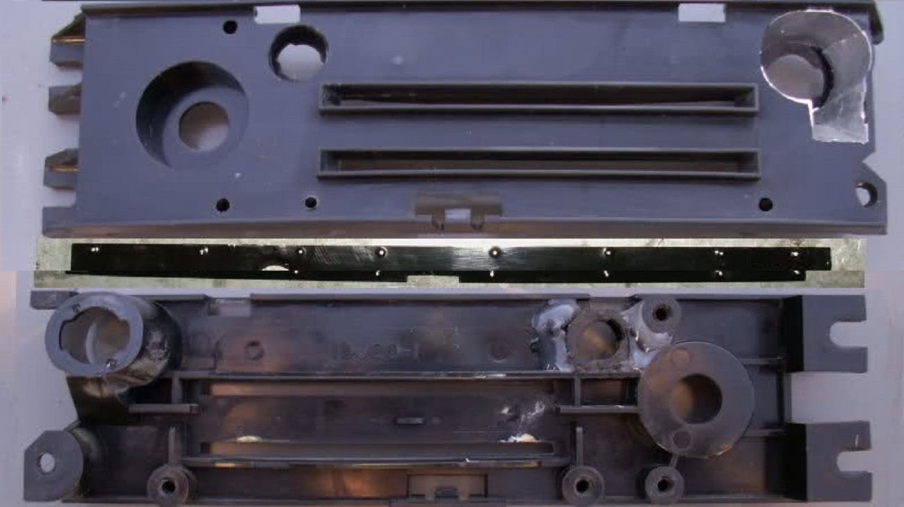

I drilled a hole and hot glued the socket from a t/a Hvac to the camaros.
Looks like this.

Much better illumination!
