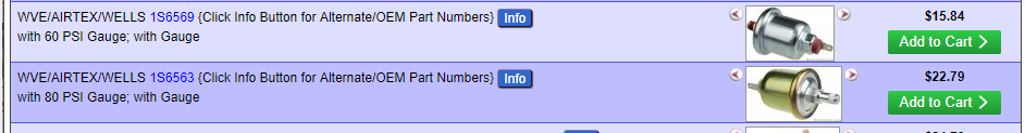

Looking at rock auto they list two

Re: Oil Pressure Gauge...
On the later clusters V6 motors have a 80 lb gauge and the V8s have the 60 lb one
