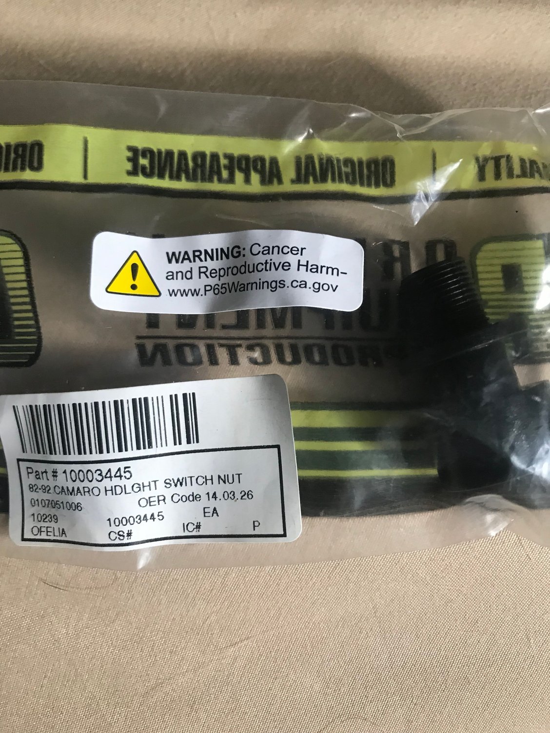

There is a plastic "nut" that is round and it threads into the HS and holds it in the plastic dash panel behind the face plate. Those are prone to breakage and will not hold the switch in place when you try to push the rod in. Sometimes it is hard to tell it is broke as it looks like part of the dash. If that is your case you can get one from Classic Industries.
