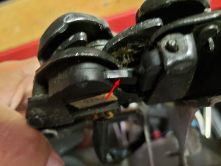

I just recently R&R'ed my hatch pull down to clean and re-lube the motor and gear box. Hopefully someone with more knowledge will show up.
You definitely need to fix the hatch pull down because I don't think it's good practice to be slamming it down.
Parasitic draw; you should first make sure the battery is capable of holding a charge and that the charging system is able to do its thing. Then look for the potential parasitic draw.
If it is the release or hatch pull down (the motor with the latch in the retracted position doesn't see power) the attachments might help. Sorry the schematics aren't in color like they are in the FSM.
On the latch, there's a small tab that activates a switch that powers the motor that raises/lowers the pull down.
Do the release and hatch electrical checks before removing the pull down to get at the motor.
