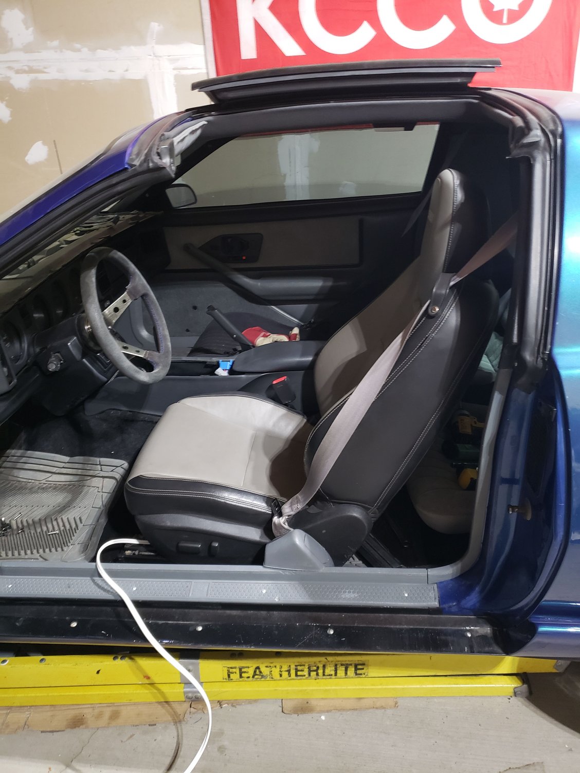

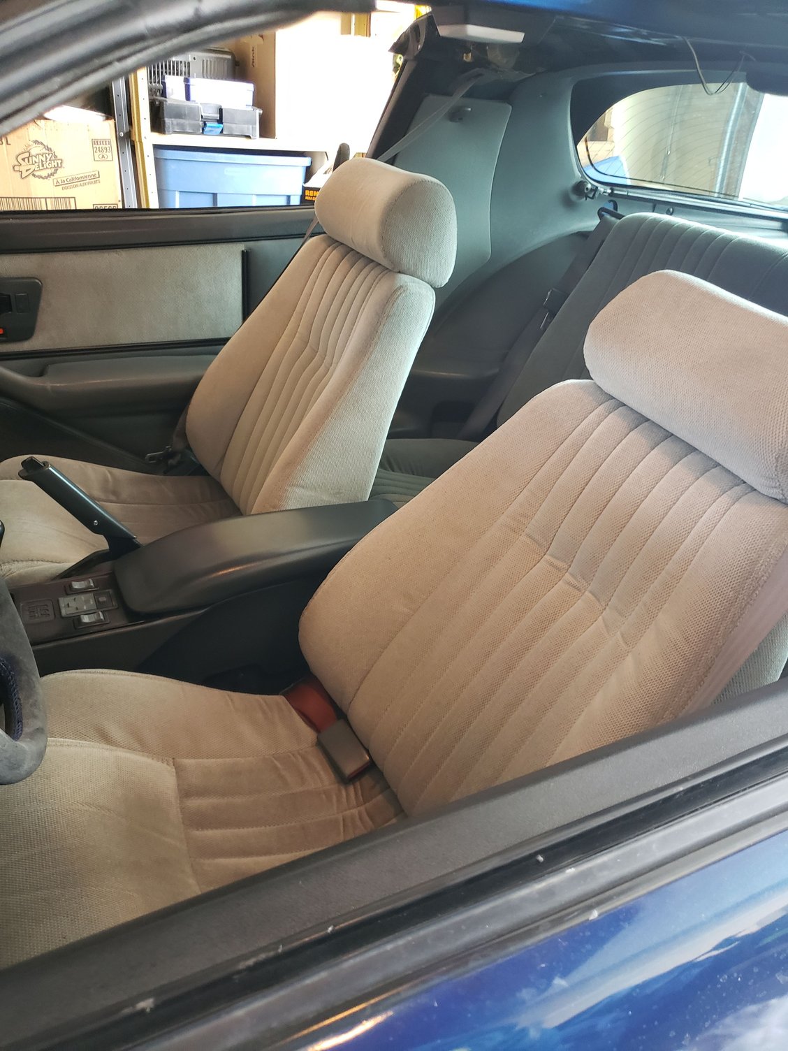

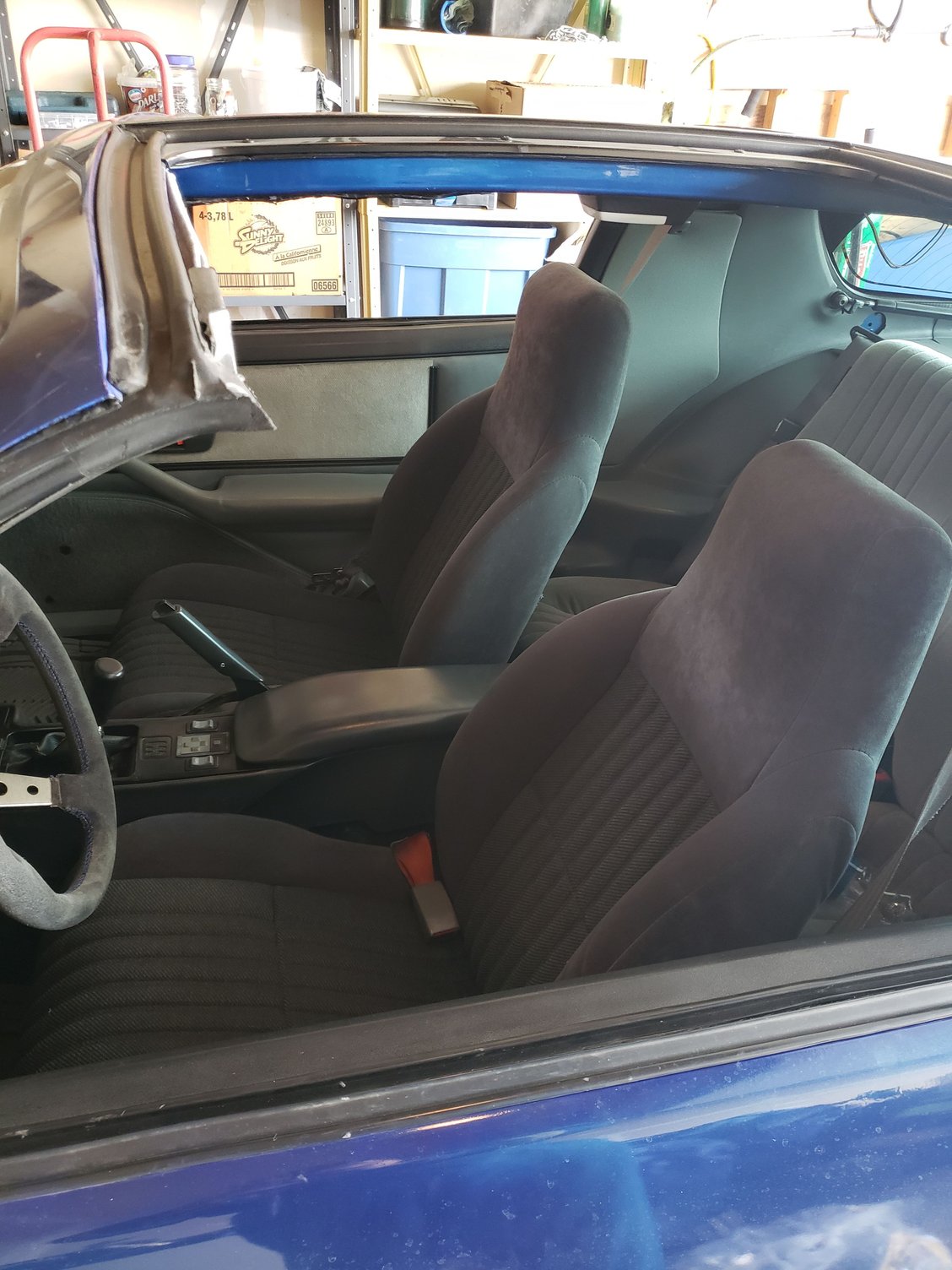

when i bought my car last year the seats were done, see the light colored ones in the pics below. Then i found some 93 cavalier seats that were in great shape (Dark Grey in pics), all i did was swap the seat tracks. It is an exact swap.
Then i found a killer deal on some 8 way powered heated seats from a 2010 SS and couldn't pass them up. There was some modifications required to the SS seat brackets but i managed to get them in. i only have the driver side in so far, but I am 6' tall and have the seats almost all the way bottomed out, but there is still some adjustability for sure.

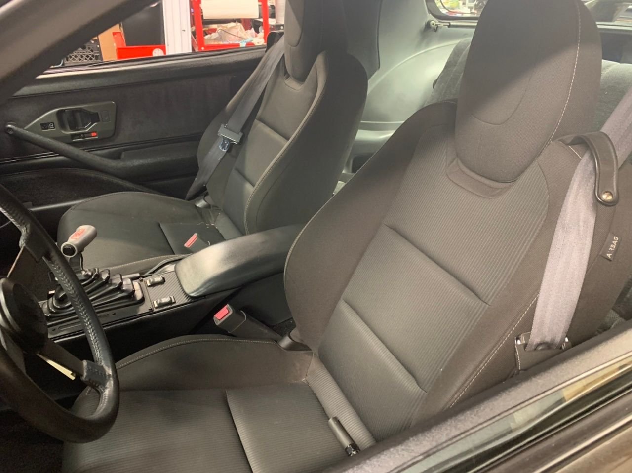

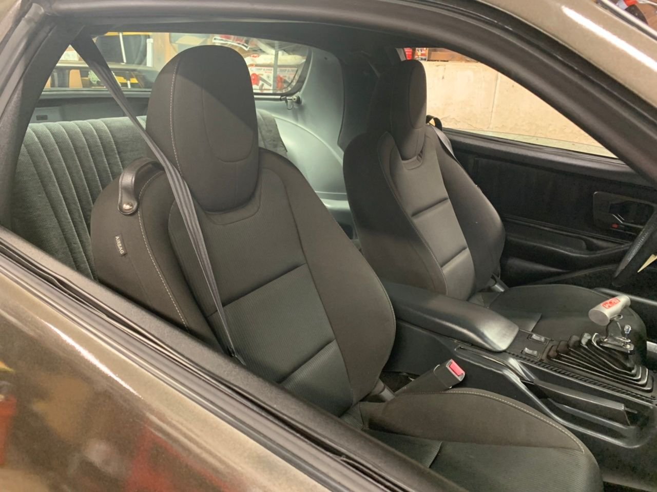

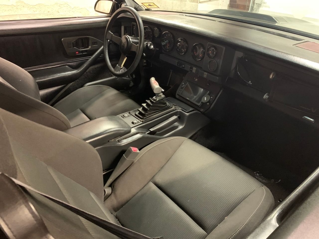

I also did the 5th gen seats in the summer of 2018 and they are a huge upgrade. They aren’t a bolt in and require some fab work to put some brackets together but I had 3rd gen original seats and then went to summit 5pt seats and picked up some 4th gen seats and before even putting them
in I found a good deal on these powered 5th gems in black cloth and snatched them up. Had them fit and powered in a weekend. The cars ride is so much better now. I still have the 4th gens sitting on a shelf.
They do sit taller but I’m 6’1” and I don’t have a problem with headroom. I think the look better than the 4th gens which look like clam shells to be and the 5th gens headsupport us perfect for me. Easy to put your head back and just cruise.

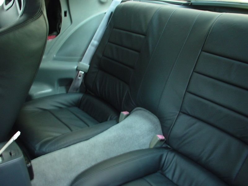

I hate logos, so the only way to arrive at that was to order leather. I asked if they had any "blemished" ones, so I got a discount on the passenger seat. I cannot even tell where the blemish is even though they told me where it was. I also ordered extra hide to re-do the back seats, console lid, door panel inserts - anything to help tie it all in together and flow well, rather than a cut and paste look of the seats. If you go fabric, you could still do the same.
