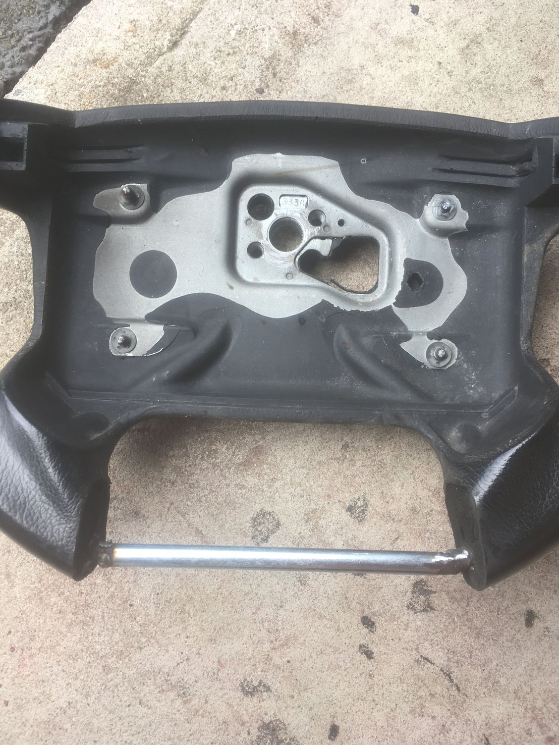

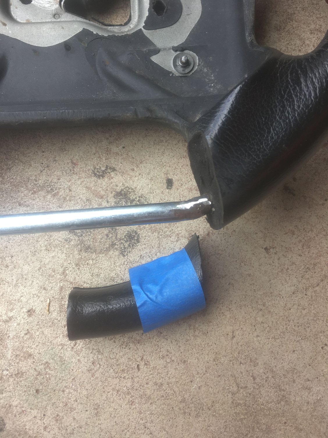

Re: Custom 1990-1992 Camaro Flat Bottom Wheel
Here it is so far. I cut the foam off of the bottom in 4 pieces so I can re cut it later and glue it back on, after I cut the curved metal ring off the bottom and weld in a straight metal bar

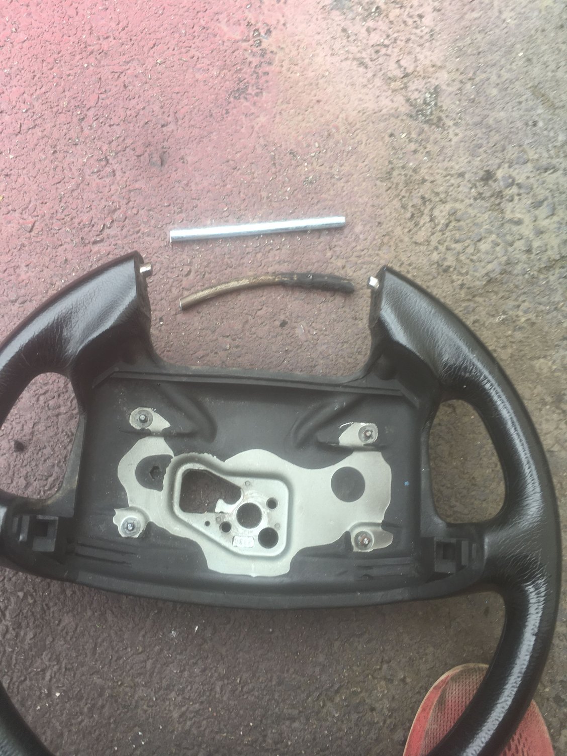

Welded my new flat piece on the bottom today. Grinded the edges down to a 45 degree angle so I could have a channel to weld into. I'm not gonna reuse the foam pieces I had cut off, they are just too curved even after trimming them. Ordered some vinyl yesterday, gonna have to order a foam cylinder with a similar density as well. More updates to come once my vinyl shows up
