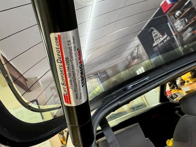

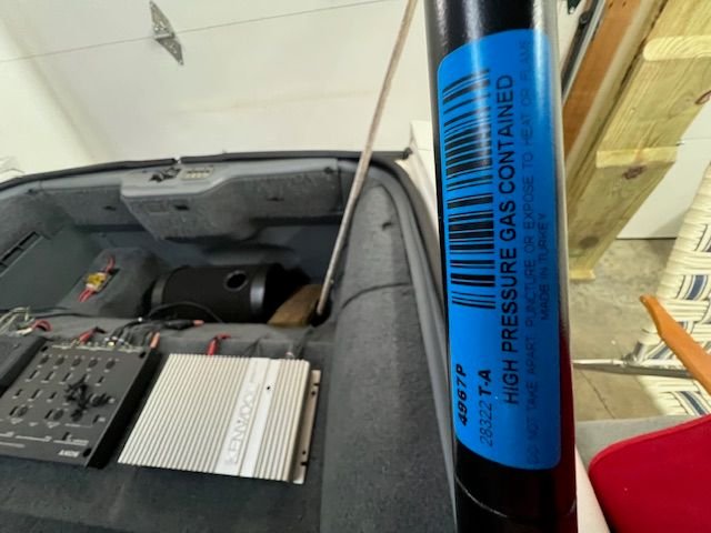

FYI, Strong Arm 4697's come in different "sub" model #"s. Ordered a set off fleabay and recieved 2 different struts.
4967P 28322 T-A is a more powerful version of the strut
4967P 29722 T-A is a less powerful version of the strut.
Needed the weaker ones as the ones I order from Amazonia shoots my hatch to the roof like a rockship.
