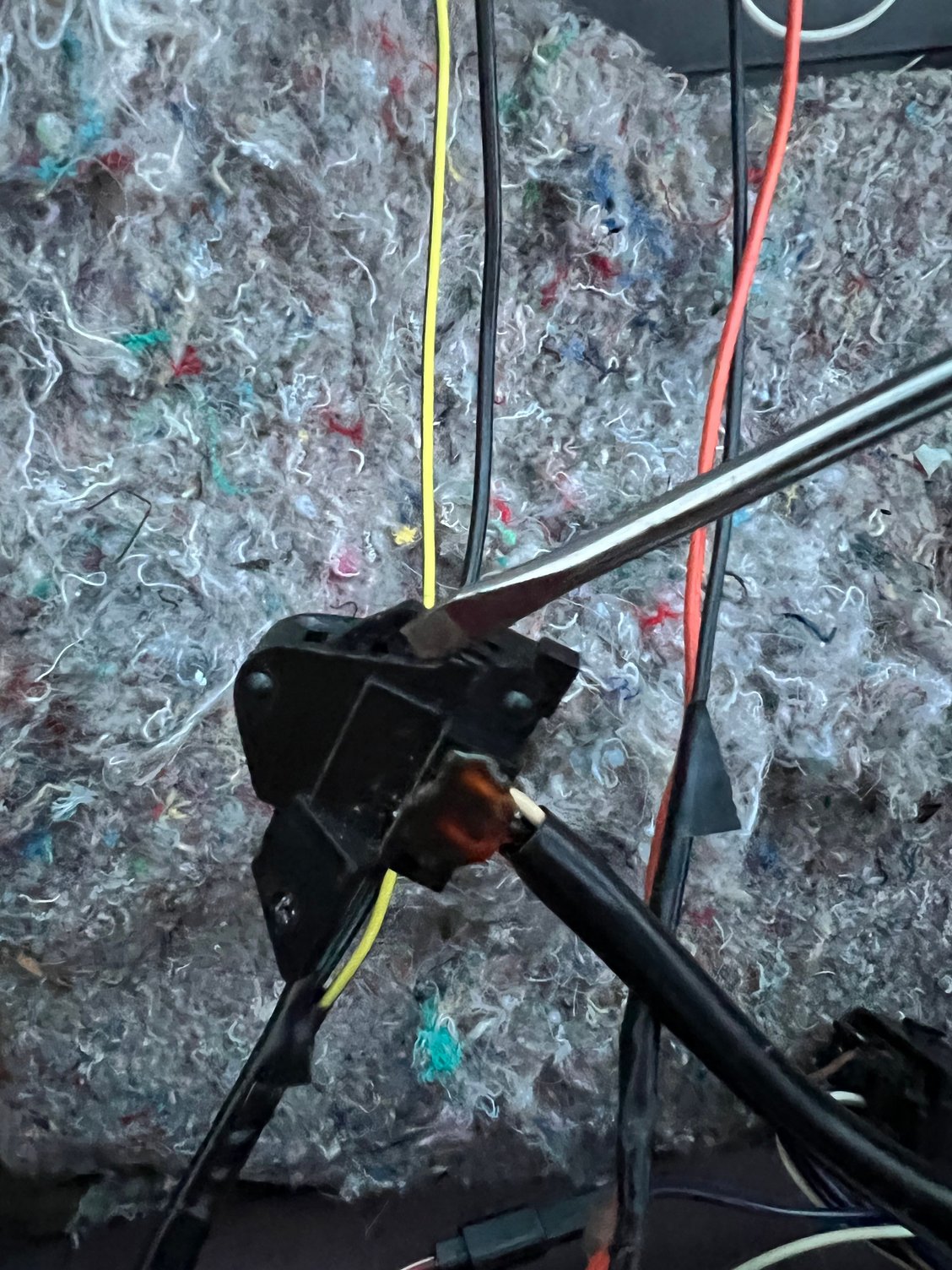

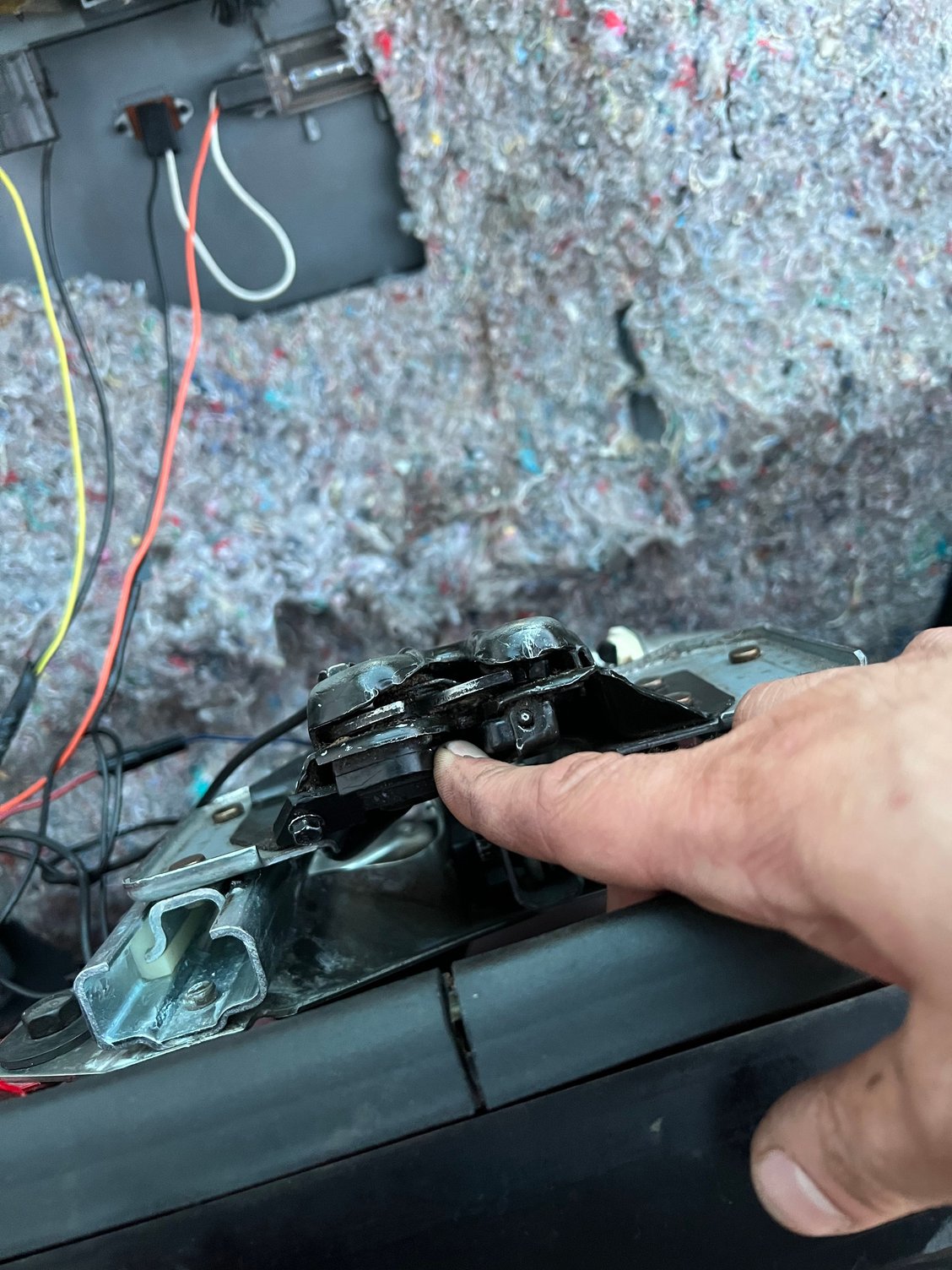

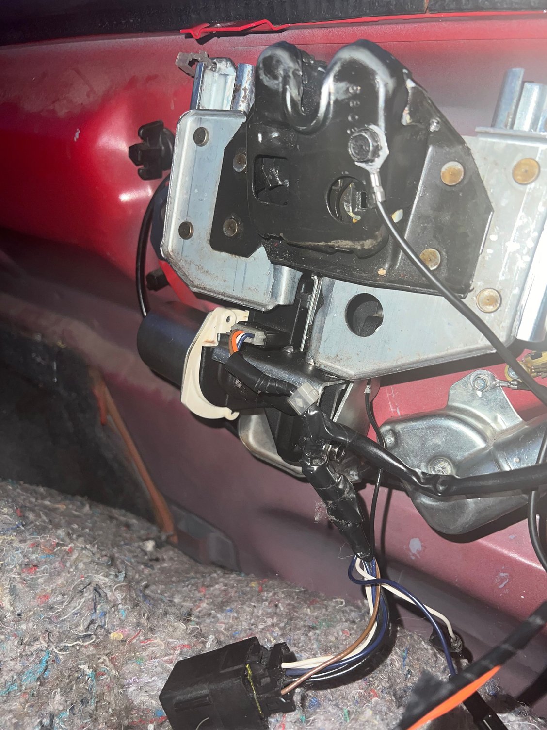

Hello everyone, I just rebuilt my trunk motor with a new plastic gear, slide inserts, and new black plastic Dorman mounting housing. Before I assembled everything I verified the motor worked by connecting 12 volts to the motor contacts. I measured 12v volts at (blue,orange,brown) of the 4 pin harness connecting into the black switch that plugs into the motor.
Also I tried pressing in the switch that is mounted on the latch hook to try and cycle the motor like I did in the past. It seems that the switch won’t push as if it’s stuck solid, I recall a soft like spring motion of the switch that retracts. Here are some pics, I would greatly appreciate some help!!

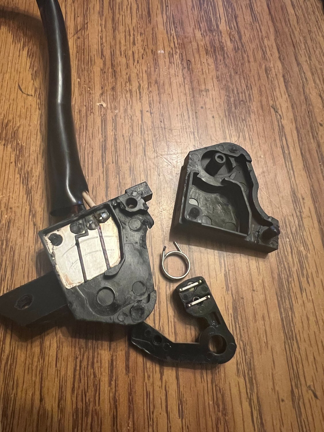

Ok, I went back and pierced the switch wires with a needle and jumper wire and got the motor to work. Like I said before the striker switch feels very stiff. I just broke down and gutted apart the switch to see the wiper terminals have any corrosion here are some pics the spring is very tiny and I’m guessing it is getting stuck between the 3 copper pads . I am in the junkyard now looking for another switch to compare. Any other gm cars that could use this switch
