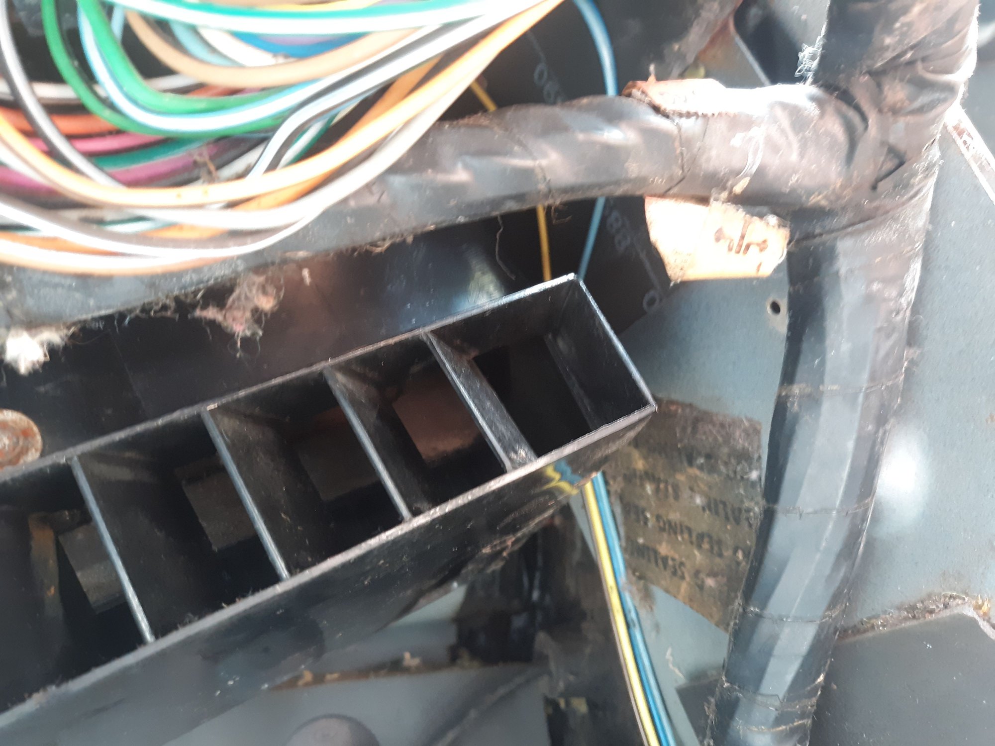

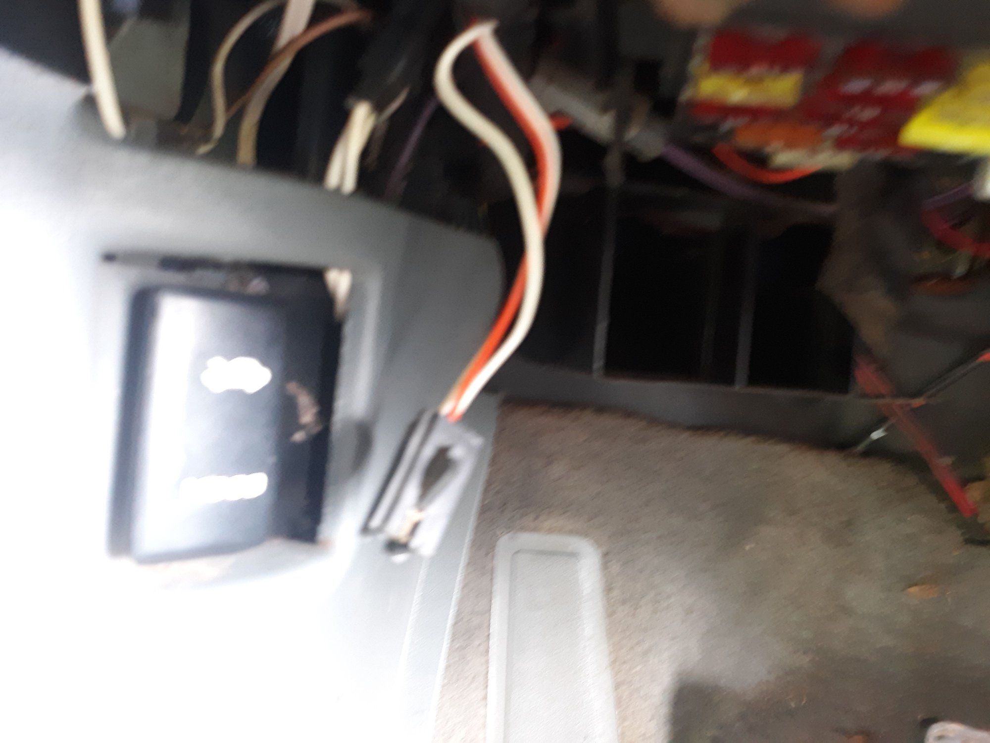

My drivers side has a courtesy light on the floor, but the passenger doesn't. Why?
Drivers side
Passenger side

Because that's the connector for the harness, not the connector for a bulb. The harness would split off (Y) and have a socket on both sides of the car for bulbs. Cars that didn't have the lights don't have the Y harness.
