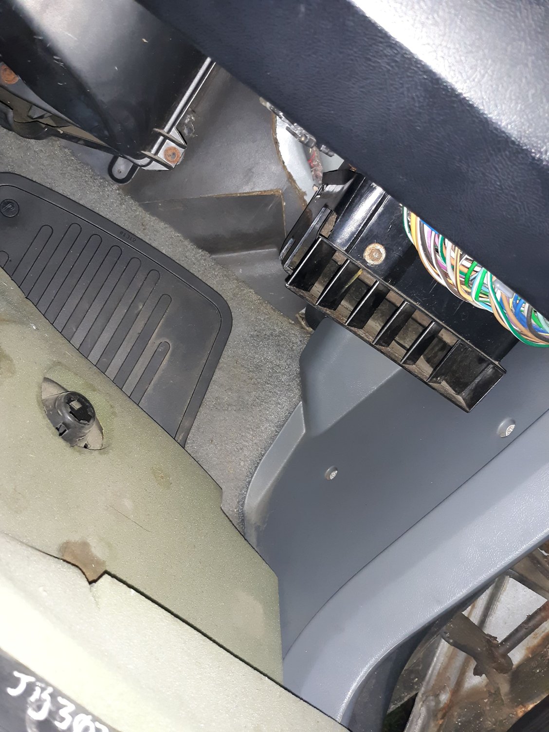

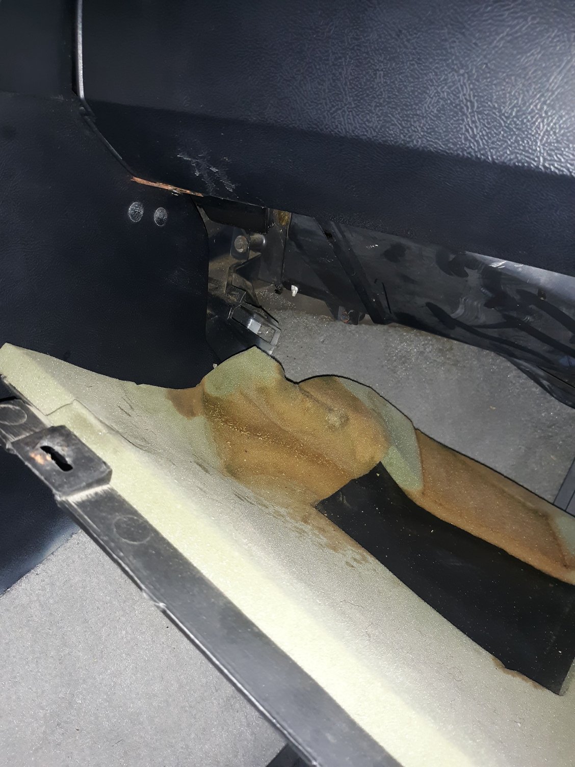

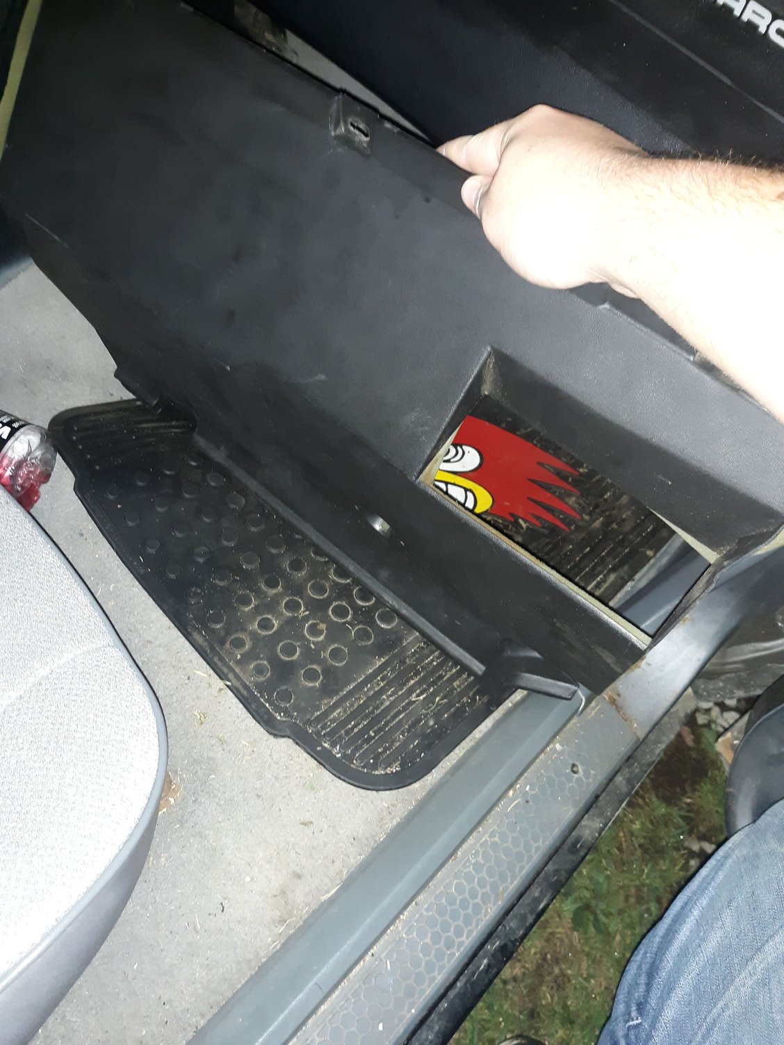

So I ordered this panel for the underside of the dash, was just wondering if it's the right part for what I need and if anything hooks onto the floor heat vent?
Like how does that vent fit with the panel, does it go inside outside?

Wow, you must have a non-ac car. Took me a minute to figure it out.
Panel looks to be correct, vent stays exposed. See here for a photo (scroll halfway down):
https://www.thirdgen.org/forums/inte...re-non-ac.html

the vent slides through the opening in the hush panel. there's maybe 3 screws on the front of the hush panel that attach to the dash. the right side of the hush panel has kind of a groove that sits on top of the lower kick panel. it's been awhile, but there might be a longer screw in the HVAC box that the rear of the hush panel goes over. the back of the hush panel kind of lays on top of that long screw. i have the same setup in my car but my interior is currently not installed otherwise i'd take pics for you.
